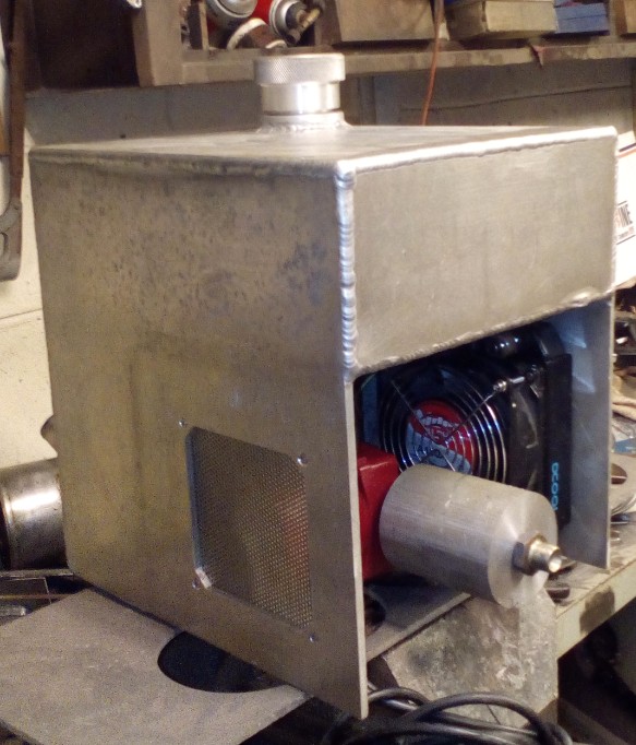

That picture richard has posted is my cooler. That's got two lots of quick connects, 3mm pipe between the dinse and the cooler, radiator and two dampers, I think it's safe to say you're pump isn't up to the job.
Thanks, looks like I will have to start my search for decent pump then. Oh well not cost me anything but time so far and can easily machine an adapter to fit into the 1.5"BSP outlet I have in the tank, just a bit of a shame I will more than likely have to extend it as it was going to be quite a nice compact unit, 300 x 300 x 250. I haven't made the front panel/base section where the couplings and switches will go so at least I haven't wasted time on it
