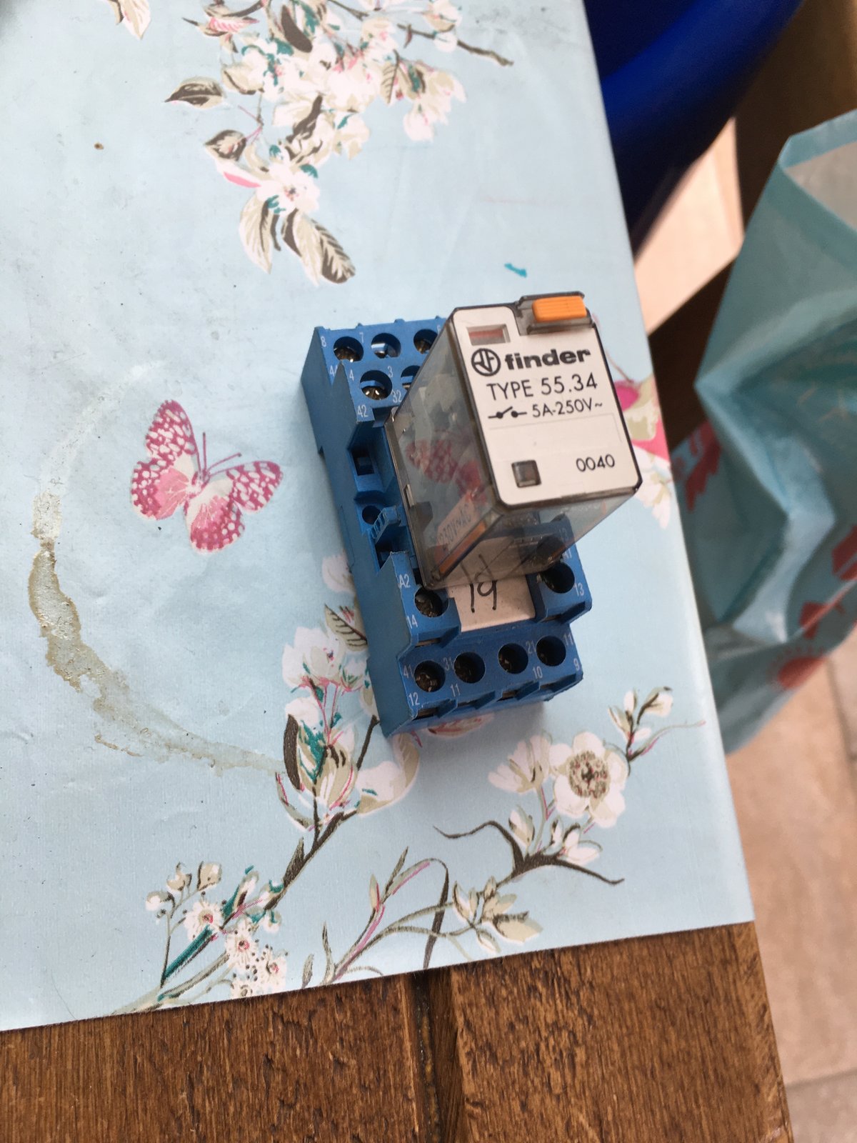

I've went with Daleyd's offer of a relay, which I'll wire into the cooler.
