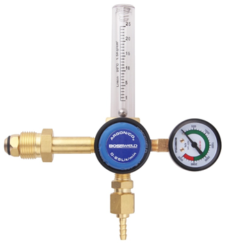

Recently, I have come across a variation of the uncompensated flowmeter-regulator that uses a dual stage regulator to compensate for the supply pressure effect, but it has a calibration pressure printed of the Thorpe Tube housing.
Bossweld hybrid flowmeter-regulator
Thorpe Tube calibrated at 1.5 kg/cm2 (about 20 psi or 150 kPa)
This implies that the Thorpe Tube is under pressure so it must be placed between the high pressure and the low-pressure regulators. This remains an uncompensated flowmeter-regulator but it is not sensitive to supply pressure effect and generates little surge because of the low output pressure of the second regulator. The advantage gained by pressurising the flowmeter seems minimal - it will remove inaccuracies caused by backpressure but these would be quite small with typical backpressures of about 4 psig.
I am yet to did-assemble and test one of these to verify my conclusion.
