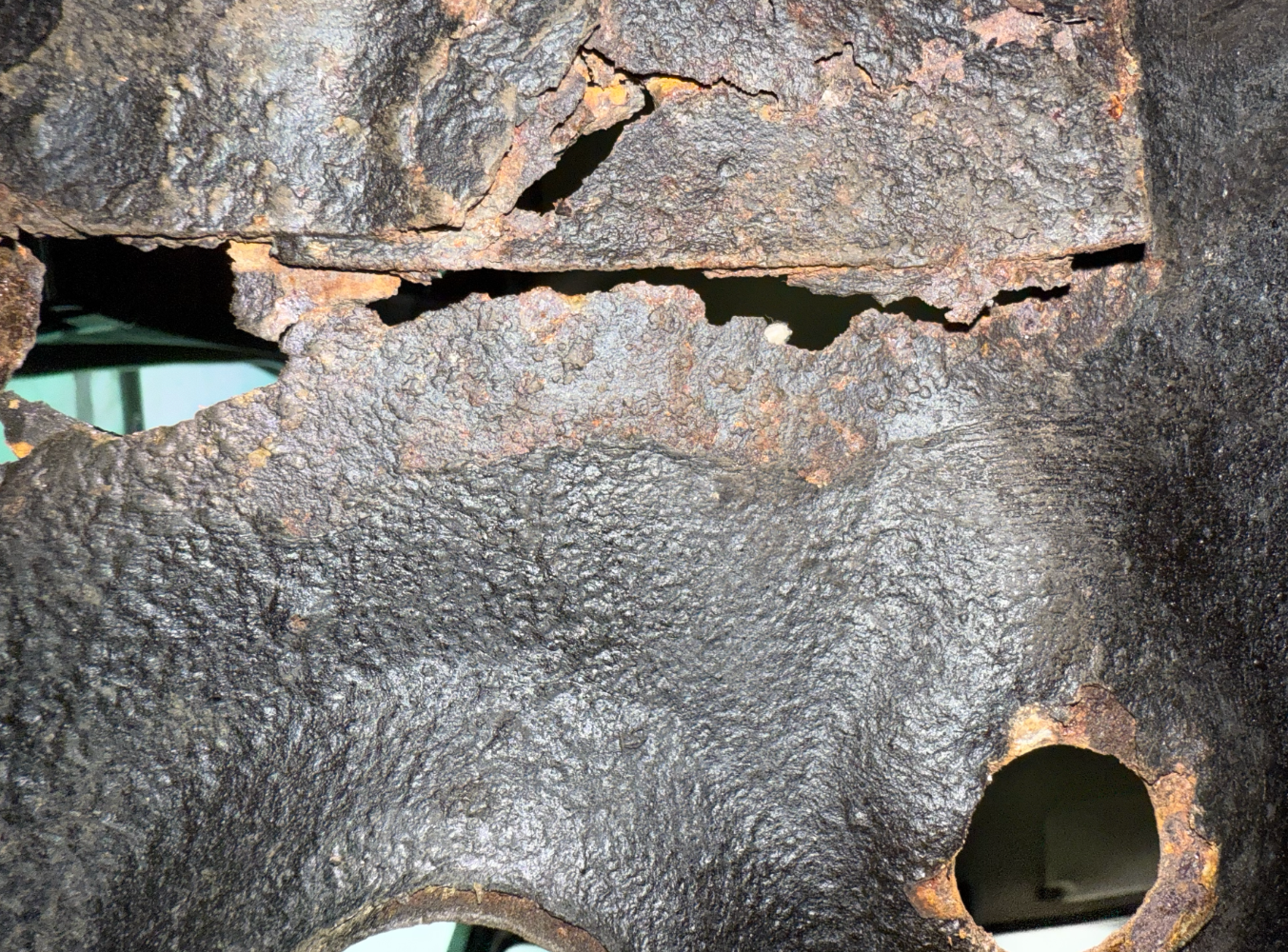

My floor pan quarters came from Magnum (+ somebody else?). They were a good starting point but took a lot of fettling before I could use them.
The curved lip around the edges wasn't quite right and the indents in the floor didn't match the indents on my chassis rails
I've been told many repair panels (floors & sills) are made to cover the rusted originals to get an mot pass, they are not made as direct replacements for factory panels.
Some suppliers offer "repair" panels (like mine) others offer "historical restoration" panels that are supposed to be identical to the factory originals. Quality & price will vary.
