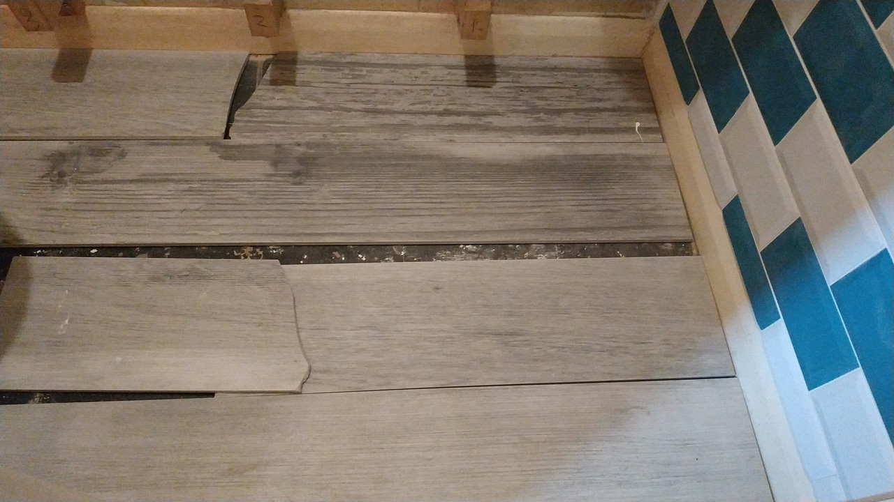

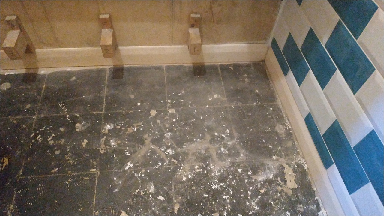

Starting floor tiling today, could use advice best way to do it.
Floor is concrete covered in bitumen, with the old lino and vinyl tiles removed
Bought a 20kg bag of leveling cement (Mapei, from b&q). I am assuming I dont need to remove the bitumen?
When our kitchen was done, they used a latex floor leveler, but not seen that for sale anywhere.
Floor tiles are 1.2 x 0.2m each, if that matters.
This room is under 2m², but will also be doing the hall after, about 16m² as a rough guess.
Roughly layed out
