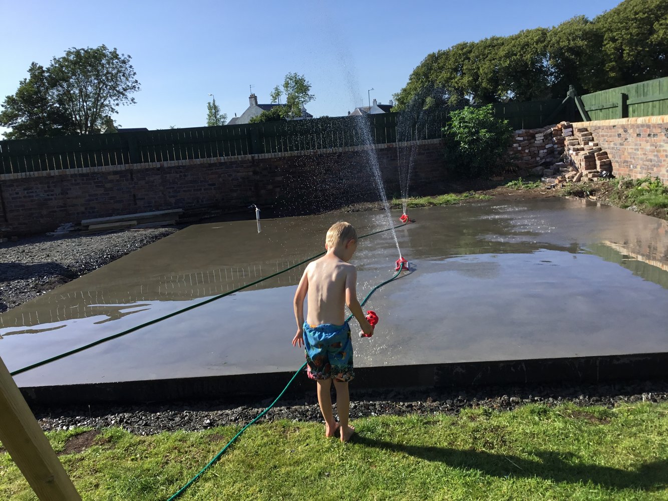

Get a company to supply the concrete, pour it and float it, it didn’t cost me much more to get it floated, I’d done all of the groundwork’s which is the expensive part of a slab, it’s floated almost as soon as it’s poured, within a couple of hours.I have decided to replace the flagged area where the Clarke garage is going with a proper concrete pad. It will be 7.5m x 4m so a larger pad than normal for me to do. biggest i hav edone is 5mx3m and that was shard but i didnt need it smooth. Well as smooth as i want it this time, I am thinking C35 will do it.

Now what would be the best way to smooth it out ?

Can I give you some advice, and by the way I’m not in the building trade but this is just from my experience of building a wooden workshop on a concrete pad, get a couple of course of brick on the slab and build the garage on that.And its just a Clarke garage anyway and ill just raise the frame a few inch on timber, ist just to stop any water from rain getting under ifi it can.
This problem can be solved by having your cladding 100mm past the top of the slab.Can I give you some advice, and by the way I’m not in the building trade but this is just from my experience of building a wooden workshop on a concrete pad, get a couple of course of brick on the slab and build the garage on that.

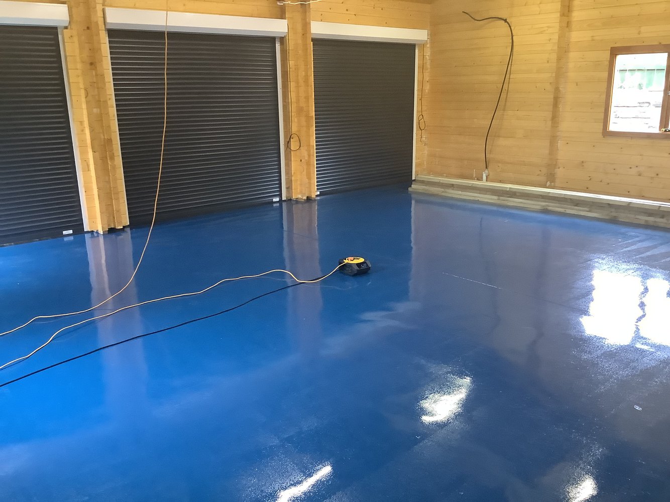

Despite all of my attempts I have been unable to stop moisture coming through into my workshop.
My pad is larger than the workshop, and moisture comes through under the wooden bearers which are sitting on a membrane barrier , you want the bearers above the pad in my experience.
Or have the wooden bearers slightly wider than the concrete pad so that water drips off and doesn’t pool and come through.
I wish I’d known that earlier and I’d have done it differently
I know you’re not building a wooden garage but if you’re building it on wooden bearers you may have the same problem as I have.
