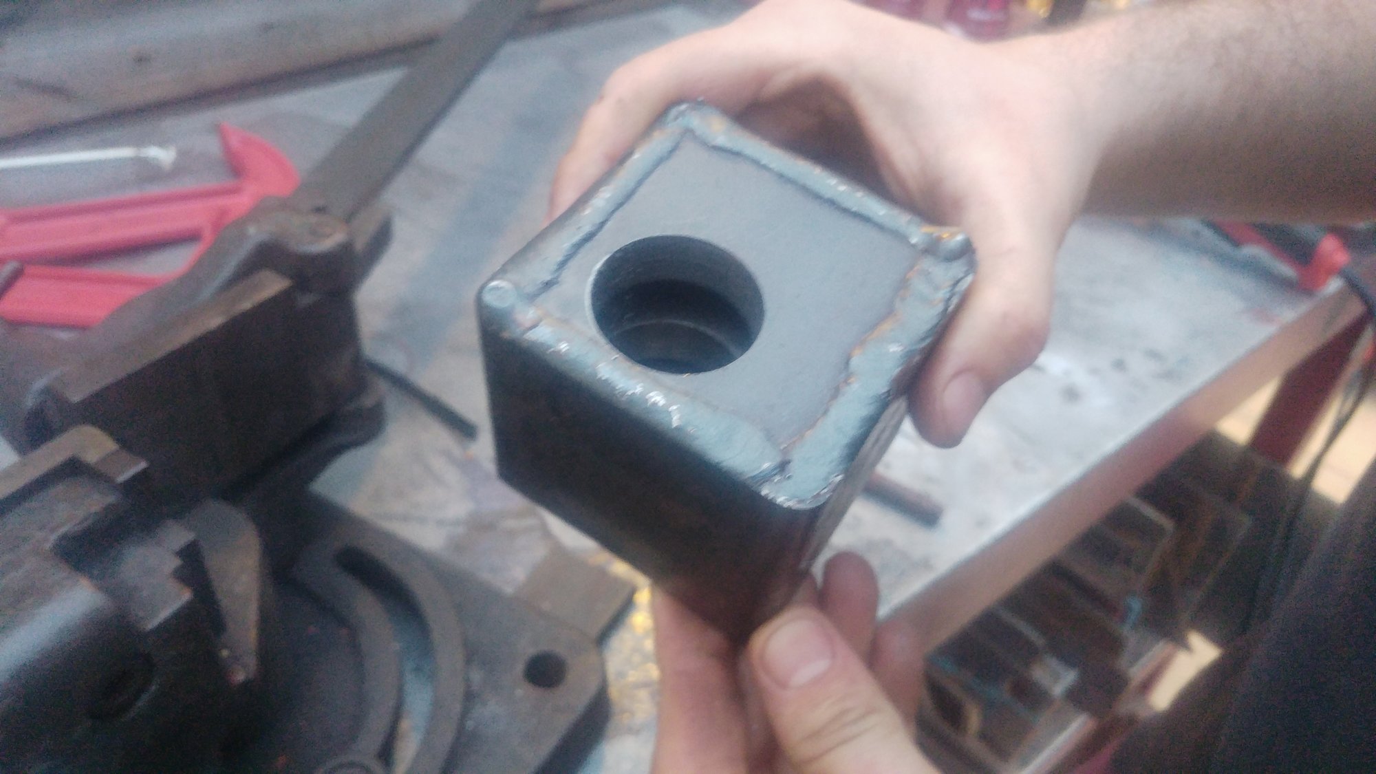

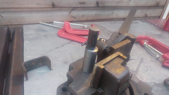

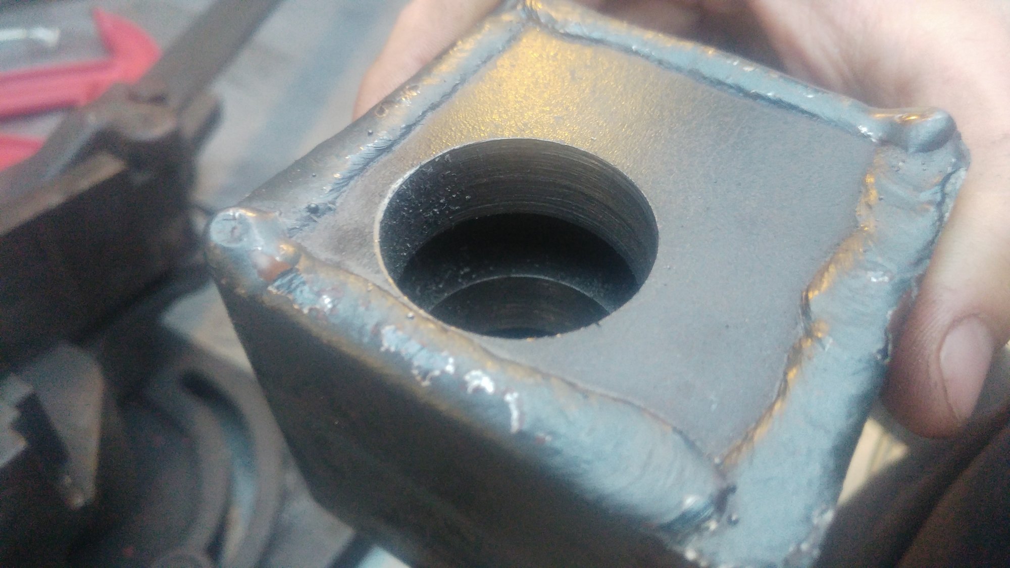

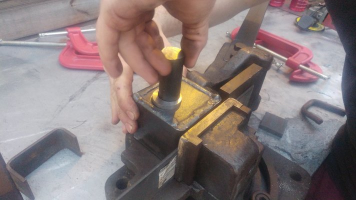

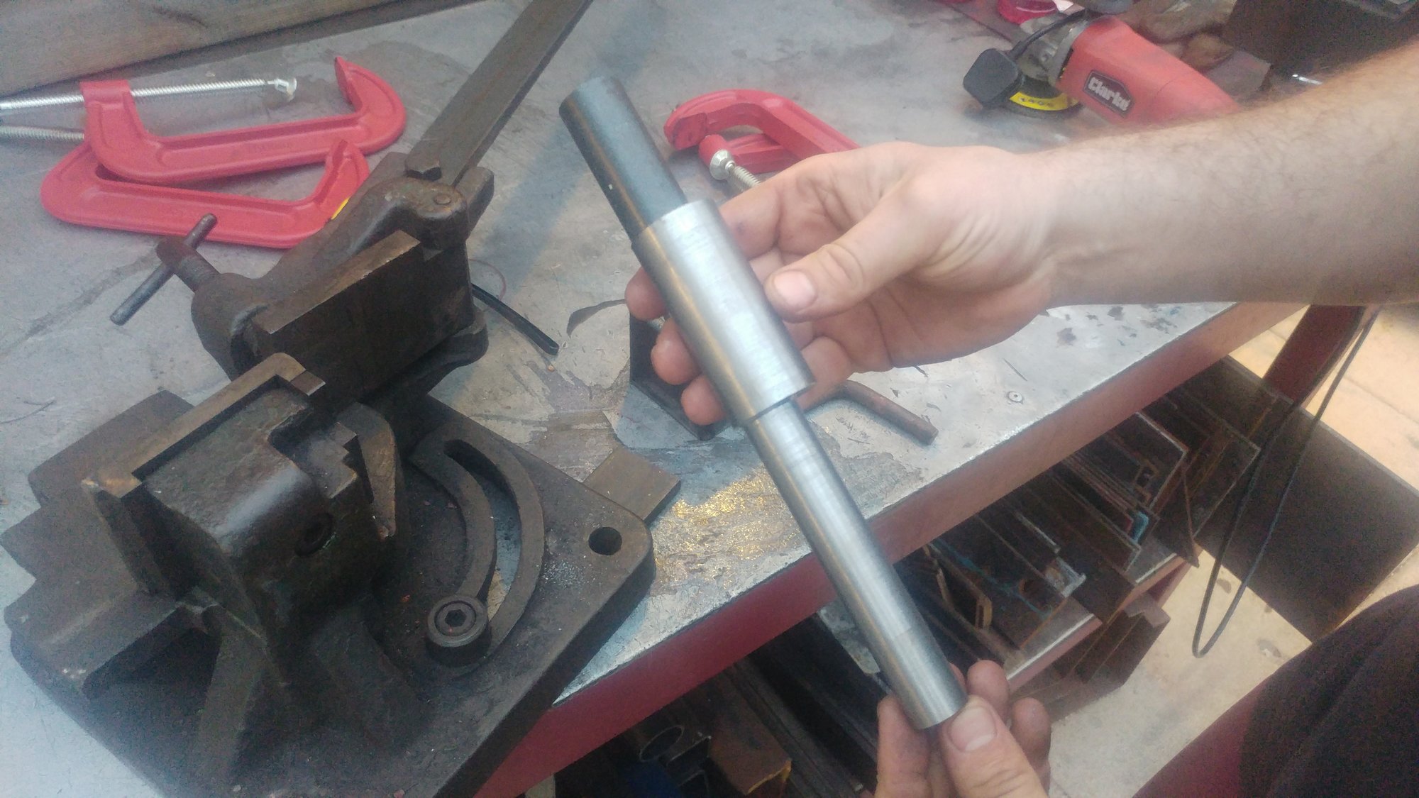

I had a go today at making the part and i think I have cracked it just need to make a handle and weld it but the block and pin appear to work greatHummm. You could turn the bush in the three jaw, then drill the eccentric hole for the post in a drill press? The block could be held in a three jaw with bits tacked on to put the hole off-set. It doesnt have to be very accurate. Or tack it to a round plate, but off centre and hold the round plate in the jaws.
