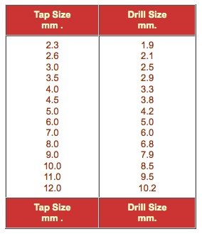

thanks was thinking that might be a way to go you wouldnt no what size drill bit i need??? should write them down really or you no were can get a chart from???
its just got match one that is on other side.
