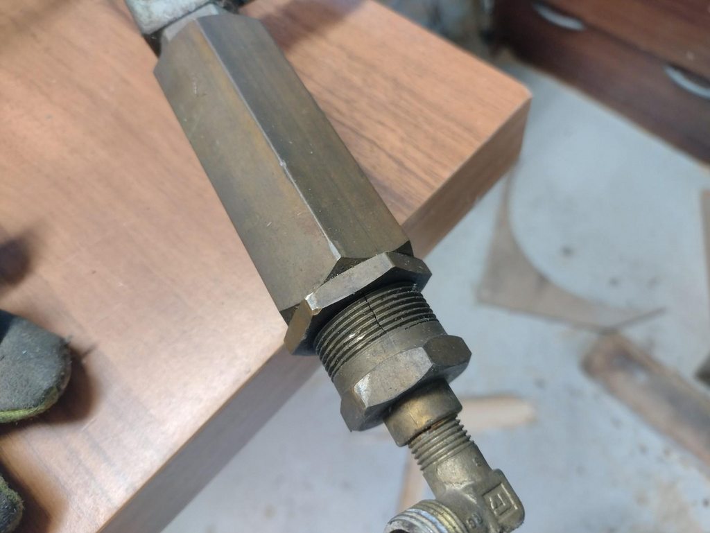

I don't believe the return valve on this pump is at all adjustable however
Someone offered me a stump of 32mm brass hex rod if I wanted to attempt to rebuild the cracked part, which I could well try. It's not a complicated part.
that looks like an interpump. i have one . you can get all the pumps hoses unloaders and valves from dual pumps ltd https://www.dualpumps.co.uk/online-orderingThat's more decent prices than what I found the local sites for unloader valves (150-250€).

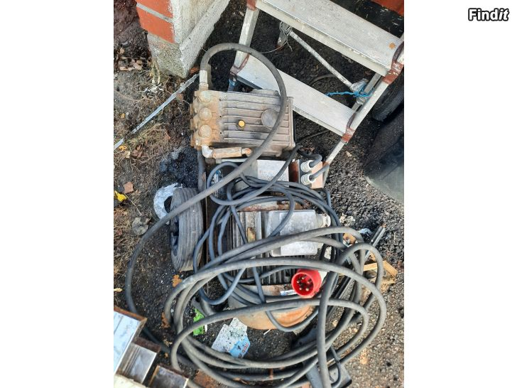

I was thinking of picking up yet another broken pressure washer I found, again for 40 euros. For spare parts and the unloader valve. But it's a bit far away, don't feel like going 100km one way to get it.
You want bronze really, rather than brass.
a lot of the high pressure fittings are bronze and some are stamped saying soWhy, all of the commercial unloader valves are either of brass or stainless steel construction.
