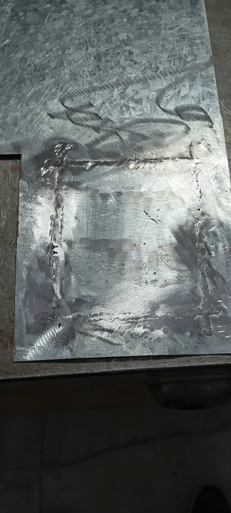

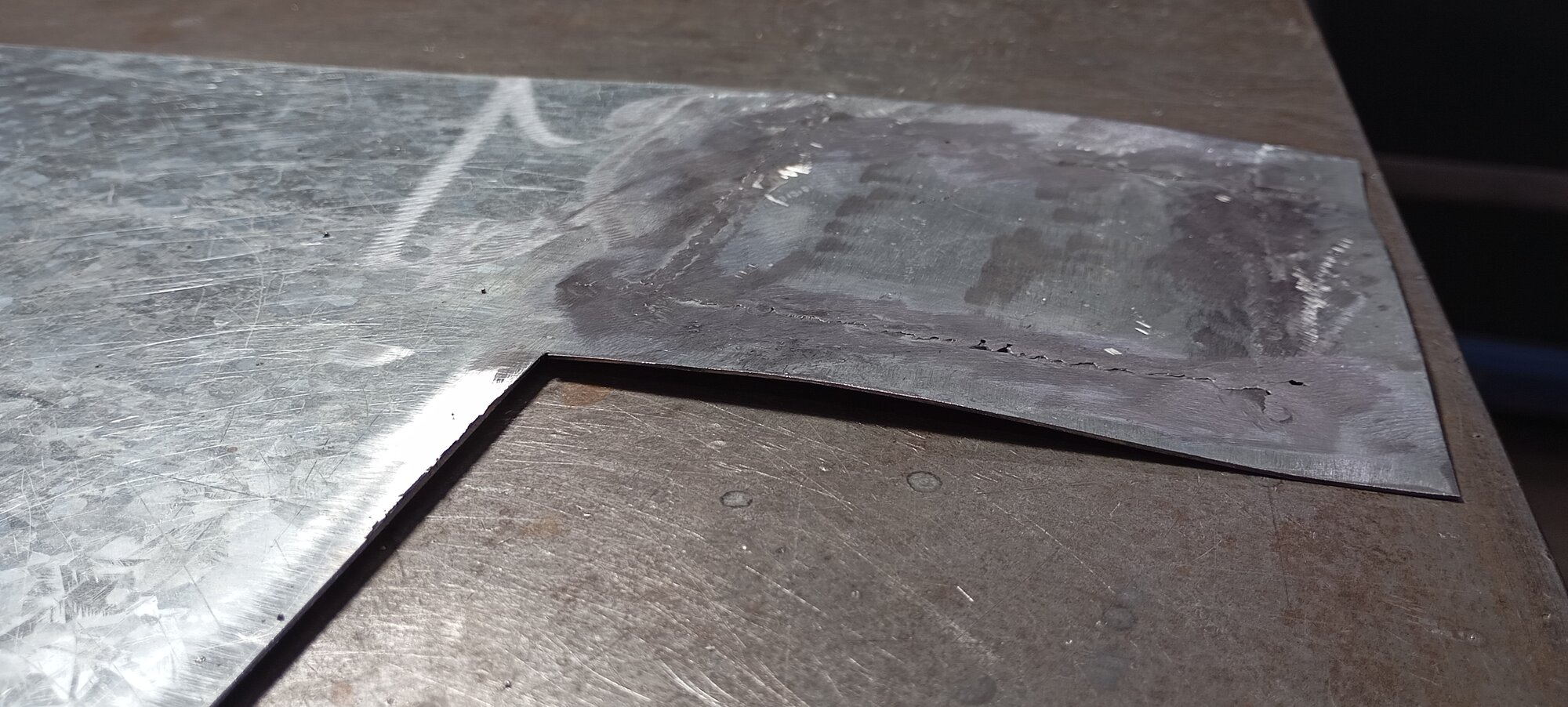

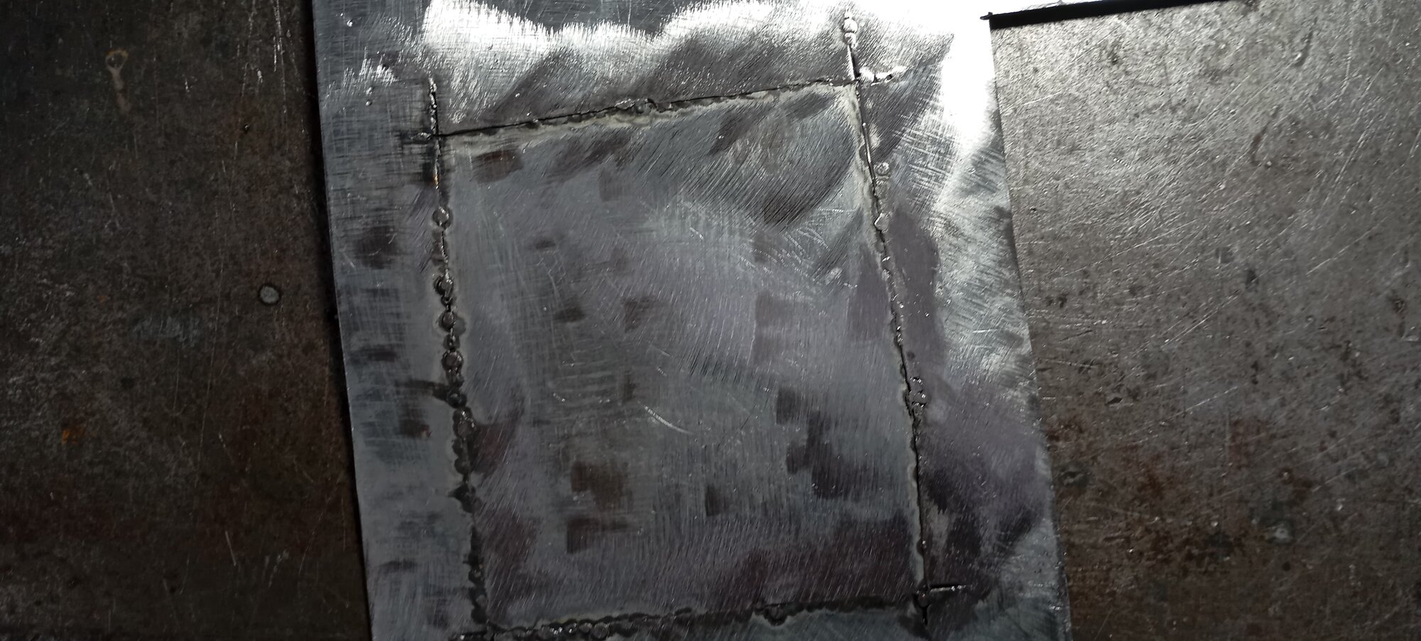

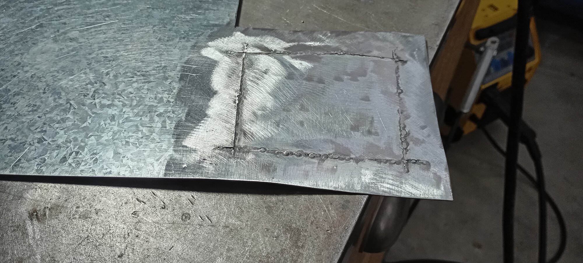

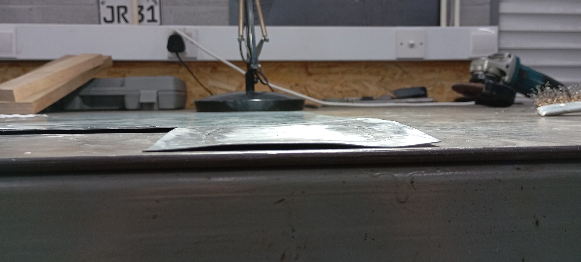

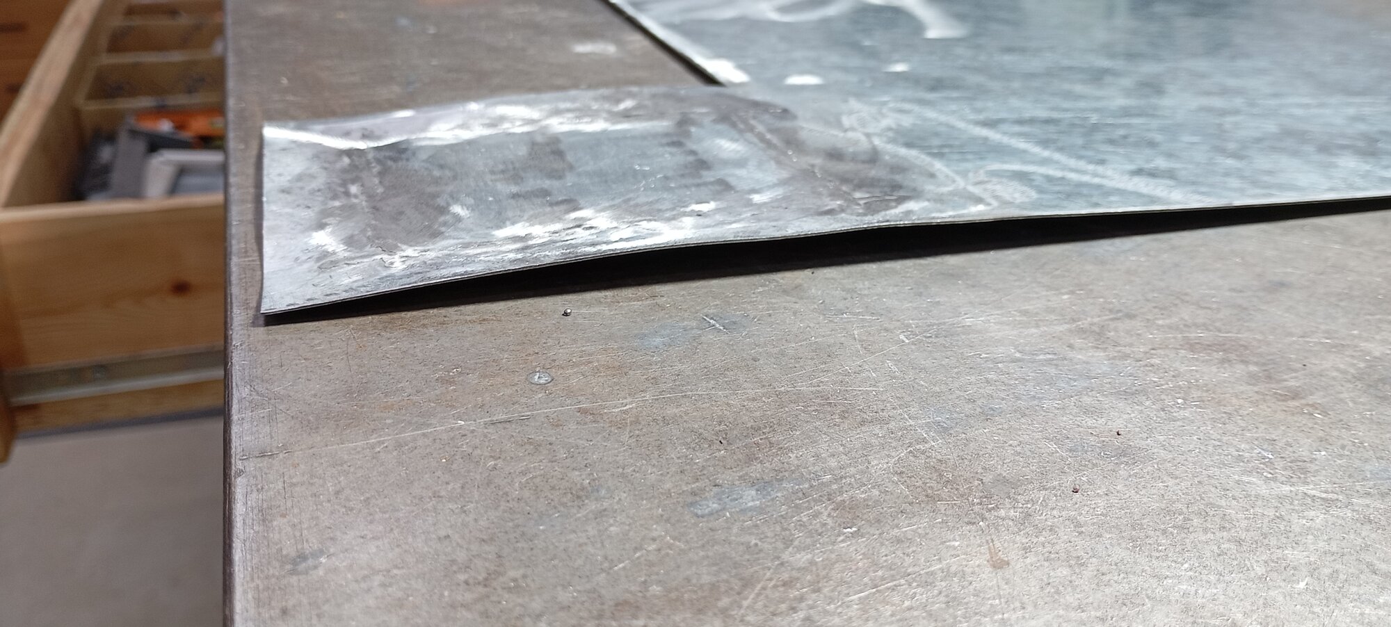

I am going to attempt patching a sunroof panel on my car and was thinking about how to do it. I am a self-taught welder having read numerous posts of this forum and watched endless youtube videos. I got several projects under my belt, DIY but still holding up strong after many years. But this is my first attempt at auto-body welding and at such small thicknesses.
The roof panel is 0.8mm thick and the sunroof panel has been cut off the donor roof (rather crudely) and will be trimmed to a reasonable size before attempting the actual process.
I have investigated the following:
1. to use a joggler, but I soon found out that the curvature of the roof panel might get distorted by the clamping action of the joggler. Then do a lap weld.
2. to weld a thinner piece under and around the existing roof panel after cutting the hole and make a seat for the sunroof panel. Then weld on the top.
3. to attempt a butt weld like the one in Fitzee's video here (
) which has been discussed before many times on here.
After watching other professionals on youtube I decided that the butt-weld is the way to go. I also read on this forum on how to weld thin sheet metal. So far I have done/practiced the following:
0. I purchased a sheet of 0.8mm sheet metal. Galvanised but it was all I could find here in Cyprus. I remove the galv. using a flap disc before welding. I cut small rectangular pieces and start practicing.
1. Set the welder (GYS Smartmig 162) at the lowest voltage setting and began cranking the wire speed up until I could get some penetration without blowing through. I attempted butt welds, etc. until I got the hang of it.
2. I got a piece of copper pipe and made a thick heat sink to use underneath.
3. I use compressed air all the time to cool the panel down.
4. I use a 3mm cut-off disc to grind the welds down and then a flap-disc and an air file. I do this slowly as not to overheat the panel.
5. I do continuous tack welds every 1.5 inch or so.
6. I try to cut at a 45 degree angle as best as possible. You have to cut your patch piece as straight as possible, which could be one of the reasons I am not being so successful.
I am getting distortion in my attempts as you can see in the pictures below (front, back and sides). This is my 5 or 6th attempt. I am guessing that this is because I am doing this at the end of the piece and not in the middle.
I would like to ask the pros on here to give me some pointers and advice.
Cheers,
Evros
