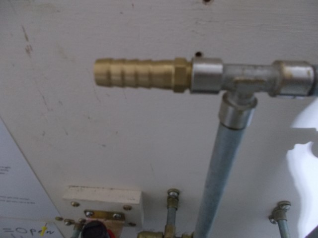

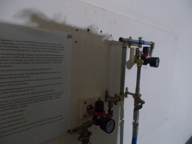

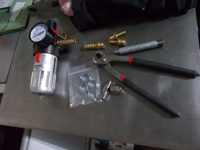

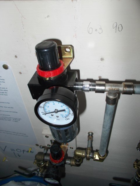

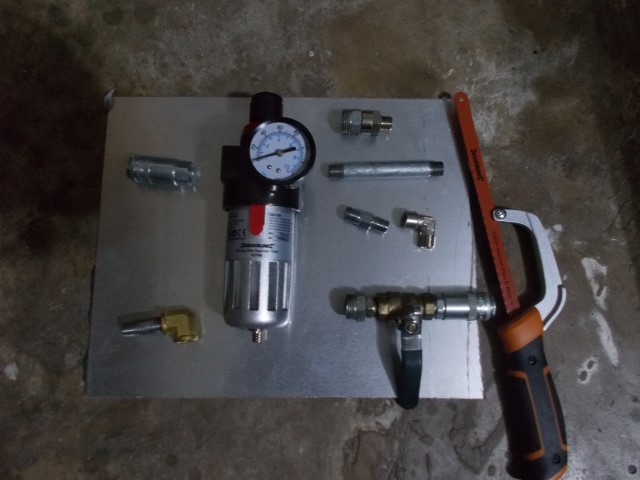

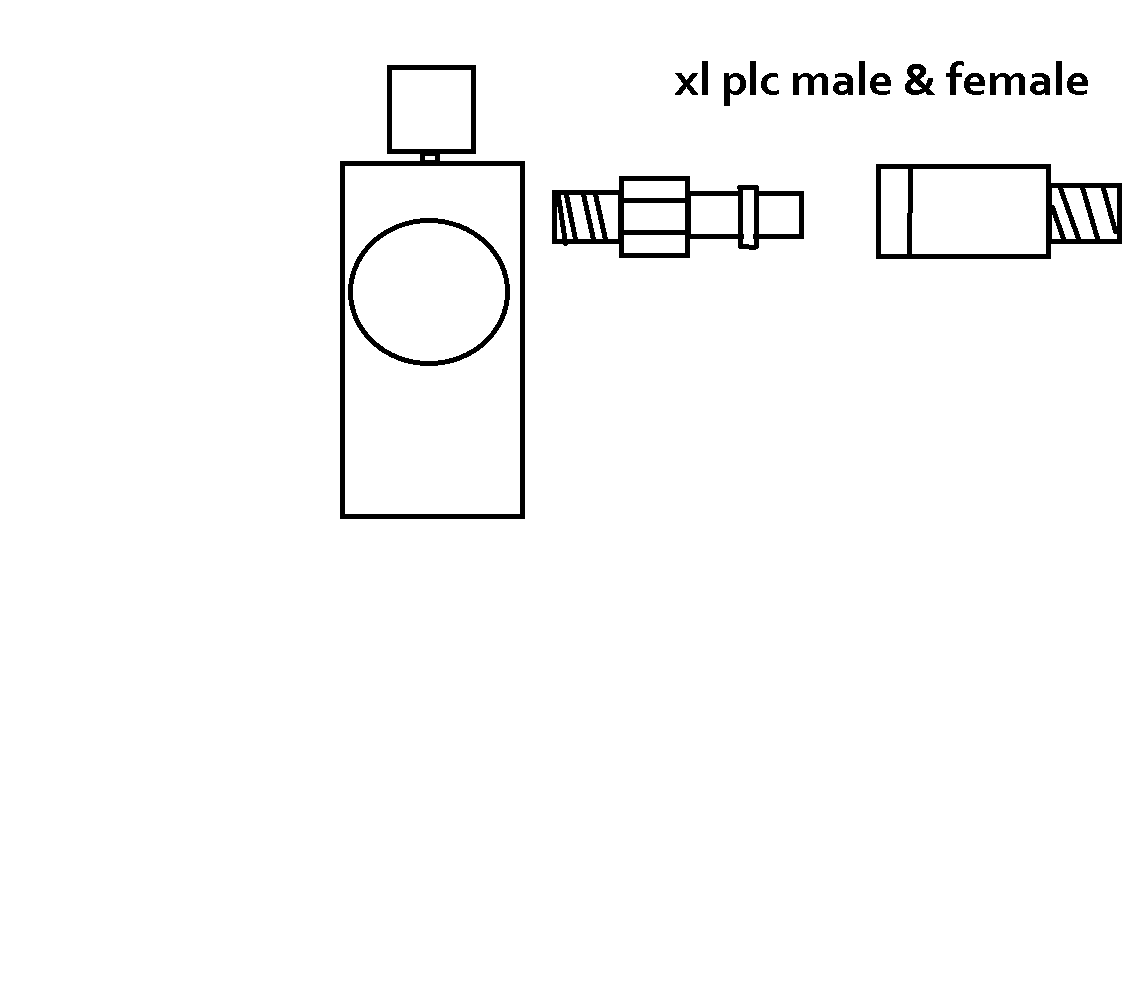

Instead of using Butane torch to loosen up high strength threadlock. I decided to use a hacksaw, got the faulty regulator off the board ok. The new regulator will have to screw a noggin into the board screw the mounting ring into that so the regulator port on right lines up with the pipe. The barrel connector, nipple I think thats the right word. If I screw the barrel into the regulator, the other end will unscrew from the T there isn't room between regulator and board to rotate regulator. Can one get a barrel connector, that as I screw into the regulator, the thread on the other end will screw into the T. I have a few odd fittings. don't know if any of them any use?
Thamesair Ltd Swindon, carry a full range of fittings but close on Friday 21st December and reopen on Wednesday 2nd January. Screwfix and Toolstation, only carry a couple of fitting types. Is there anywhere else in Wiltshire I could get a suitable connector? Machine Mart carry a few more than Screwfix but not so easy to see everything they carry.Perhaps a couple of male quick connects, joined with airline with a tail each end? Um on second thought don't think that would quite work.I don't know though, https://www.machinemart.co.uk/p/1-4-x-1-4-hose-adaptor/ one end could screw into the T with hose clamped onto the barb, then fitted into a male quick connect into the outlet port of the regulator?
