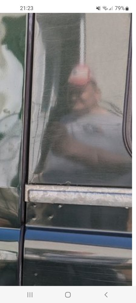

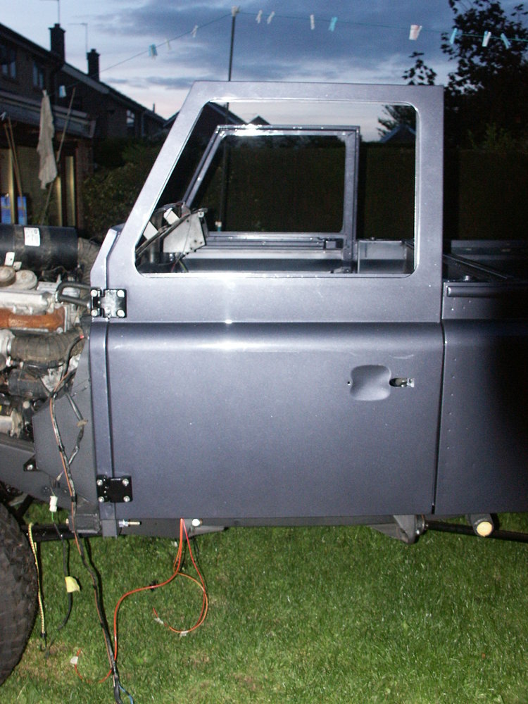

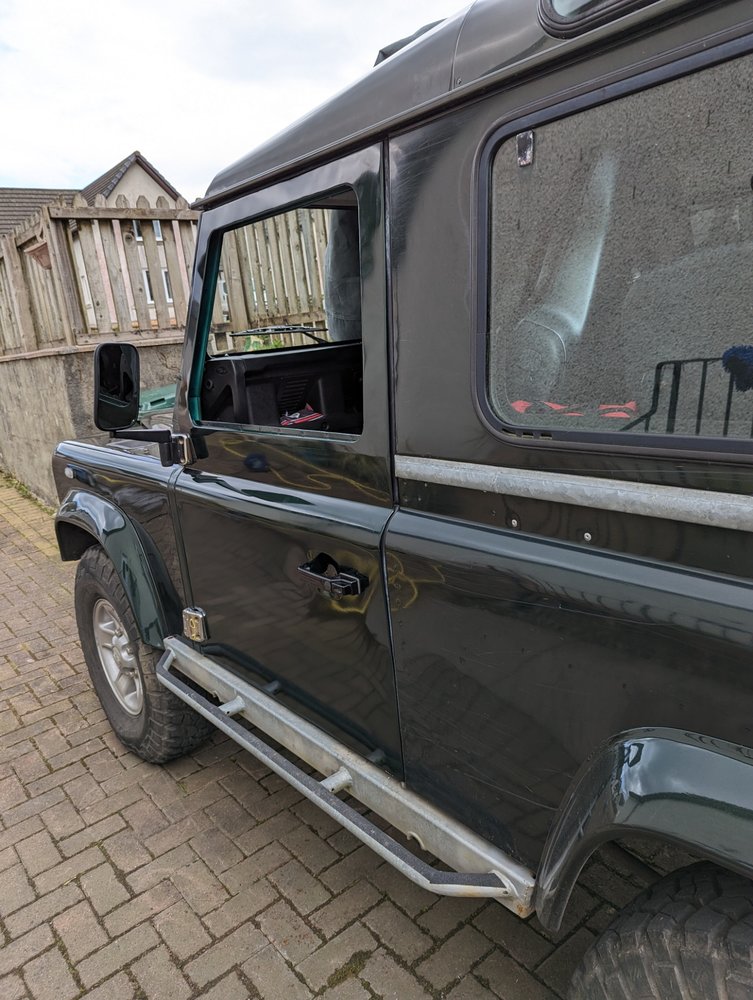

from the bottom to the below the windowTwisted side to side (across the width of the vehicle)
or twisted fore and aft?
More work with the block of wood at the bottom of the door.from the bottom to the below the window
I thought that about the paint as soon as I realised how far out it was.bit late ,,, but its best to get a reasonable fit on lr doors before you paint them , then you dont crack the paint ,,, the bottom corner has to be right ish and the body line then its just brute force ,, we use a portapower on the doors , or the body to get them to fit ,,, but at least they are in the hole , believe it or not thats a mighty good start .
those doors you have just taken off will have a decent resale value , Ive repaired a lot worse and folk have been glad of them ,,, dont just bin them .
ive seen me put them on the ramp and ratchet strap a six foot bit of 50 50 box on the inside where the window gap is at the top where the handle usually tears them , trouble is that can get a bit brutal ,, and they can tear. use a block of wood where the bar crosses the door bottom to so as to spread the loadI thought that about the paint as soon as I realised how far out it was.
I have offered the old doors to @willie.macleod on the forum.

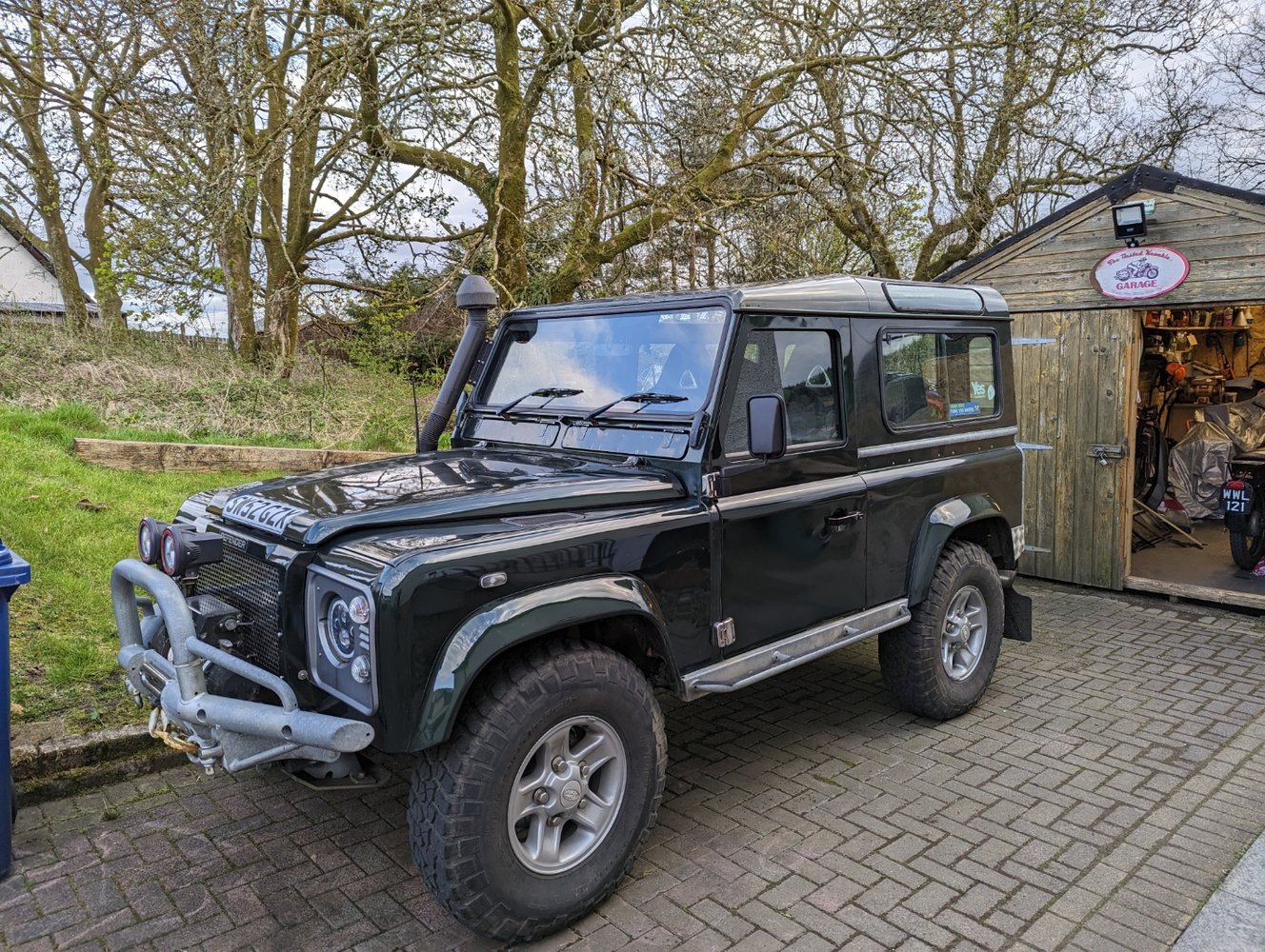

take a pic looking down the vehicle to get a look at front edge alignment ,, although it looks not too bad
YesIs it on flat ground
just needs a tweak at the end with a fence post
its genuinely how I do them ,,, lolThat made me laugh

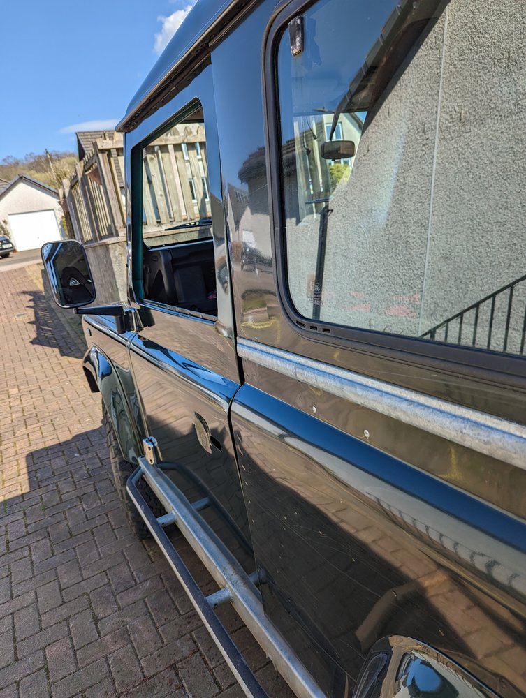

The stainless hinges have not seen much use, no discernible wear.Is there any wear in your hinge pins? I normally aim for a 88 cm gap between the tub and bulkhead. I’d say a few hinge shims would get you very close part no:BDC710040 for “td5” style hinges you have fitted, earlier square hinges are a different shape if buying shims just. A knee in the middle and a pull on the corner is normally the go to for me I’ve fitted more than a few doors in my life to them
Thanks John, am back to work tomorrow, so will get a risk then^^ Looks pretty good, Tom - take a day or two rest before tackling the other side.
