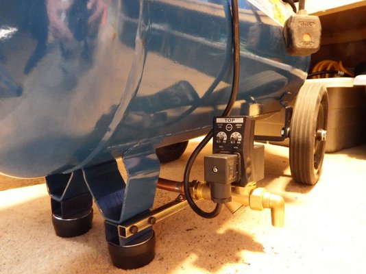

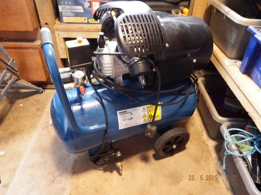

I've Been concerned about forgetting to open the drain valve and a build up of condensate in the tank.
So I decided to fit an auto drain valve, I searched the internet and found one with a stainless steel in line
Filter, for £19.12 including delivery. It took two weeks to arrive from china, this gave me plenty of time to get all the pipework connections ready.
I'm very pleased with the outcome, it works perfectly, as you can adjust the frequency and length of time that it opens.
I was a bit concerned that as it's positioned near the floor it might get knocked and damaged, so using
1/2 box section I made up a small crash barrier for it.
