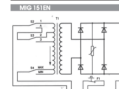

A few years back I was curious enough to poke a MM into my Clarke MIG and came up with some figures.
