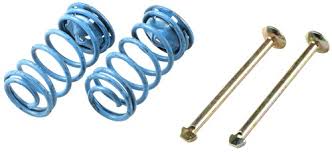

Is it for fitting those shoe retaining springs that you push & twist the washer over the pin? Can't describe them any other way, the ones that hold the shoe to the backplate.
Hold down pins with a half turn washer, I use snipe nose pliers with a groove cut in the jaws to hold the washer and push against the spring. They are specially adapted with a hacksaw.
BTW Mole wrench method only works if there is a portion of the shoe without friction material where it can be attached.
