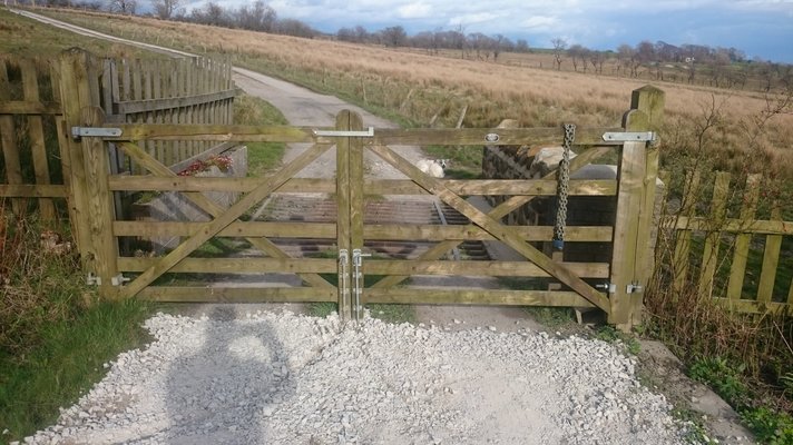

Following on from my new workshop thread, I have to make a pair of doors. I want a steel frame and clad in wood. I'm not too worried about security as the to get to the workshop its about half a mile down a private driveway, not visible from the road, no footpaths anywhere near, a fair way outside a small village and you have to drive right past the landlady's house. However saying that, It will still be secure.
I was thinking of 30x30 2.5mm box the large door is 190cm by 220cm so once clad it will have some weight and I don't want it to go out of square. Will this be sufficient? The Large door will open only form the inside an the hinges will not be the lift off type.
Any advice esp on the reinforcing is greatly appreciated, as these will be my first doors/gates.
Regards, Luke
