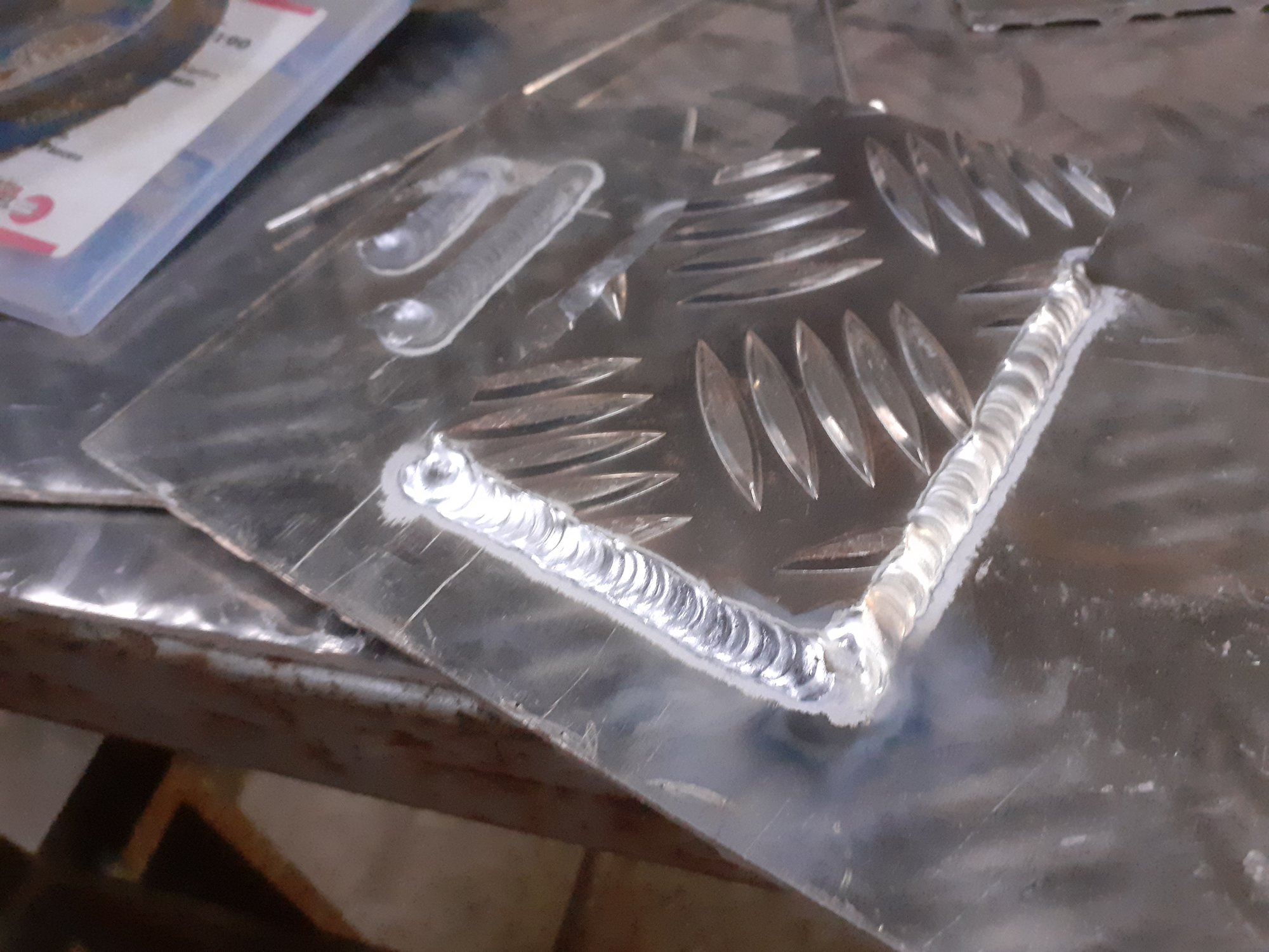

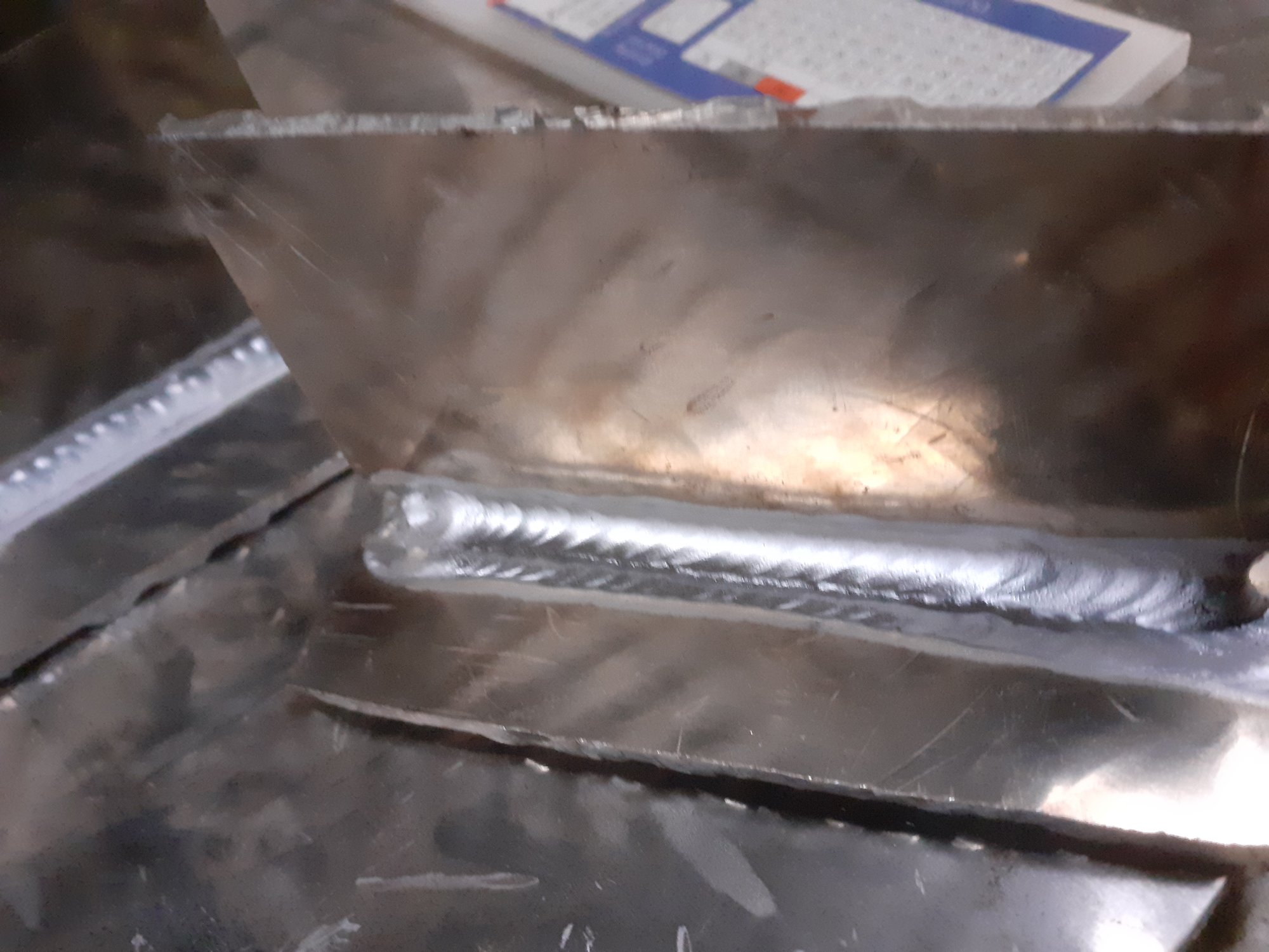

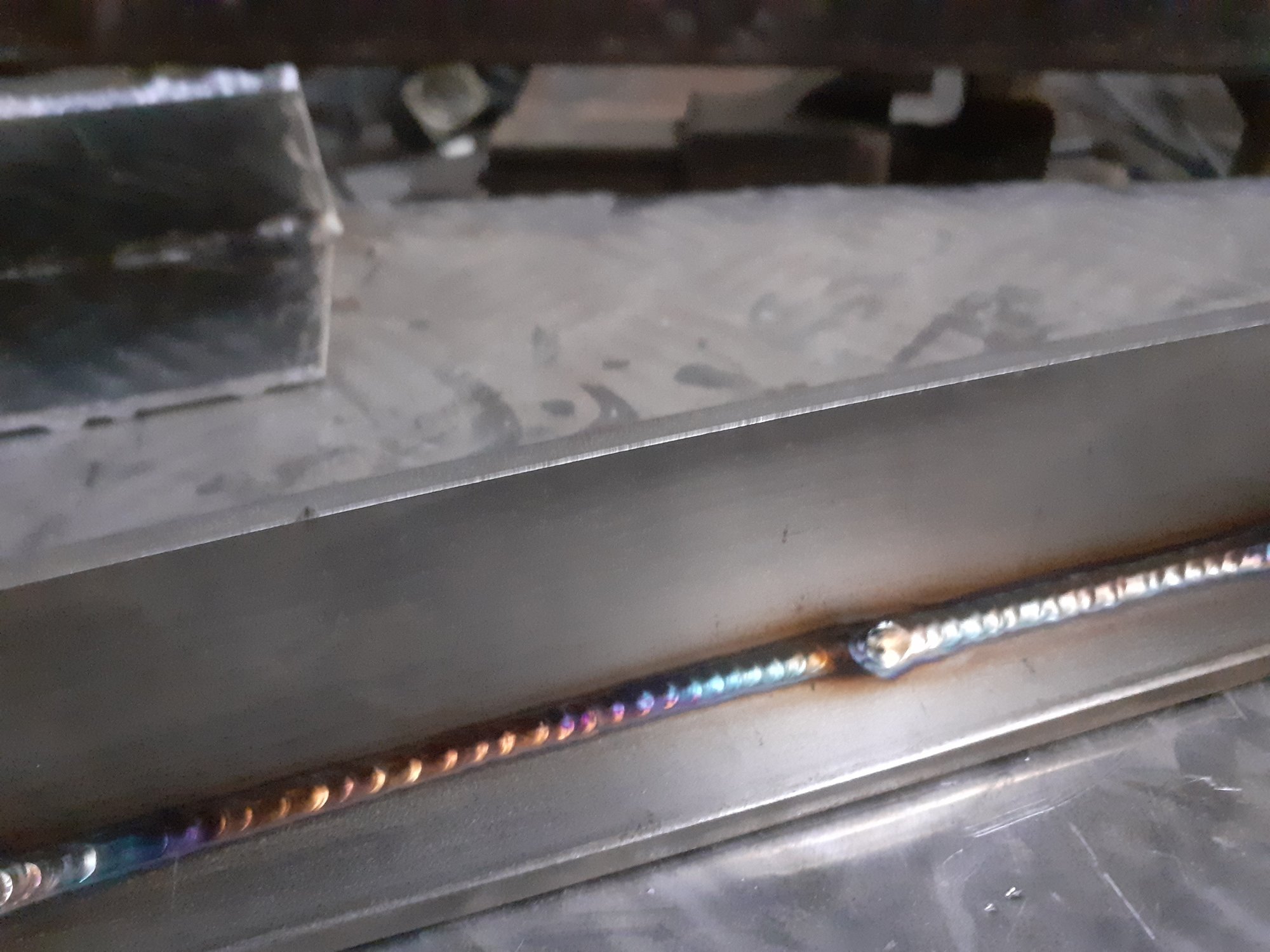

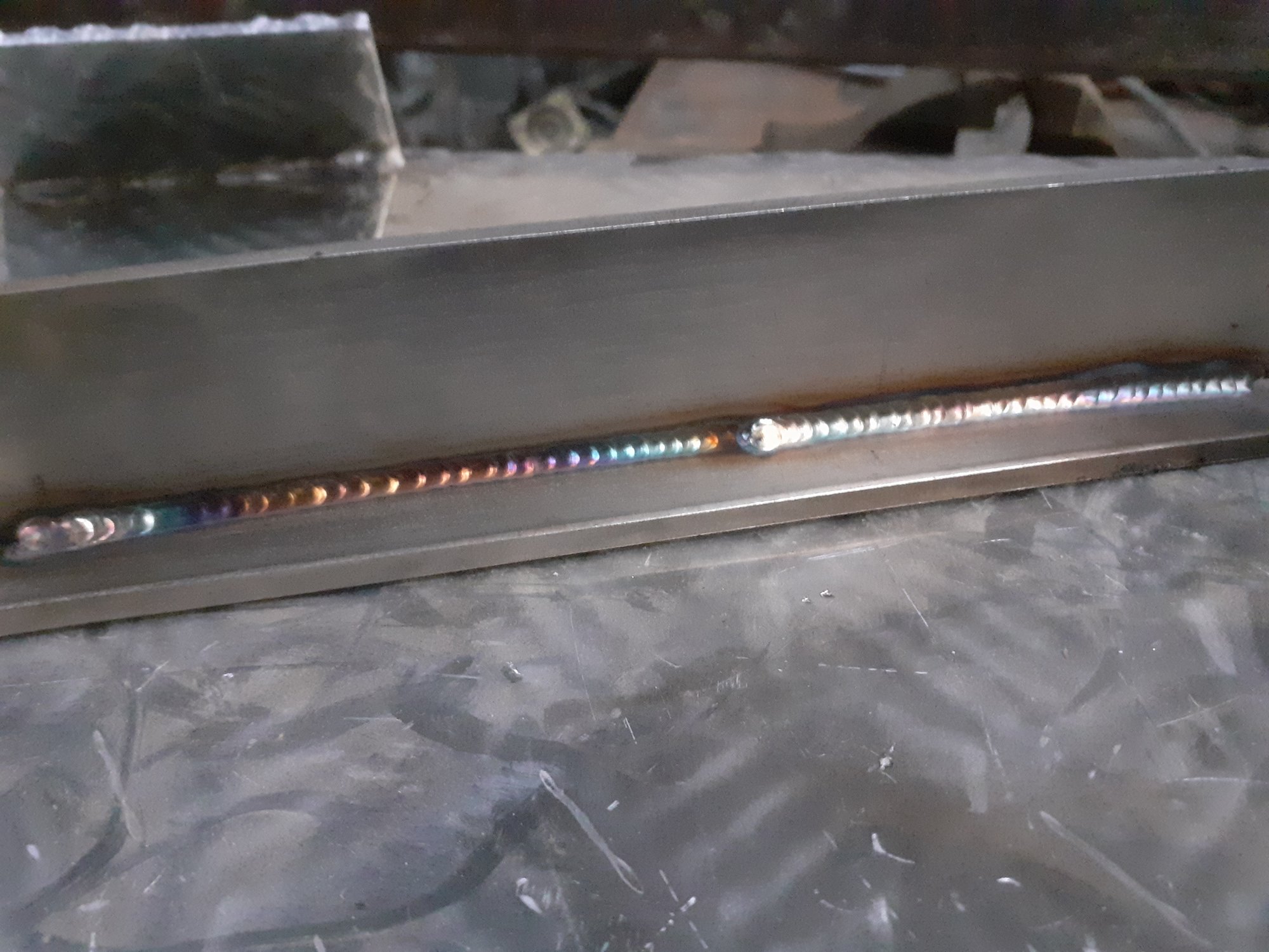

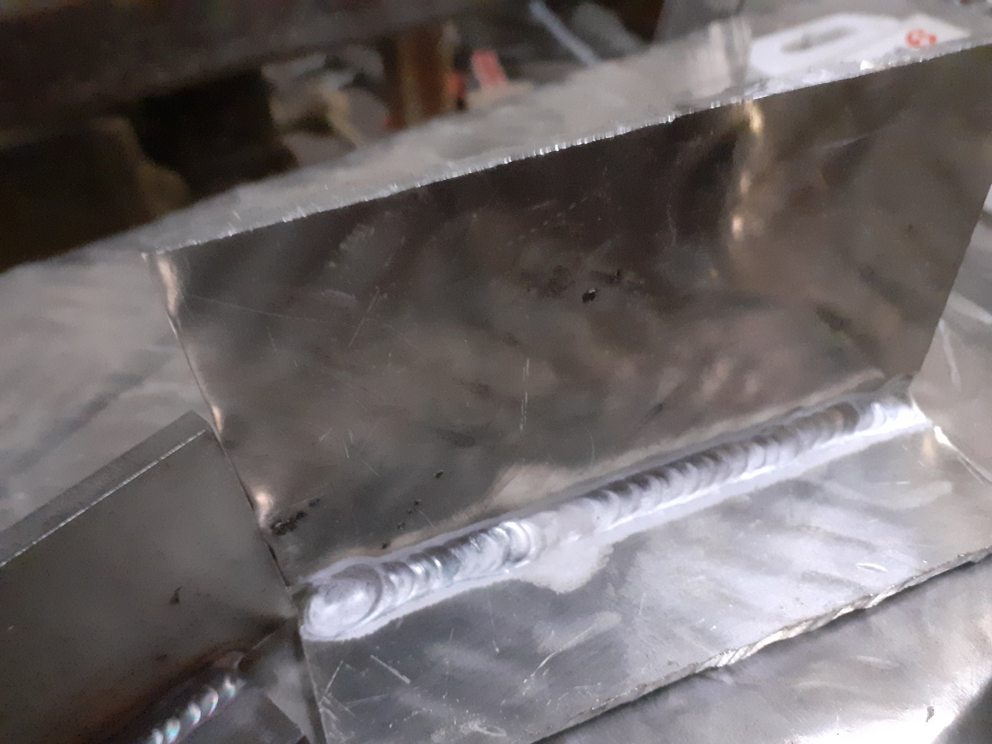

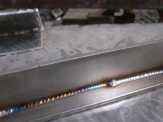

Same machine
Amps 130 ally white tungsten 60 hz
Amps 140 stainless blue tungsten
Ac for ally
DC for stainless
All using standard no 5 cup and diffusers
No gas lense used
No pulse
Wire was sif 4043 ally 1.2 mm I think
316 stainless wire 1.2 mm I think
Think I was a bit hot on the ally but haven't done it in a while and dad keeps giving me tread plate I need some normal flat to get the open corner practice in hope it looks ok feed back always received
Cheers in advance
