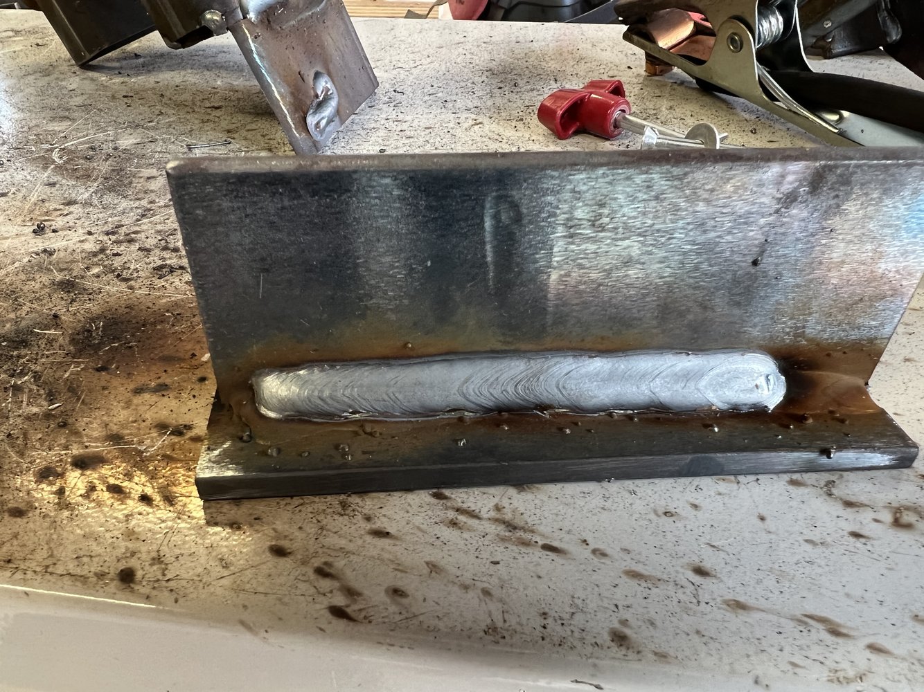

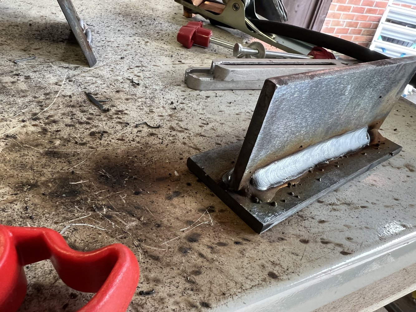

The mill scale is ground off I just used a 36 grit on the belt grinderNot so bad as first time , but I suggest less wire feed.
Grind the mill scale , it will work even better
172a on 0.8 mm wire,15% co2.the machine is semi synergic so it sorted the feed out. The metal is 6 mmwhat was the machine and settings?
According to:what was the machine and settings?
Ah yes never read that properly. Yes it's a parweld 255i had it a few weeks now.According to:
it is a Parweld XTM 255i.1.2mm ally setting on parweld 255i

) apart from that, pretty good.HiHow soon after doing the first couple of passes did you do the last pass, to me, it looks like that the work piece was hot already, and that last pass got a tad too hot, judging by all the BB's, it also looks like the bead is slightly slumping towards the bottom of the weld, but that could also be torch angle, (or my eyesight) apart from that, pretty good.
I'm not sure, I've only been welding 3 weeks.I have a Clarke 230TE. 0.8mm wire and pure CO2.
