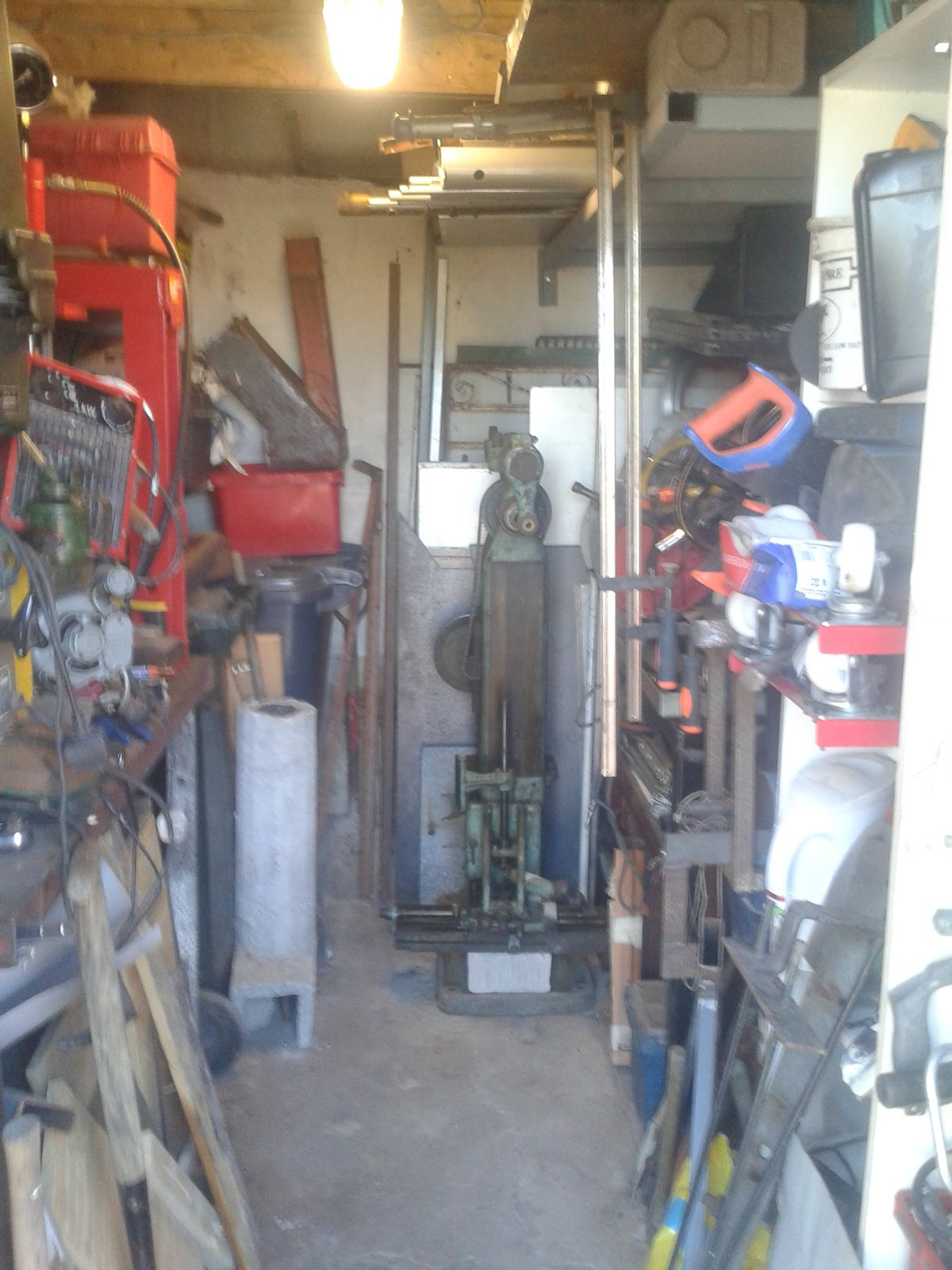

Shelves all-around at head height.
20x20x2 SHS and shelf brackets of same at c. 1 metre spacing. Simple brown rawlplugs at 250mm or so spacing. 2 per bracket.
If I can lift it over my head it can take the weight.
There seems to be a bit of over-engineering suggested - resin anchors??
I wouldn't have used angle though. Did so on a previous iteration of these shelves and they bent and twisted quite alarmingly.
