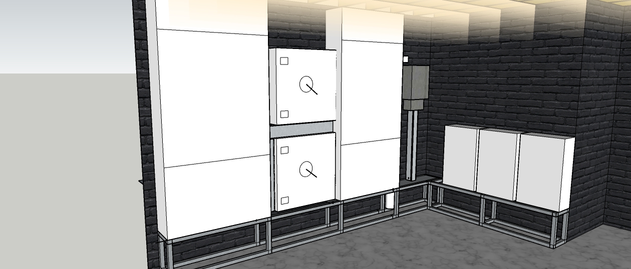

Yes! Will be using 6 anchors per cabinet. I have conlock tray going on the wall so hopefully that will keep it in the right placeWill the cabinets be bolted to the wall as well?, may be worth putting tray in the bottom of your frame to keep the cables tidy.

I will be, i have had a large server rack nearly topple since some idiot put the heavy equipment at the topDefinitely add some kind of wall fixing. One of our contractors had a rather tragic accident pulling a cable from an insecure cabinet which then fell.
Yes considered it but honestly wanted to give my self a project at my new houseHave you considered using 41mm x 41mm galvanised unistrut and fixings for this project?

The cabinets have no bottom, just the 30mm rim where they sitWhy gland on to the metal sheet, can you not just gland into the bottom of the box!

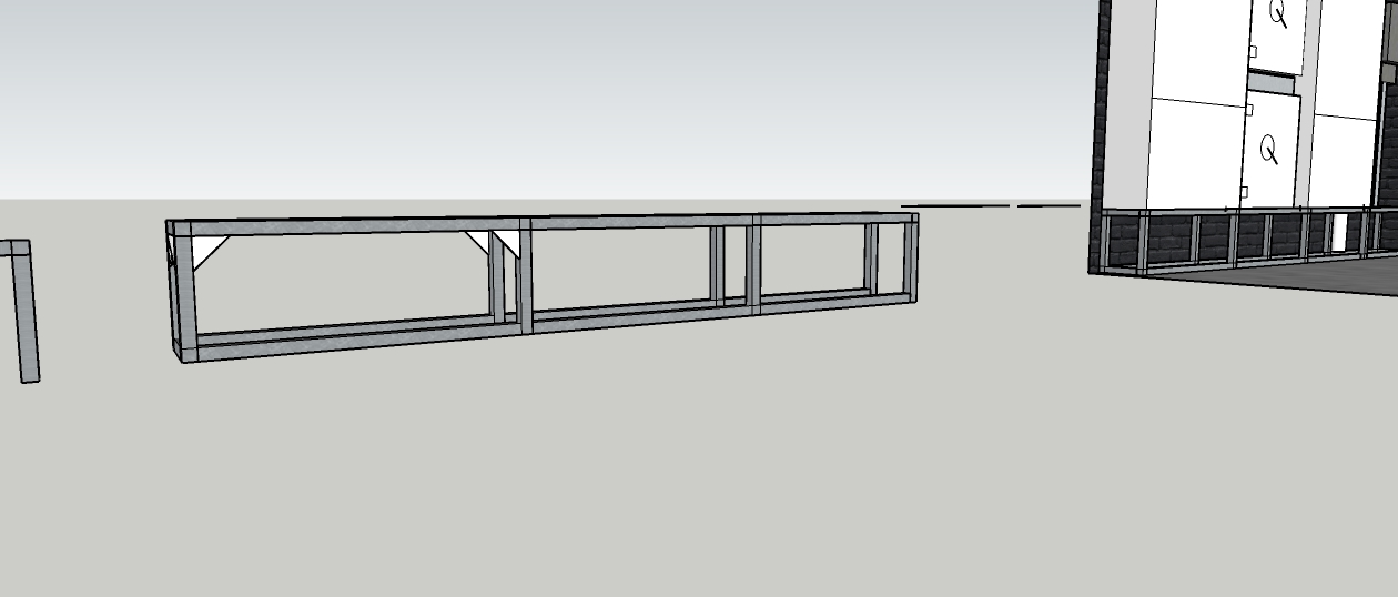

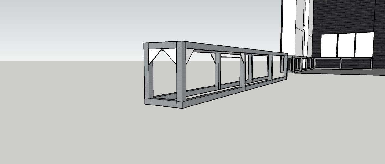

If its anchored to the wall, does it actually need a support frame capable of tonnes of support under it? Make up some blanking plates for the bottom of the cabinets . . . done.Yes! Will be using 6 anchors per cabinet. I have conlock tray going on the wall so hopefully that will keep it in the right place

Just planning my first welding project and wouldn't mind some advice. Needing to make a stand for two distribution boards as they are bottom entry, they weigh approximately 300kg each empty so expecting the whole unit will need to hold about 800kg with cabling and switches. Will 40mm 2.5mm wall square tubing be enough to hold the weight? I have put supports where the cabinets sit to stop bowing. Regarding the joints I was thinking of making both end sections first with 45-degree mitres, then welding the longer top and bottom sections onto the side of the frame with 100mm 5mm thick steel gussets for added support
Frame width 3000mm, depth 300mm, height 450mm
Also fitting some 3mm plate steel over the top, should I just tack weld it underneath onto the square tube or use some steel angle and weld that onto the square tube and the plate

Not designed to be supported by the wall anchors only to stop it fallingIf its anchored to the wall, does it actually need a support frame capable of tonnes of support under it? Make up some blanking plates for the bottom of the cabinets . . . done.
