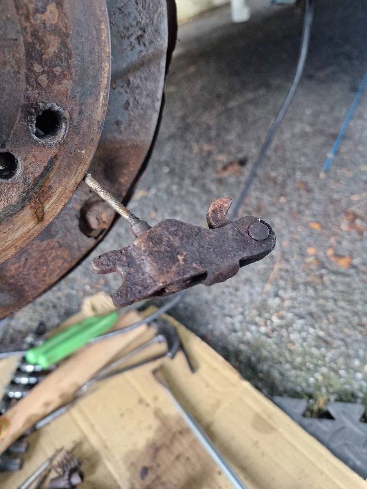

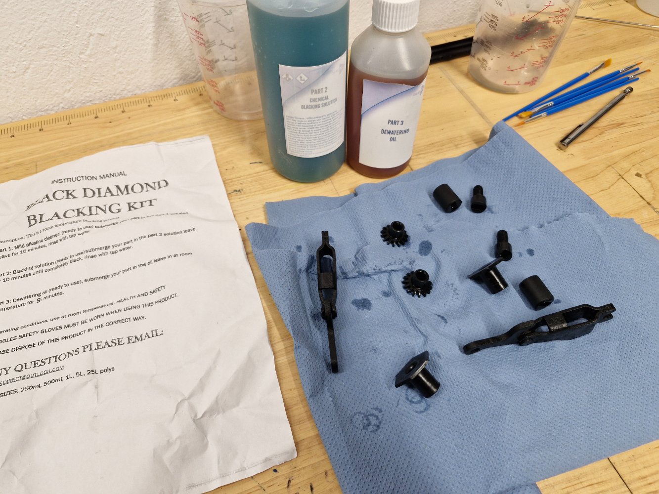

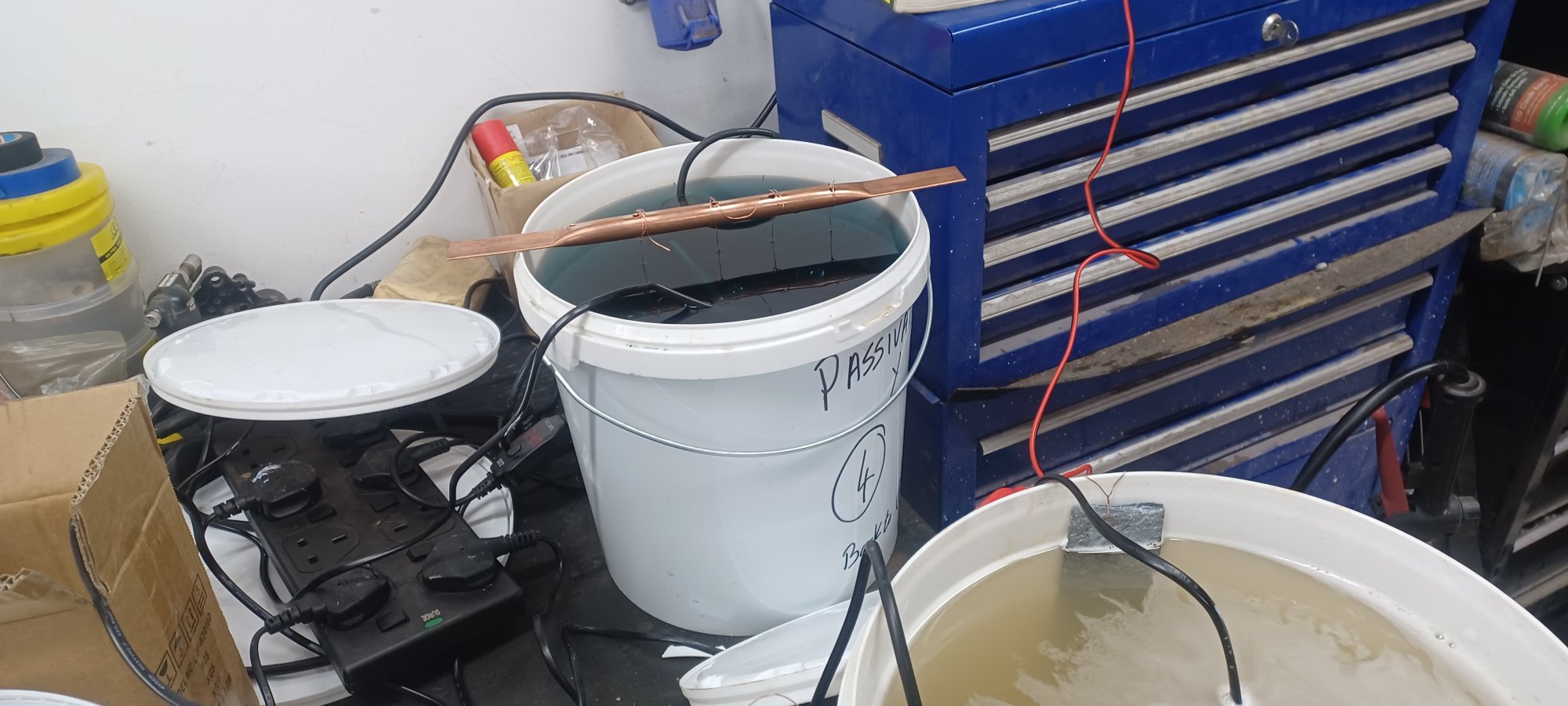

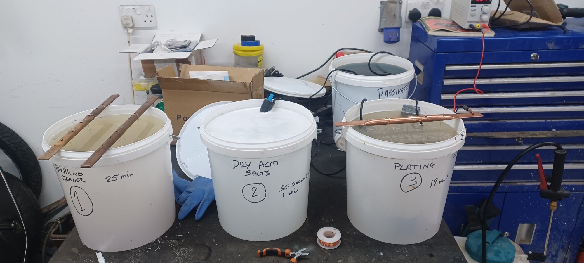

I wanted to protect the parking brake mech hardware on my 1989 merc cossie. I did consider zinc plating but its really too small a batch to bring to the local company and the small parts could get lost.
I blasted them and ultrasonic cleaned them in citric acid + dish soap. Then dunked them in the cold blue solution for 10 mins or so then into the dewatering oil for +5 mins. They turned out good, I did a couple of exhaust mount nuts too so ill be able to see how it holds up or rather, prevents rusting.
