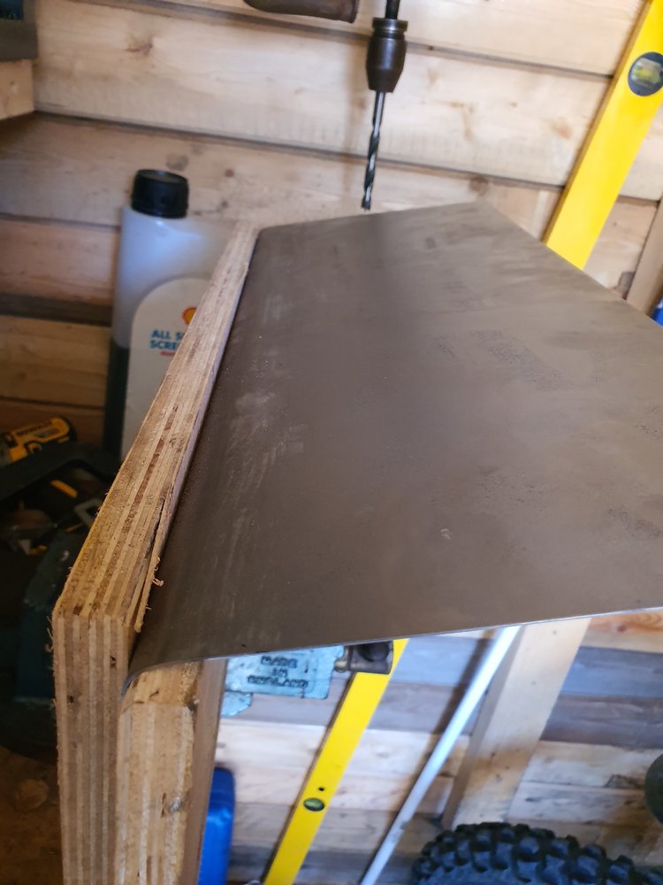

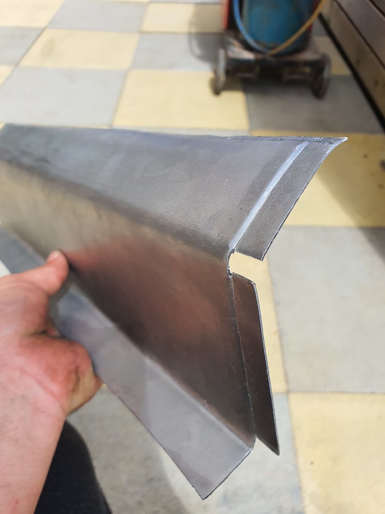

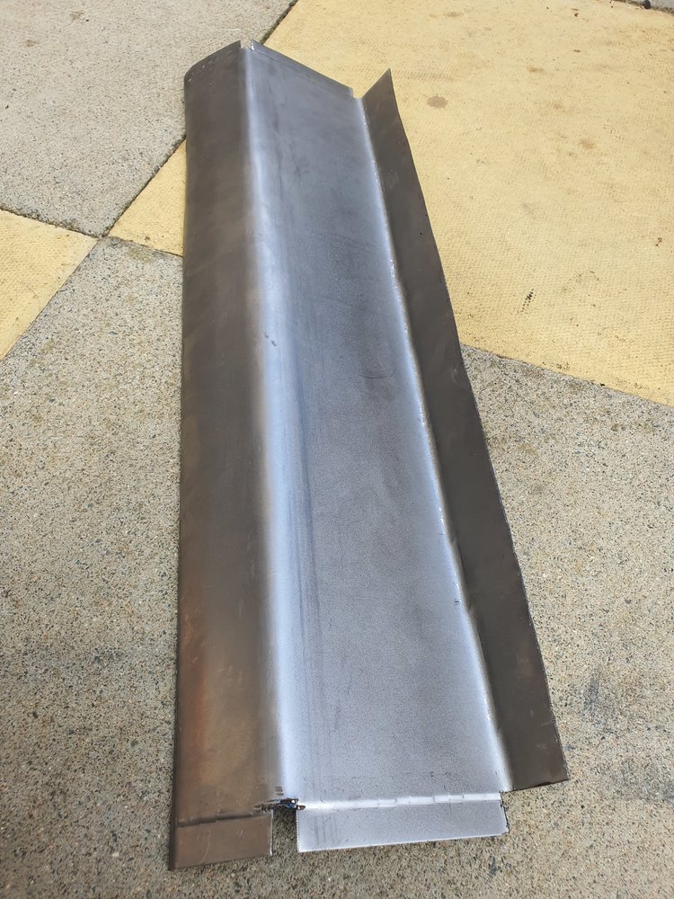

Yes, but hammer a block of wood so not to put dents in the steel. And I did the joggle with a joggler!Nice work I assume that was some bits of wood clamped up and a hammer? How did you do the joggle?
ah, I wondered if you had some "old indian rope trick" to put the joggle in without using the proper toolYes, but hammer a block of wood so not to put dents in the steel. And I did the joggle with a joggler!

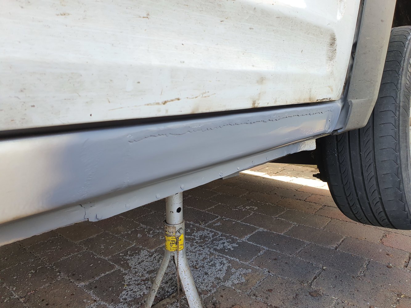

tut tut tut,never ever say thatLet's hope theres no surprises the other side.
