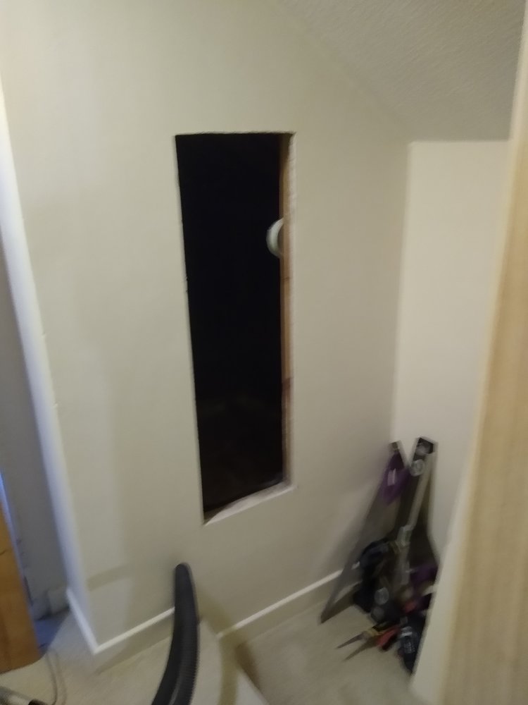

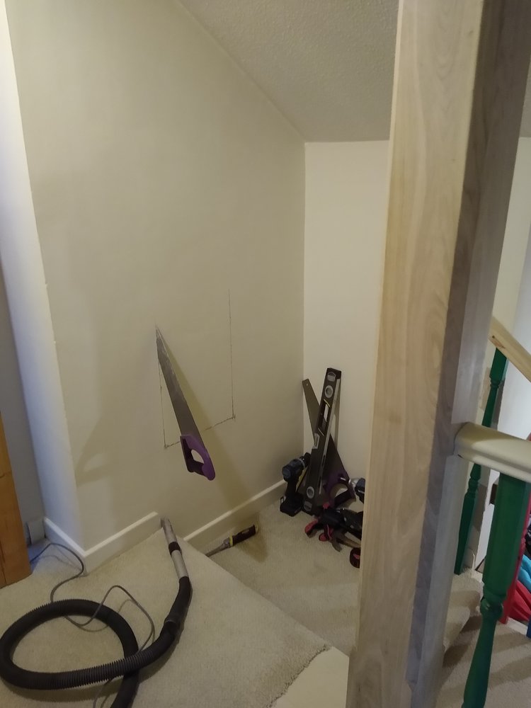

First job was to open up a hole in the landing wall to get to the first space to be converted, this is where the door into this room (bathroom) will likely end up. The bottom of this opening is roughly where the floor level will be as the front downstairs rooms have higher ceilings than the rear ones. I may have to drop it a bit, but I'm trying to avoid that as it's the kitchen below here and we have to continue to live and work here.
Which is another reason for the hole. Current access to it is via a hatch in the kitchen ceiling, that is small and right in a door way, that is the main thoroughfare in the house!

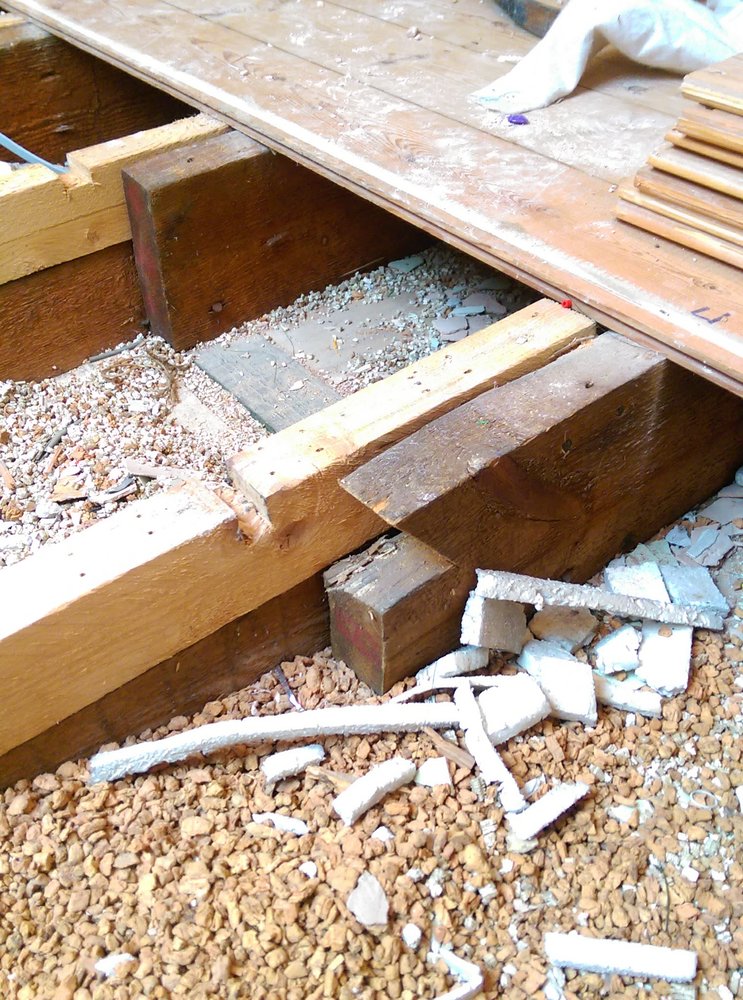

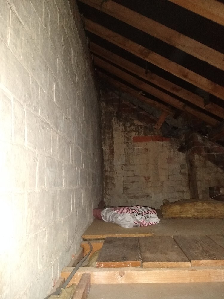

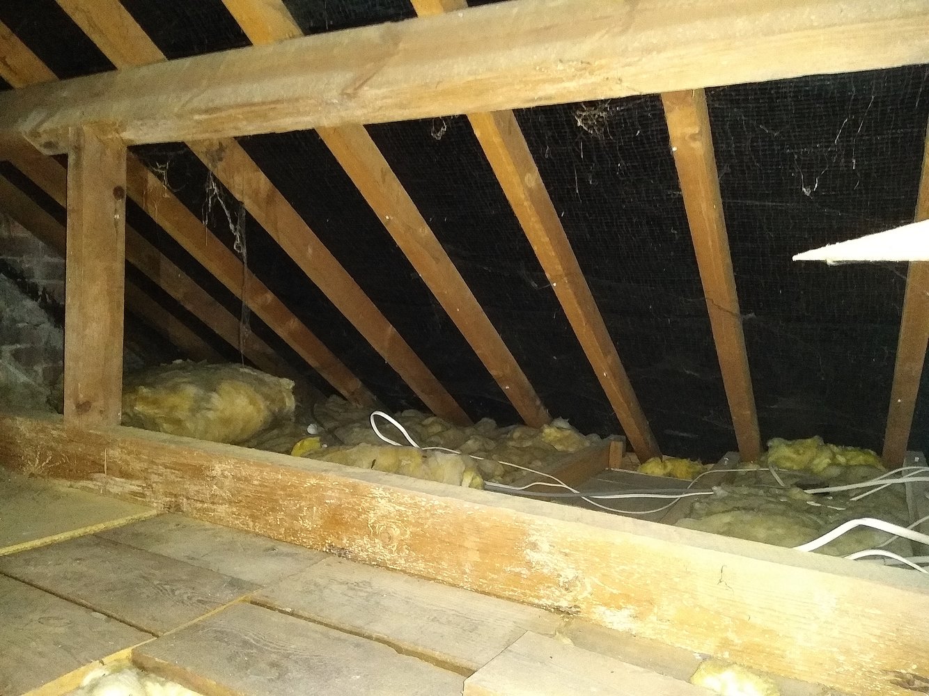

Inside this is what we have. The old cottage wall on the left (will be rear of dormer room).
![IMG_20210510_142419545[1].jpg IMG_20210510_142419545[1].jpg](https://www.mig-welding.co.uk/forum/data/attachments/285/285777-bb5a14590ff9046121933daf91b9d8cf.jpg?hash=u1oUWQ_5BG)
And where the front of the dormer will go, with an assortment of timber in between.
![IMG_20210510_142510533[1].jpg IMG_20210510_142510533[1].jpg](https://www.mig-welding.co.uk/forum/data/attachments/285/285782-112ec794ef07c0db3bfbd99765302f5f.jpg?hash=ES7HlO8HwN)
Plans are for joists running front to back. Ledger bolted to brick wall with joist hangers, front resting on outside wall, wall plate. Span is around 2.6m.
Was hoping to get these in before opening up the roof, so as to keep it waterproof as long as possible. What I was not counting on was the big lump of timber running from side to side (into wall at either end) with a post up to the purlin being the only thing resting on it. The purlin has a lap joint in it just above the post. Also all the current ceiling joists are nailed into it.
I was thinking of bolting some timbers either side of the purlin as a temporary measure, spanning the joint in order to strengthen it? It will be all but gone once the roof comes off.
That would allow me to remove that beam so I can run the new joists across.
I was also planning to put in a pair of larger joists at that end (would end up under/within the dormer wall/cheek) to support the 18" or so of purlin that's left.
