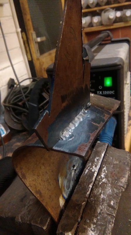

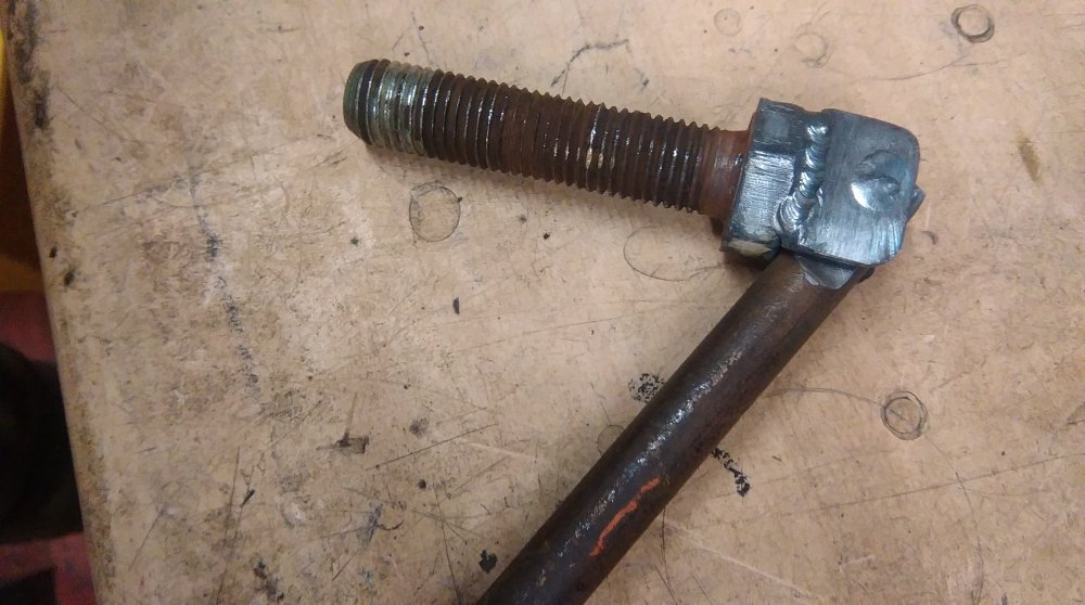

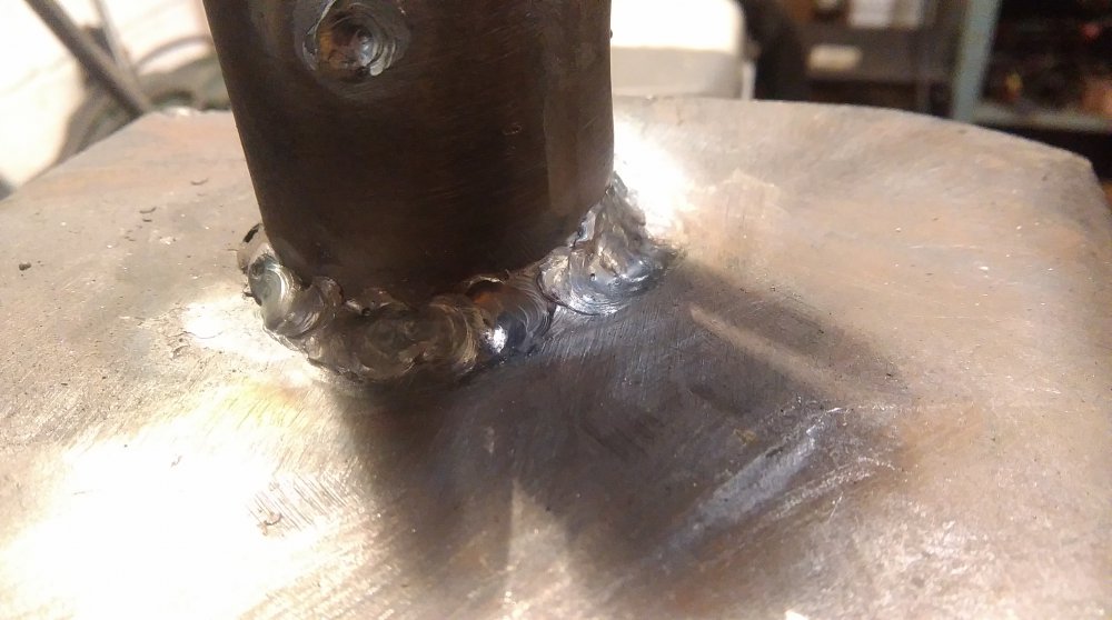

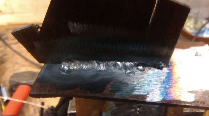

What's your opinion to the shorts beads above. CheersAll welding is about controlling heat, and Tig certainly more so than any of the other arc welding processes. Bead on plate is the very best way of mastering control of the weld pool, and once you have cracked that, the rest is much much easier.
Whether you want to hear it or not Mr spencer your skill level is beyond bead on plate IMO. Joints are where you should be heading and stepping down on thickness. I believe we worked with hefty 3,4mm stuff so now it's time to go 1.5-2mmI have only scratched the surface of tig welding this last month...and spend a lot of time doing bead after bead.and still do...and thank to a very helpful member I am progressing slowly but surely. ..I got a huge heap of plate cut up in various thickness and just keep joining em together. .outside corner. .fillet.lap ect...but that's all I do.but in doing this over and over again helps my arms/wrists to relax and work together in synchronisation and maintaining a good arc length and torch angle....and hopefully soon I will move on up to stainless and aluminium. ...IMO tig welding isn't just about joining metal together.its an art.and a hard one to master.you have to have the heart and want to learn it.as said .It is an art.not just a method of joining. .....cheers.

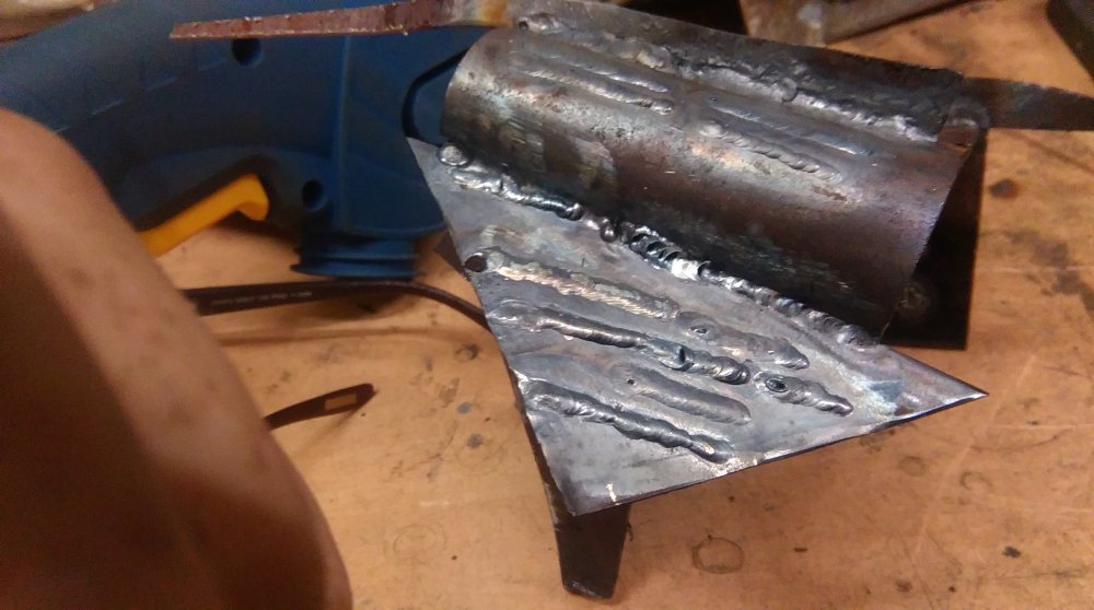

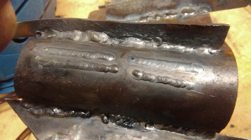

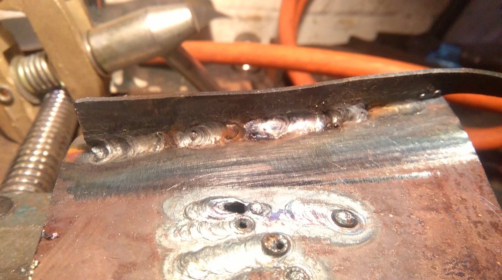

The beads laying across the tube look decent IMO. Nice one.Some beads
Have rather nice headache and shaky hands today.
Bit of oil bubbled through on some.
Why a aluminium sheet Chris mate. He's welding in DC.They arent that bad, but I think could be improved quite considerably with lots of bead on plate on something like 2mm aluminium sheet, concentrating on keeping the beads uniform width from start to finish, and seeing how you need to back off the pedal as the material heats up more. Torch angle is also important, and you might find resting on something or using a Tig Finger could make things a little easier? Tig seems to me very much about getting the basics right, and then practice, practice, and more practice.
AC on thin sheet is better for practice I would say.
