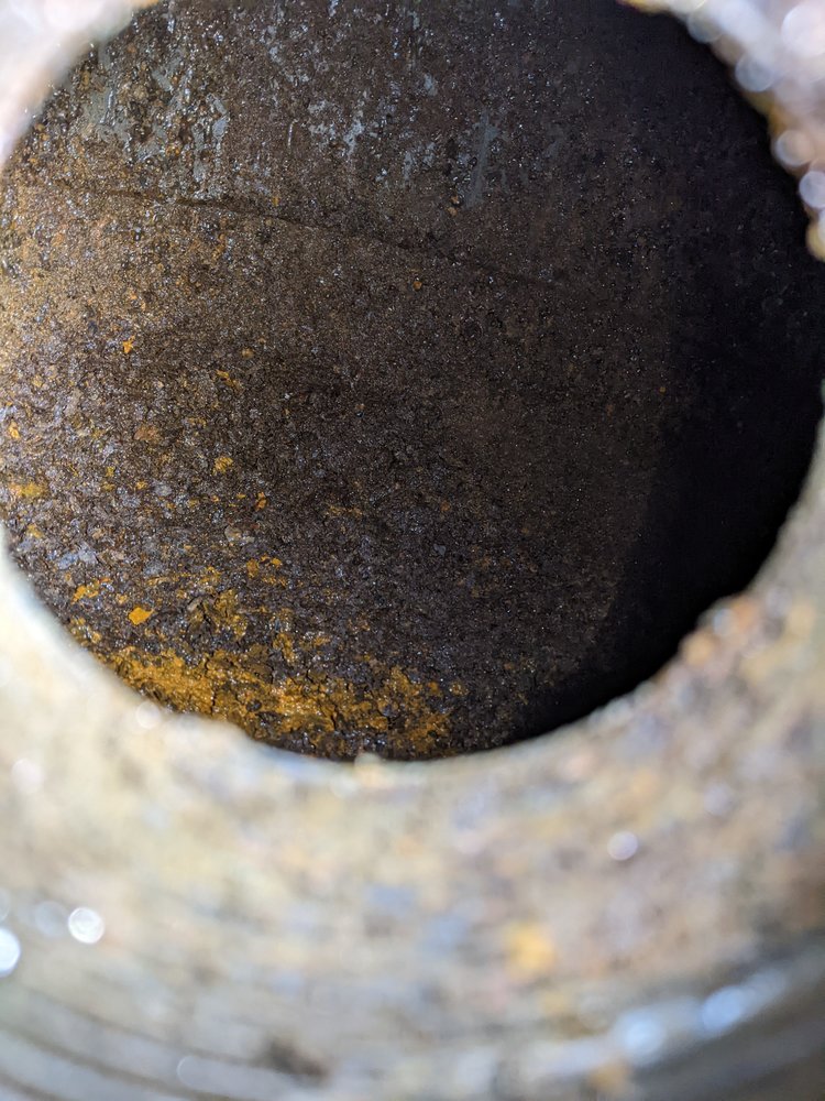

It states 12bar design pressure, so it should cut out at about 170lb/in. The danfoss pressure switch has an on/off why would you want to turn it off?There will be details stamped into the receiver that will state the test and working pressures, together with the date of manufacture. Mine is 160psi.
it happened to me
