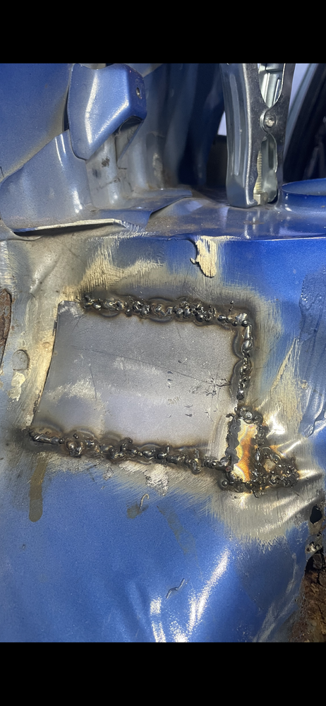

as someone who has welded things that should not have been welded with all the structural integrity of a doyley.
Power is your friend,
most welders will start at around 20-30 amps, if you are doing a nice long run on clean 0.8/1mm thats fine.
on old body work that can be as thin as 0.4mm where it has been drawn through the stamping process, you want to to get the melt pool to form as quickly as possible, will normally use around 60-80 amps with 0.8mm wire, and a copper backer if you can, a bit of old 22mm water piper flattened works OK.
When you get used to it, you can work along a panel quite quickly, you get a nice rhythm going, you do the next weld while there is still a tiny bit of heat left in the last weld. and when you weld, try and put the arc more onto the new material, around 60/40
as others have said, practise is your friend.
Yes I was watching a YouTube video and someone demonstrated it with more power and it makes sense!
Looking forward to trying it out.
