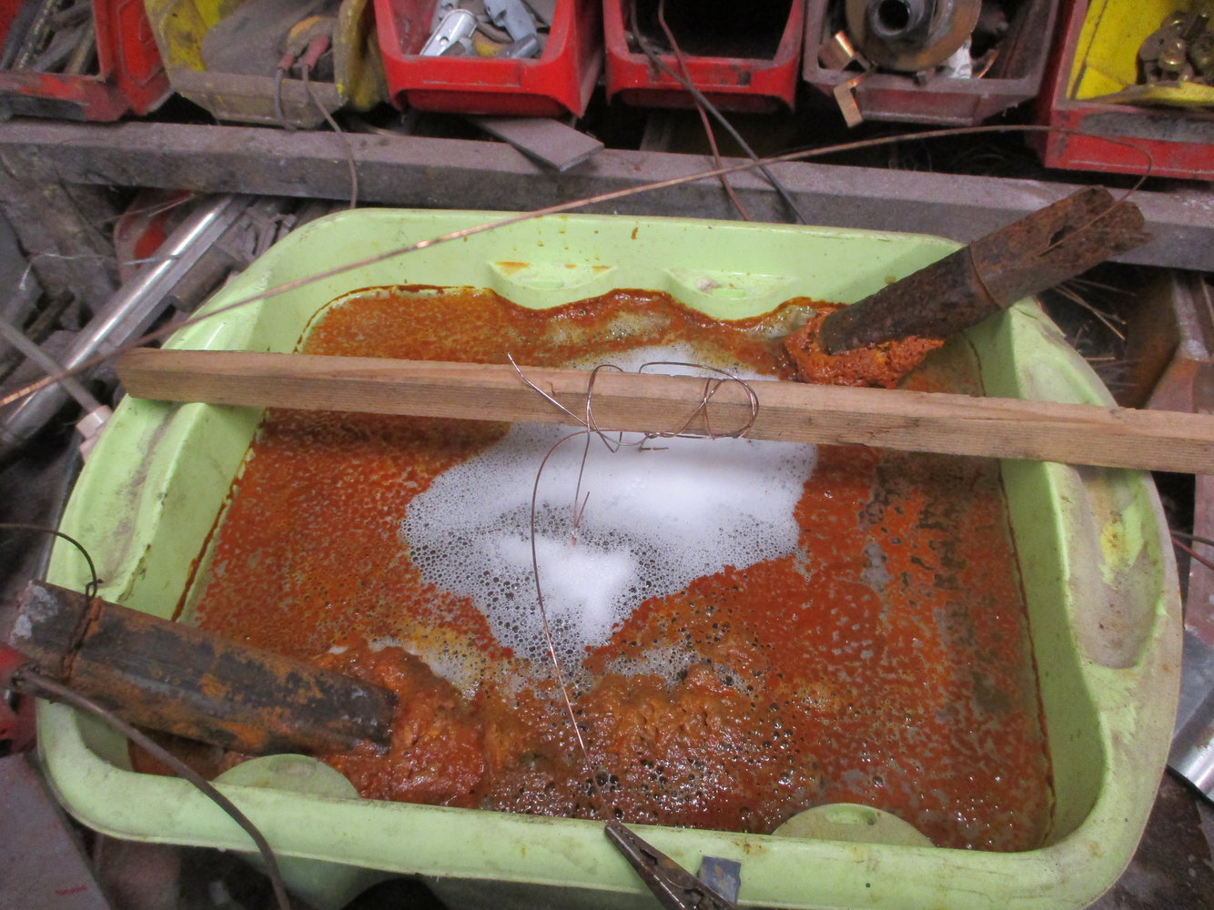

Yes, it's pretty much the case that citric acid really just helps to dissolve rust and won't do much with the metal. Phosphoric will react with the metal forming a layer of metal phosphate.I was told phosphoric acid blackens the steel, and gives it an etch surface for paint.
