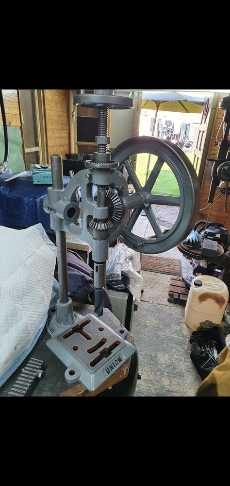

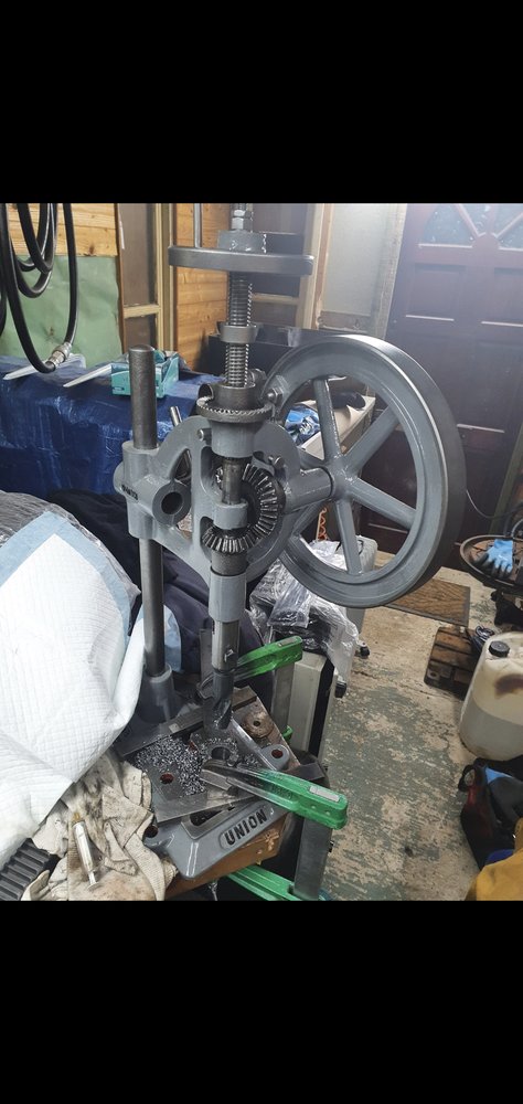

Yeah, I try to clear off the slags with the welding hammer and wire brush, before putting anther layer of welding on.
I practiced laying down many straight beads on mild steel before welding the cast iron.
The welded cast iron was preheated with torch before welding too.
Arche have you been practising on handrails by any chance?
I think there is way to much build up on that repair now to know whether its taken or not. I think you would be better off attacking it with a grinder and prepping it again with the view to welding it with some suitable rods.
