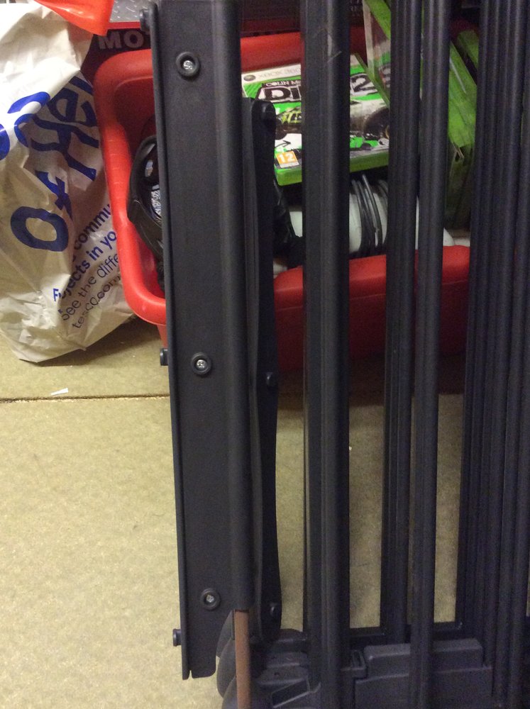

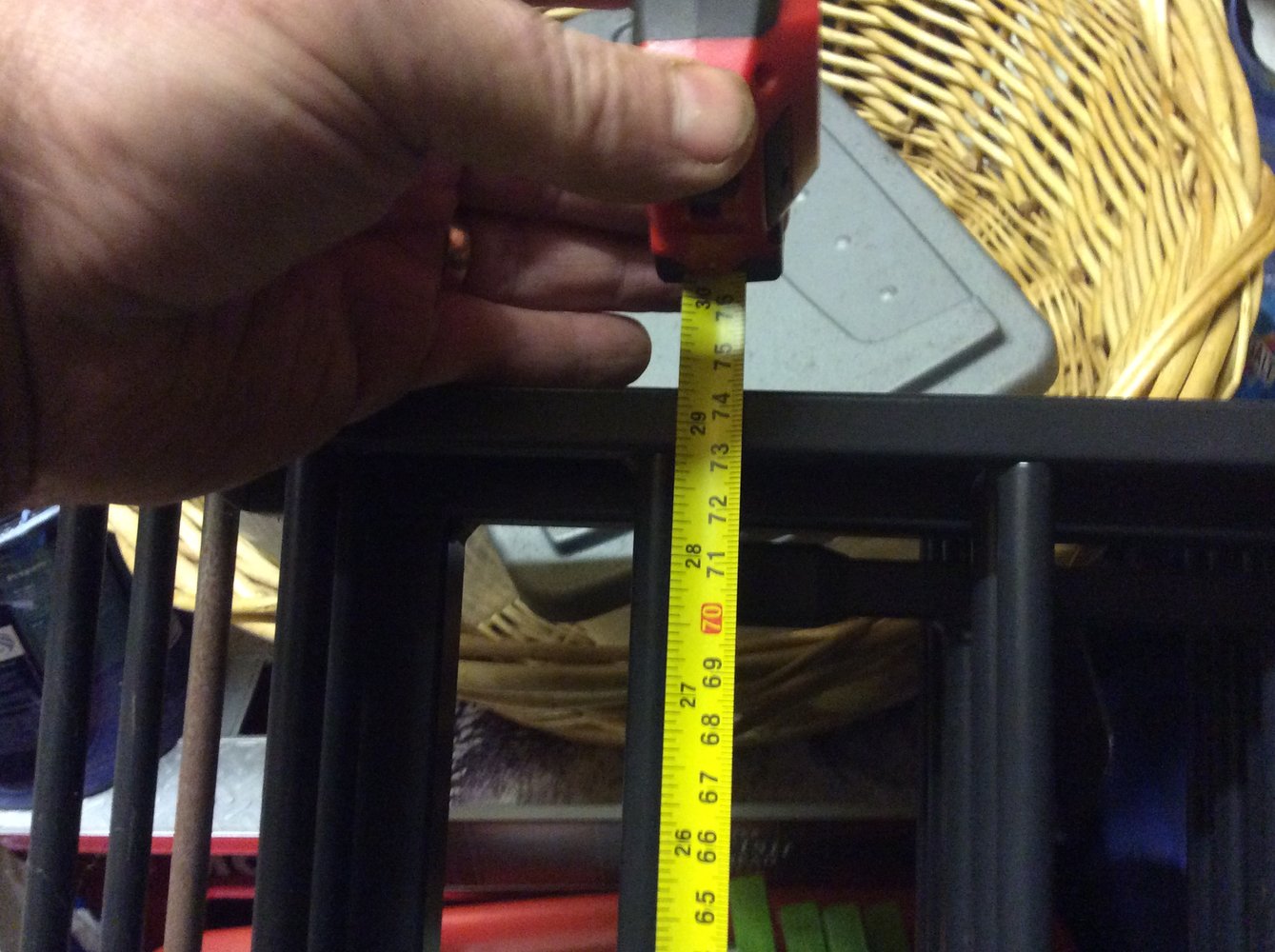

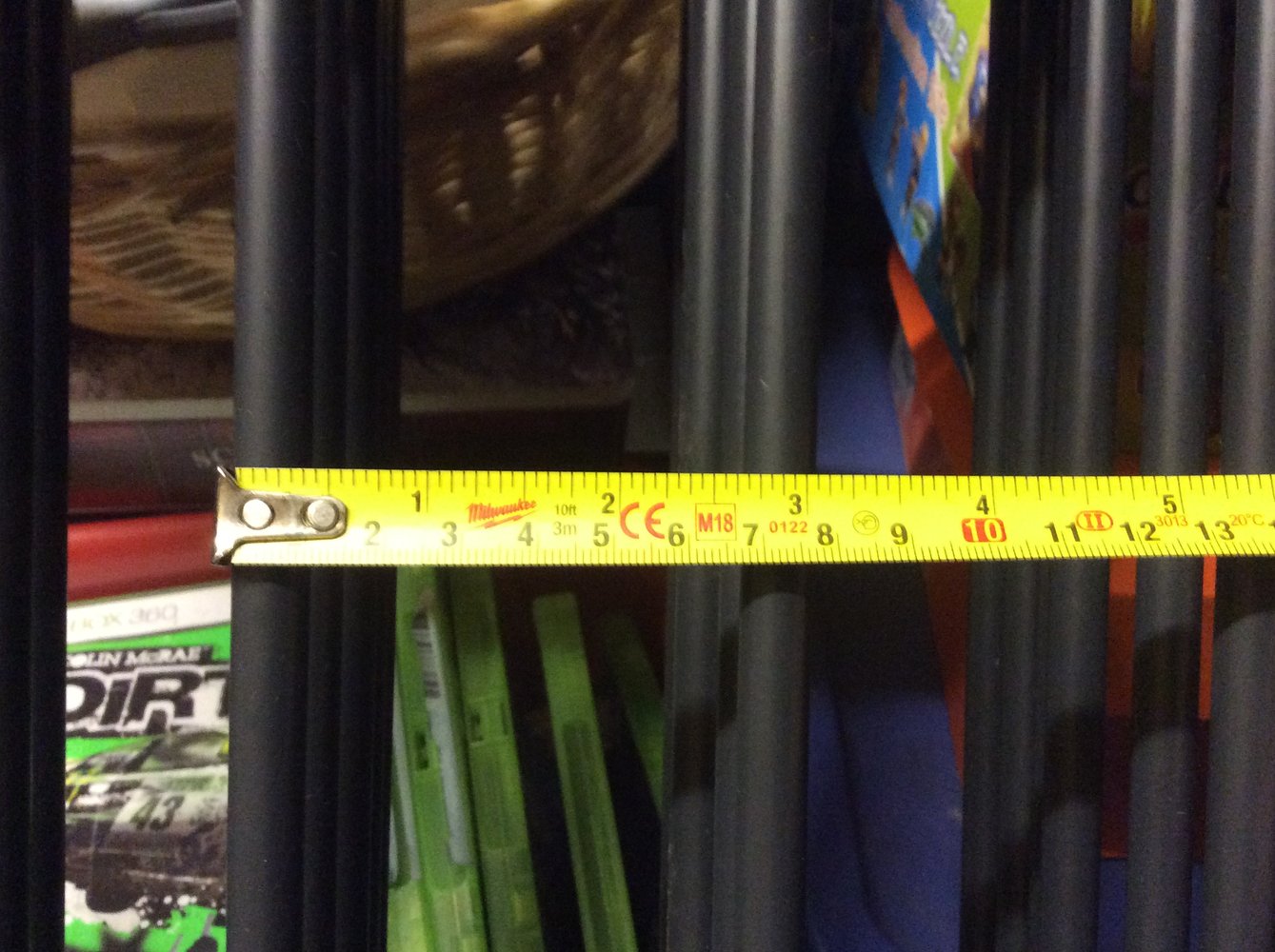

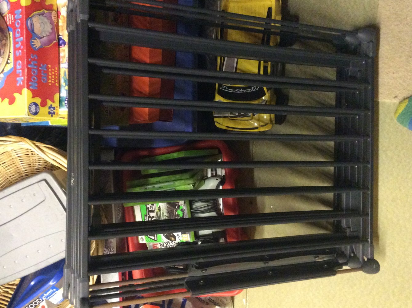

Thank you. I’ll draw something up and see how I get on. Oddly he wants 720 minimum height which is about the same as yoursIt’s a panel affair, makes it easy to fit round any fire. Has brackets that secure it to the wall, they can be left on the wall and the fire guard removed whilst not needed. One of the panels is a gate, handy for getting to the fire. Locked with the same lock as a stair gate. Pictures are rubbish but you’ll get the gist of it. It’s alluminium but I lost two of the bars and replace them with steel hydraulic pipe
I think when we looked at getting a guard the minimum height was 70cm. This might just have been a “suggestion “ by the lady doing the checks.Thank you. I’ll draw something up and see how I get on. Oddly he wants 720 minimum height which is about the same as yours

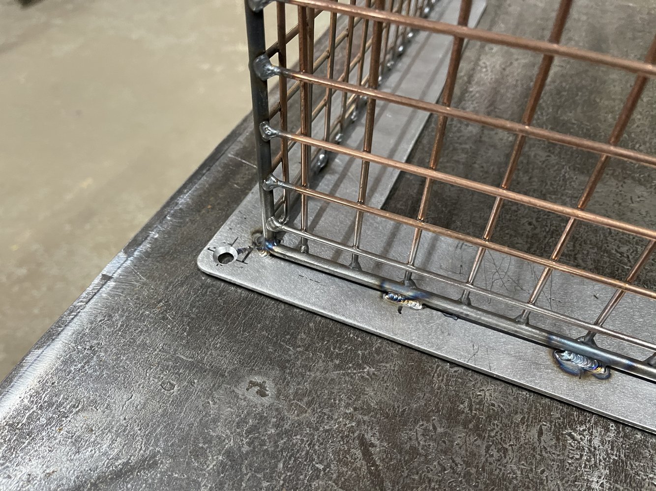

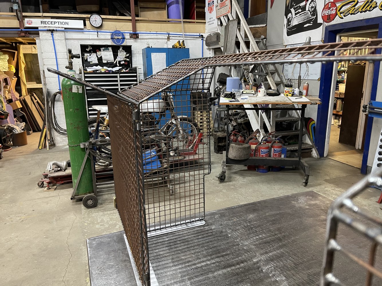

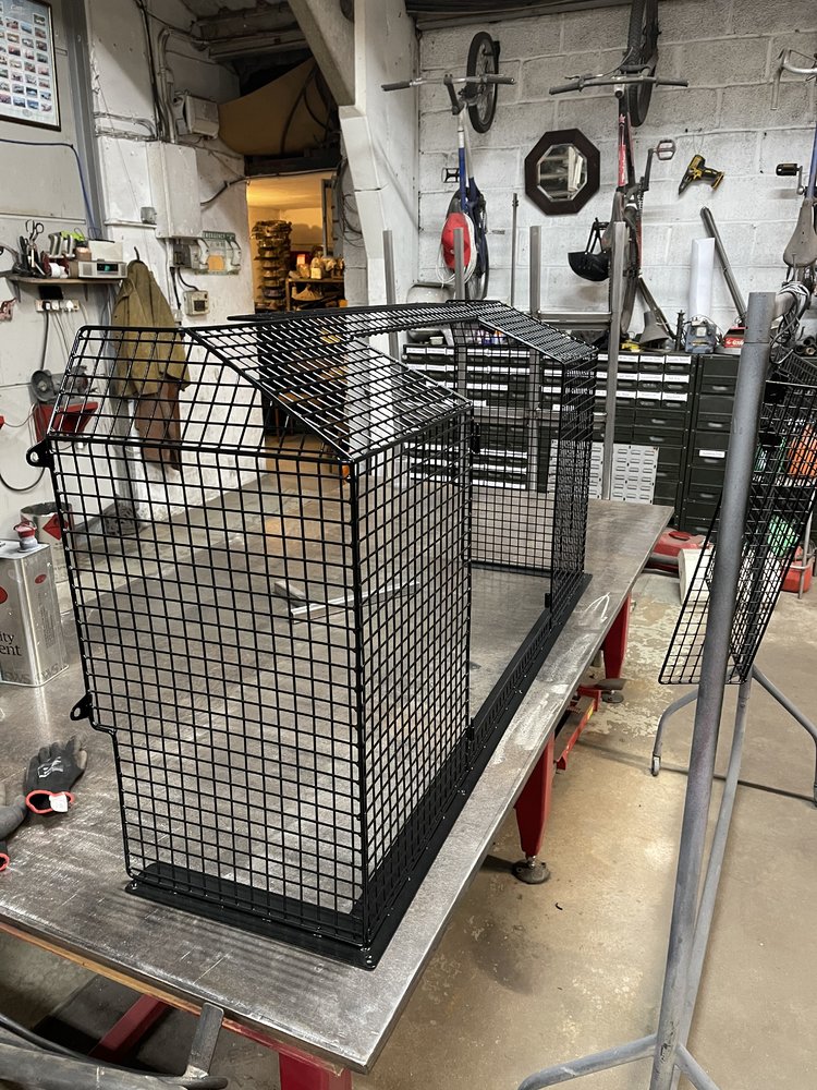

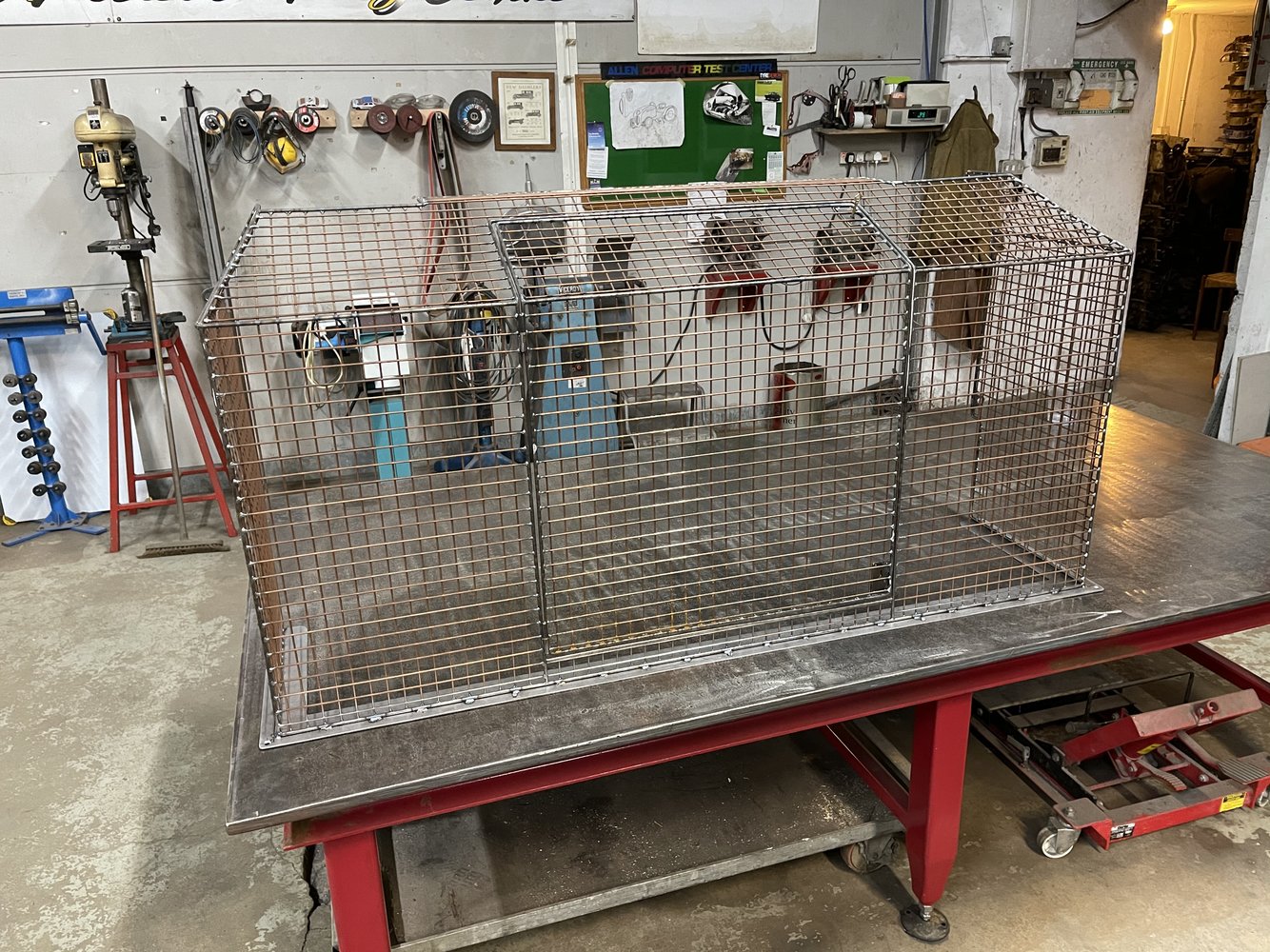

Here’s one I made last year.
