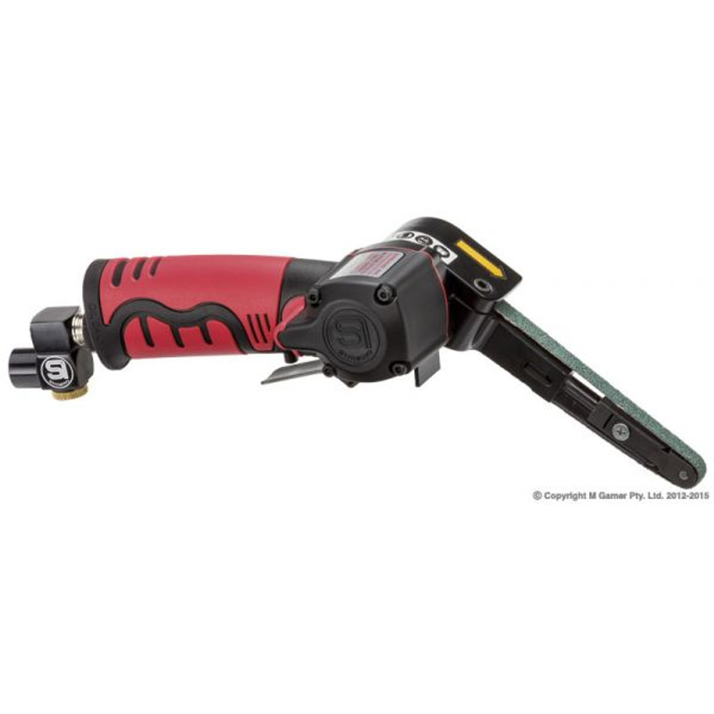

I have an old B&D one, it's brilliant on fibreglass. I've used it on steel a bit, but it keeps spitting belts off for some reason, breaking at the glued joint.Anyone got any views on if these are useful or not.
I have an air one somewhere but can't find it.
And I seem to remember it was pretty knaff.
Any advice welcomed..
