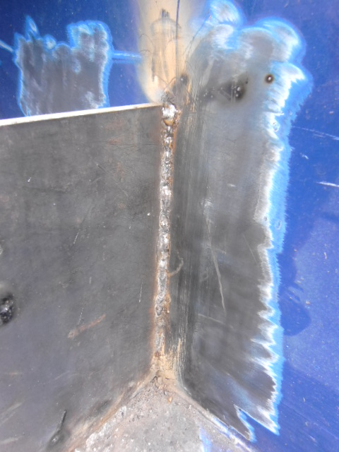

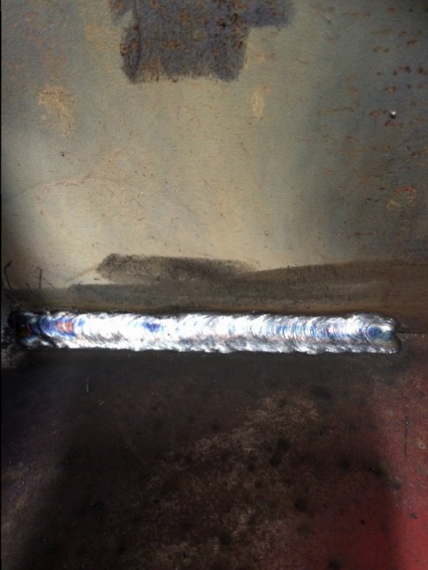

I'm not much of an arc welder tbh I don't do enough of it to justify been any good but I had a quick go at your joint today and found a 3.2 @ 125 amps to be more stable.It actually looks like a bit of arc blow is going on there on the fillet, running a cheap rod hot wont help but welding 8mm with a 2.5mm I should certainly want a good few amps personally certainly 90 or more. The difficulty is then controlling that arc at the higher amps, it needs to be kept short in the arc or it will go all flarey on you. Like I say previous faced with a poor supply I will often burn a 2.5 mm hot rather than a 3.2 cold myself, remember though I might burn a 5kg box in a week so there is a bit of practice going on
Now a 2.5mm on a straight drag just wont put in such a wide bead as you show in the pictures so you are weaving, don't! just stick it into the corner and come straight back at a good drag angle with the "tight short" arc aimed middle for diddle into the joint. Once you have that build the multi pass you intend all straight drag.
3.2mm is more suited but you set might not burn them good on your set your going to need 120 amps give or take, hard to say because rods, set, material, position all matter on setting up. On the old turn wheel sets I shouldn't even bother looking at what it says much personally just act on what you see
My results at top and as I say I'm not an expert by any stretch so you might have more joy with a bigger rod. I did.
