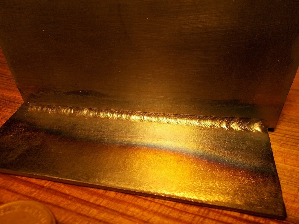

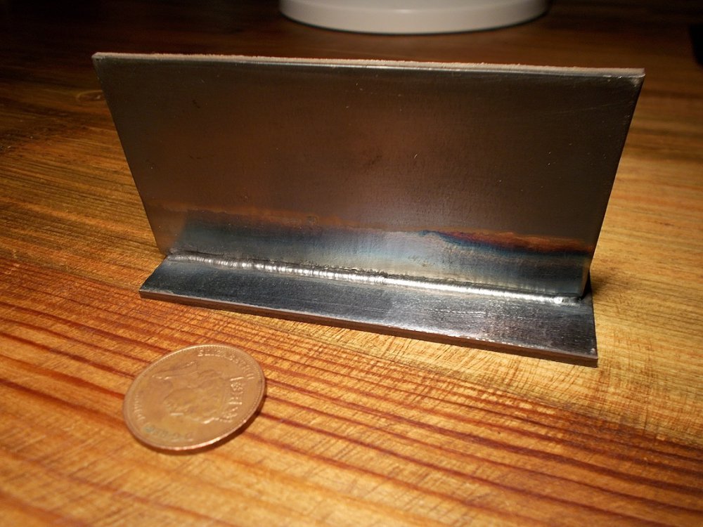

I am just starting to teach myself tig welding... I have a dc r-tech, and I am currently trying autogenous fillet welds (no filler).
Most of my work is not structural but needs to look nice, so my plans are eventually to run an autogenous pass or a few tacks to secure pieces together, and then tig braze over the top of this with a silicon bronze rod. Sadly I cannot try the silicon bronze rod yet as I was sold gas brazing rods by BOC, and everywhere is closed until january...
So my question regarding autogenous fillet welds... I am finding that all seems ok when I do the first side (sorry I wire brushed it at the time to check it over so most of the heat zone is scrubbed). Then I flip the piece around to do the other side and it seems to be a lot messier. I am deliberately trying not to get full penetration on the first side so that I can make the other side match. I've attached two images to illustrate. My arc gap got too wide by the end on the back, but I''d kind of given up by this point as I could see it wasn't going great.
Is it a bad idea to try this on both sides of a fillet?
