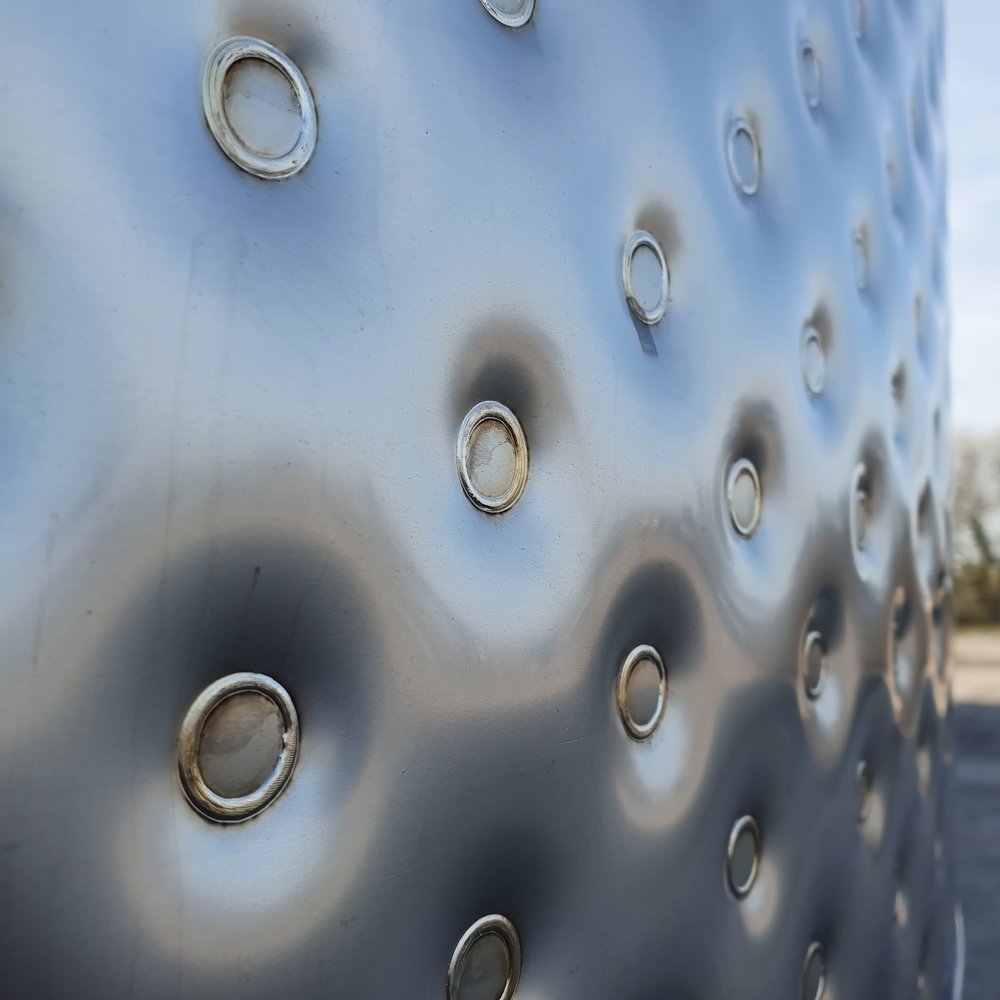

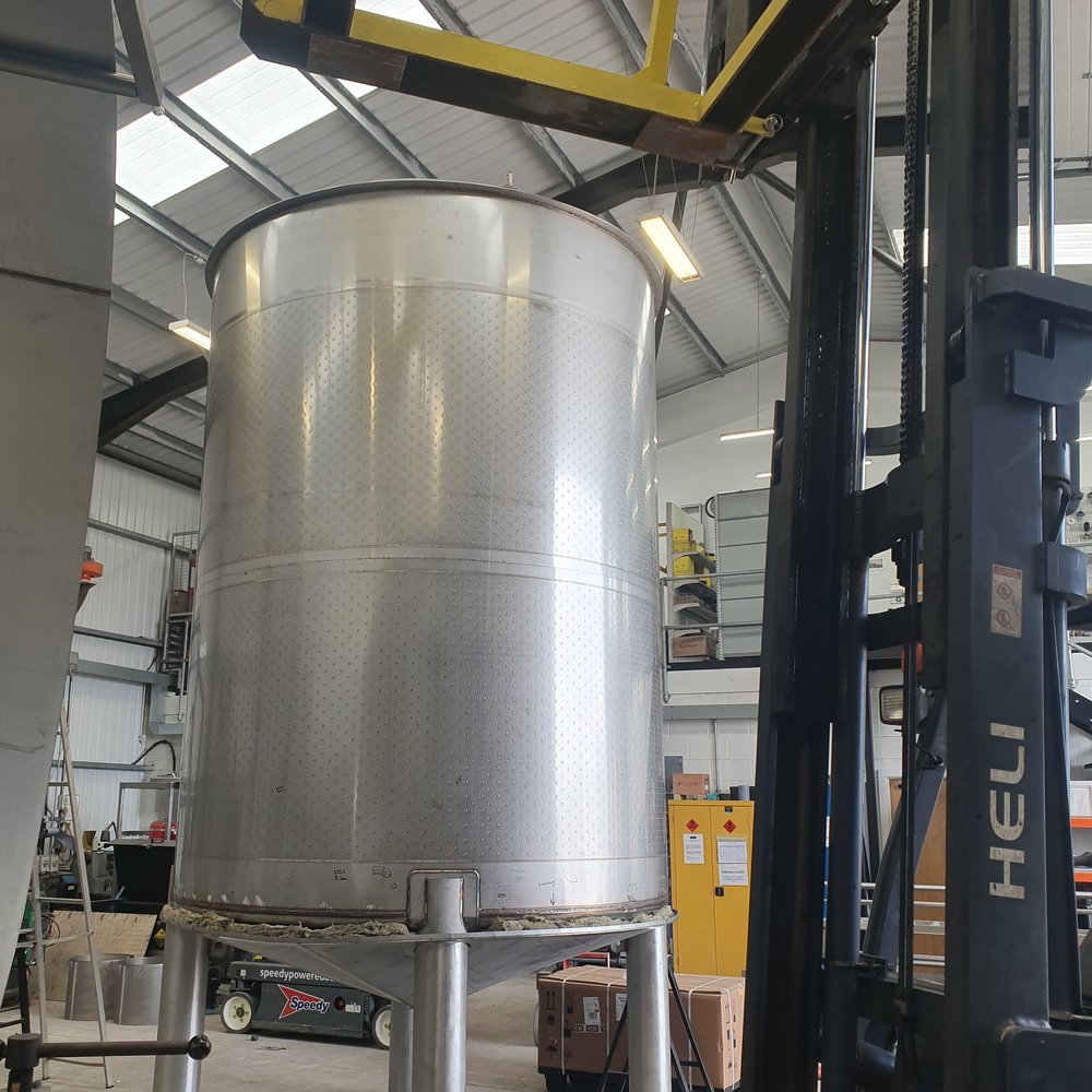

Is it a heating/cooling jacket? I've never seen anything like that.This is laser welded...flat sheet about 0.9mm(ish) welded to 3mm. Inflated after rolling etc, so pretty strong I'd say
View attachment 355811 View attachment 355812

Yes, exactly that.Is it a heating/cooling jacket? I've never seen anything like that.
With such a wall thickness, there should be good stiffness. I will remember this trick, thanks.Yes, exactly that.
