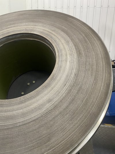

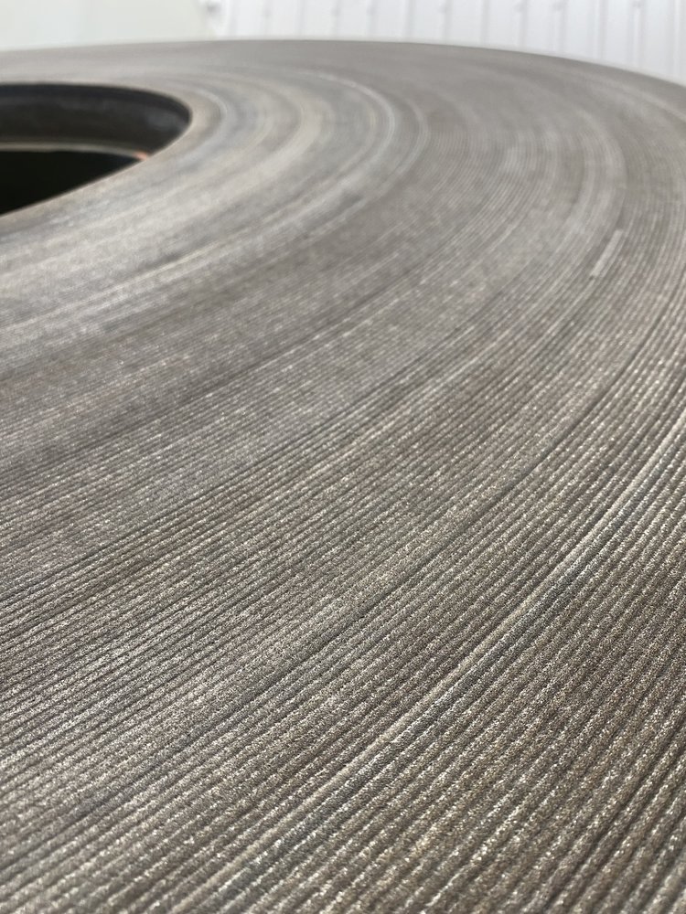

Ed China tried one out:I want one + and laser cleaning device![]()
Not all they're cracked up to be.
I do not know what he tried, but less than 1 kW of laser source power - IMHO these are toys. The Germans did "cross-hatching" with a laser beam 10 years ago at a price of ~ 100K, and the Chinese made the first cleaning machines with horizontal scanning, which reduced the quality of cleaning. The technology of deflecting mirrors was then primitive in the Chinese version. But that was 5 years ago. Progress does not stand still.Ed China tried one out:
Hi Sergei, I think the problem he highlighted was that, in the example of large scale laser cleaning, you are better off in terms of both speed and cost, simply media blasting. Agreed, tou have no media to deal with after Laser cleaning, but it is still only line of sight and still today, very expensive and slow.I do not know what he tried, but less than 1 kW of laser source power - IMHO these are toys. The Germans did "cross-hatching" with a laser beam 10 years ago at a price of ~ 100K, and the Chinese made the first cleaning machines with horizontal scanning, which reduced the quality of cleaning. The technology of deflecting mirrors was then primitive in the Chinese version. But that was 5 years ago. Progress does not stand still.
less than 15K for a 1 kW welding machine with a wire feed option, already something. Yesterday it was unrealistically expensive. I remember offers for 50K, then the price went down to 30K. And today my local manufacturer offers a price of about 12K with a guarantee and service for the welding machine. The guys are engaged in Chinese solid state lasers and build large 2D cutters for metal from them and so on.Give it a year or so and the Chinese will be sending them over by the container full at £199.00 each![]()
To clean car frames, hull from shells, need a different power of the radiation source, IMHO.Hi Sergei, I think the problem he highlighted was that, in the example of large scale laser cleaning, you are better off in terms of both speed and cost, simply media blasting. Agreed, tou have no media to deal with after Laser cleaning, but it is still only line of sight and still today, very expensive and slow.

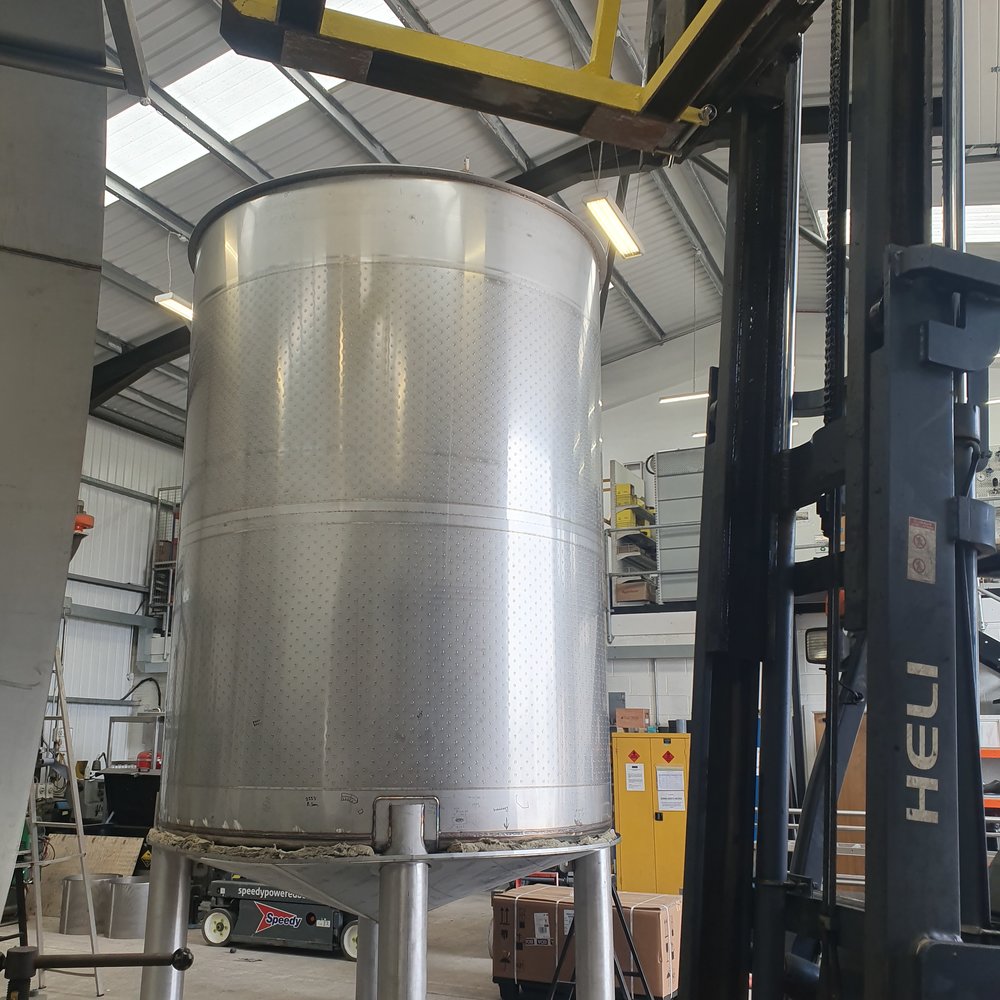

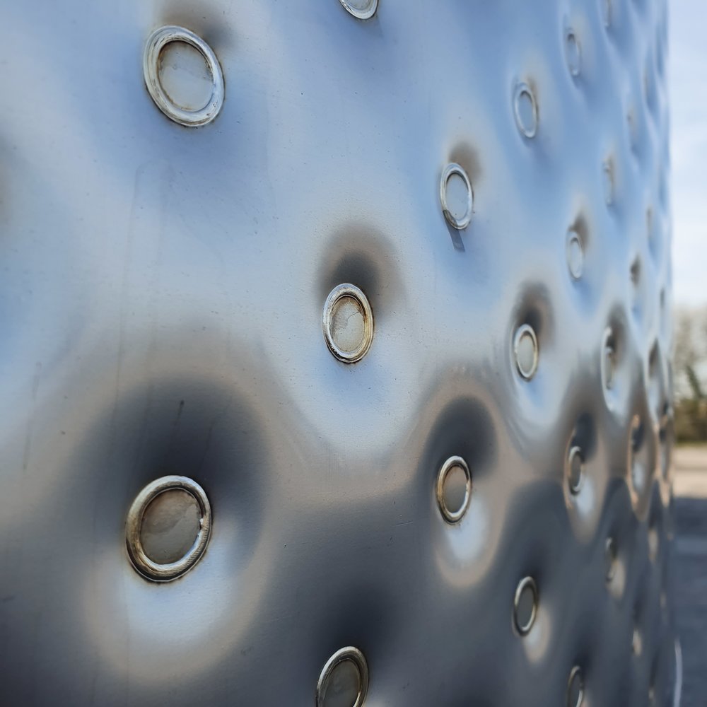

]Is it a heating/cooling jacket? I've never seen anything like that.This is laser welded...flat sheet about 0.9mm(ish) welded to 3mm. Inflated after rolling etc, so pretty strong I'd say
View attachment 355811 View attachment 355812

Yes, exactly that.Is it a heating/cooling jacket? I've never seen anything like that.
With such a wall thickness, there should be good stiffness. I will remember this trick, thanks.Yes, exactly that.
