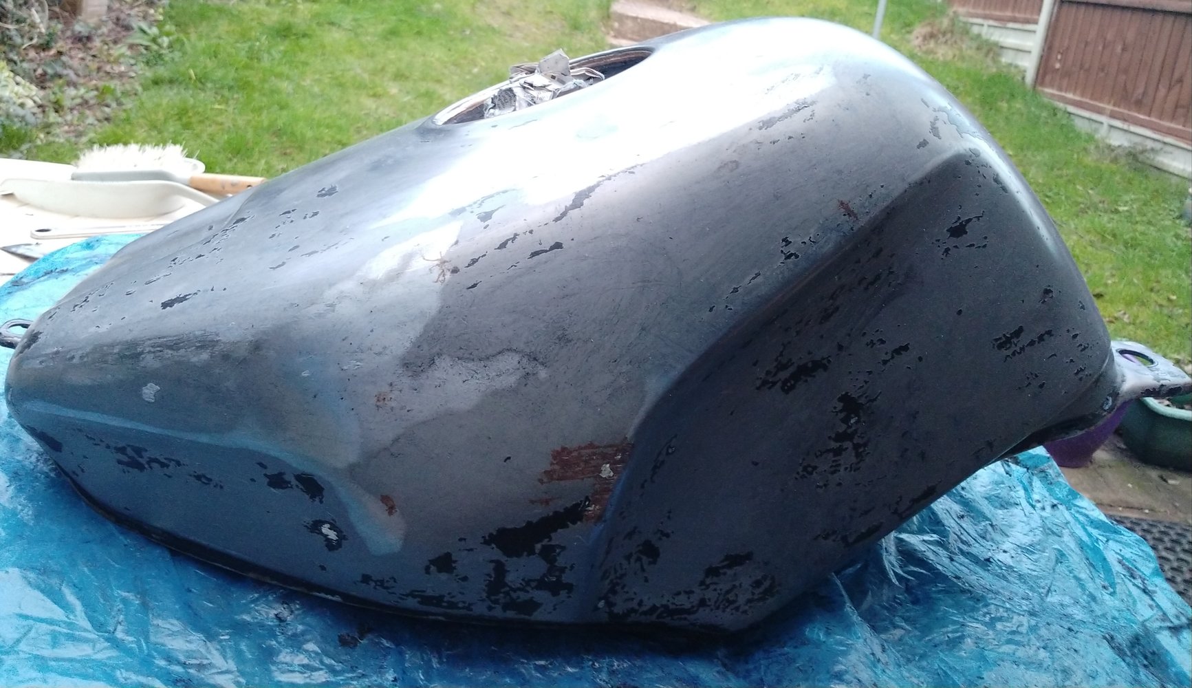

Interesting, I'd always assumed it was all of a muchness. Just making up words this evening.Looks the same, smells the same, mixes the same but that's where sameness ends. A cheap filler will pinhole and be so hard it's a mare to flat
It's a finer filler the better stuff & it sands/finishes betterIt's all similar isn't it?
Quite liked using Plastic Padding Ultima
Adhesive epoxy is available with 5 minutes or 90 seconds hardeners, is it much different to filler resin? Looks like 3m do one for 50 quid.I think the issue with an epoxy filler would generally be the cure time
It goes off, rarely lasts twelve months in my experience.
+1, I had a packet that was fine for 5-6 years as well. Great stuff and really easy to useIf you are doing surface blemishes, Dolphin Glaze is the correct product to use.
