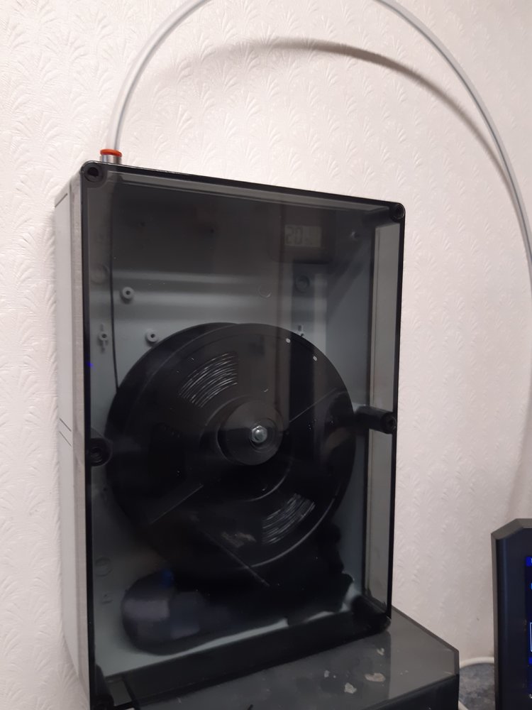

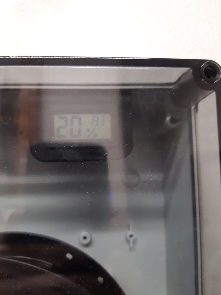

Anguz Forum Supporter Messages 2,059 Location Northamptonshire Oct 22, 2022 #1 Scrapped a terminal box at work... 1 hole wrong Turned it into a box to keep my filament in use dry.. desiccant in the sock and humidity sensor as well Seems to work.. the tube is 8mm bore
