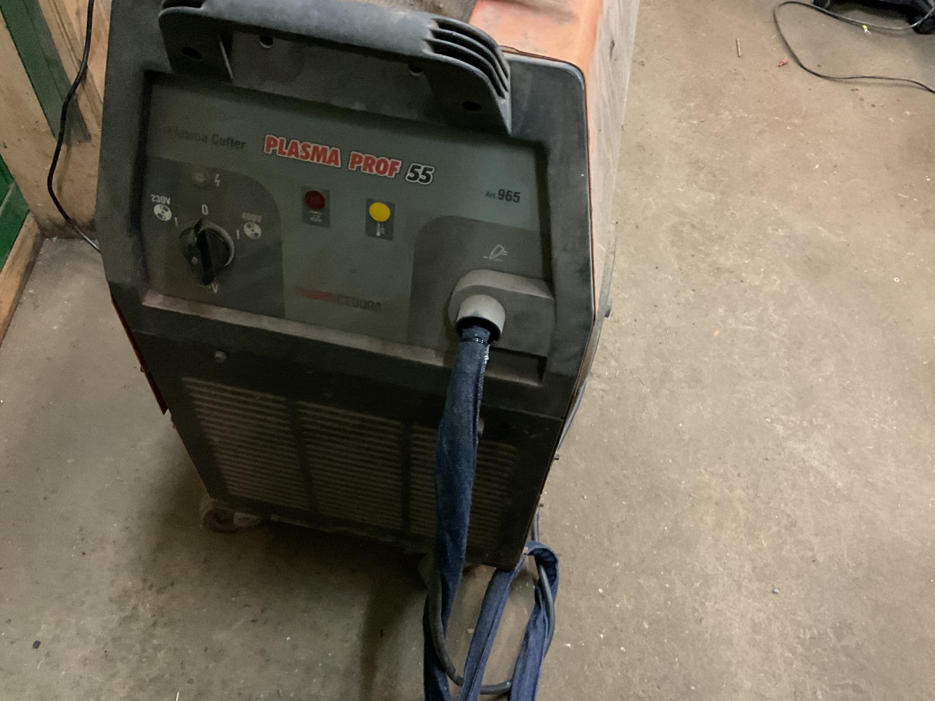

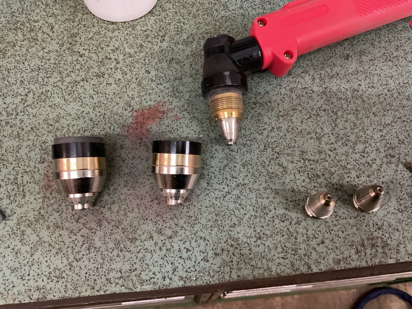

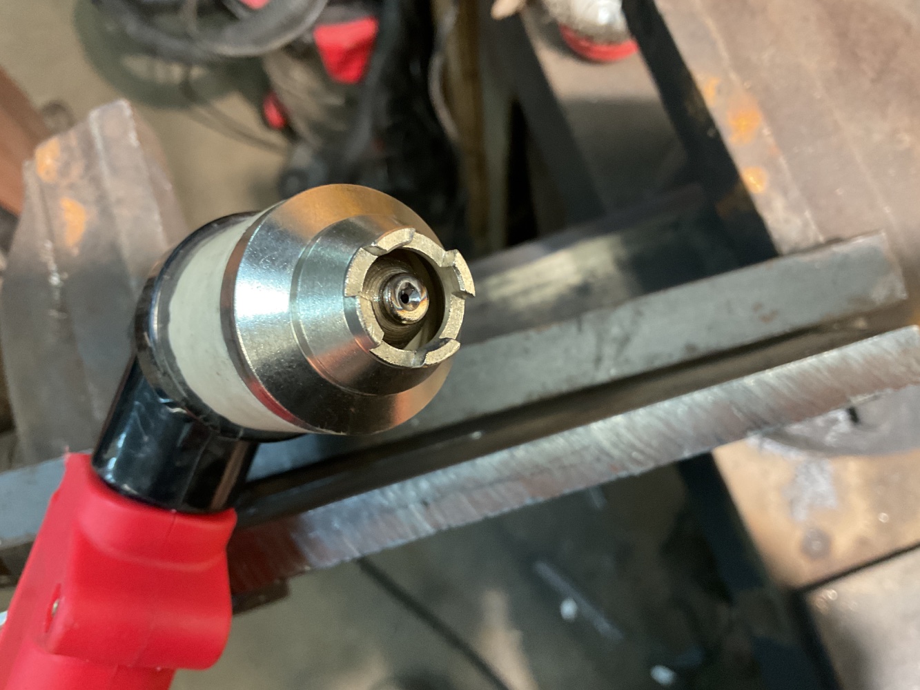

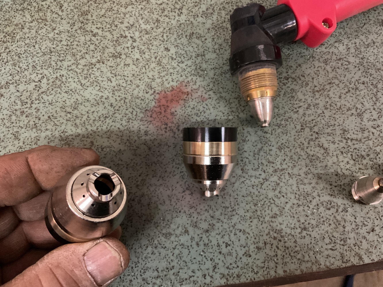

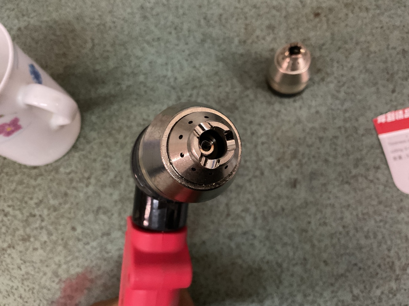

Had this prof55 for years, died a while back and was pushed under the bench. It resurfaced last week so fitted a new P80 style torch and away it went. Thought I would try and dial it in so ordered in from Amazon a drag shroud and some different nozzles.

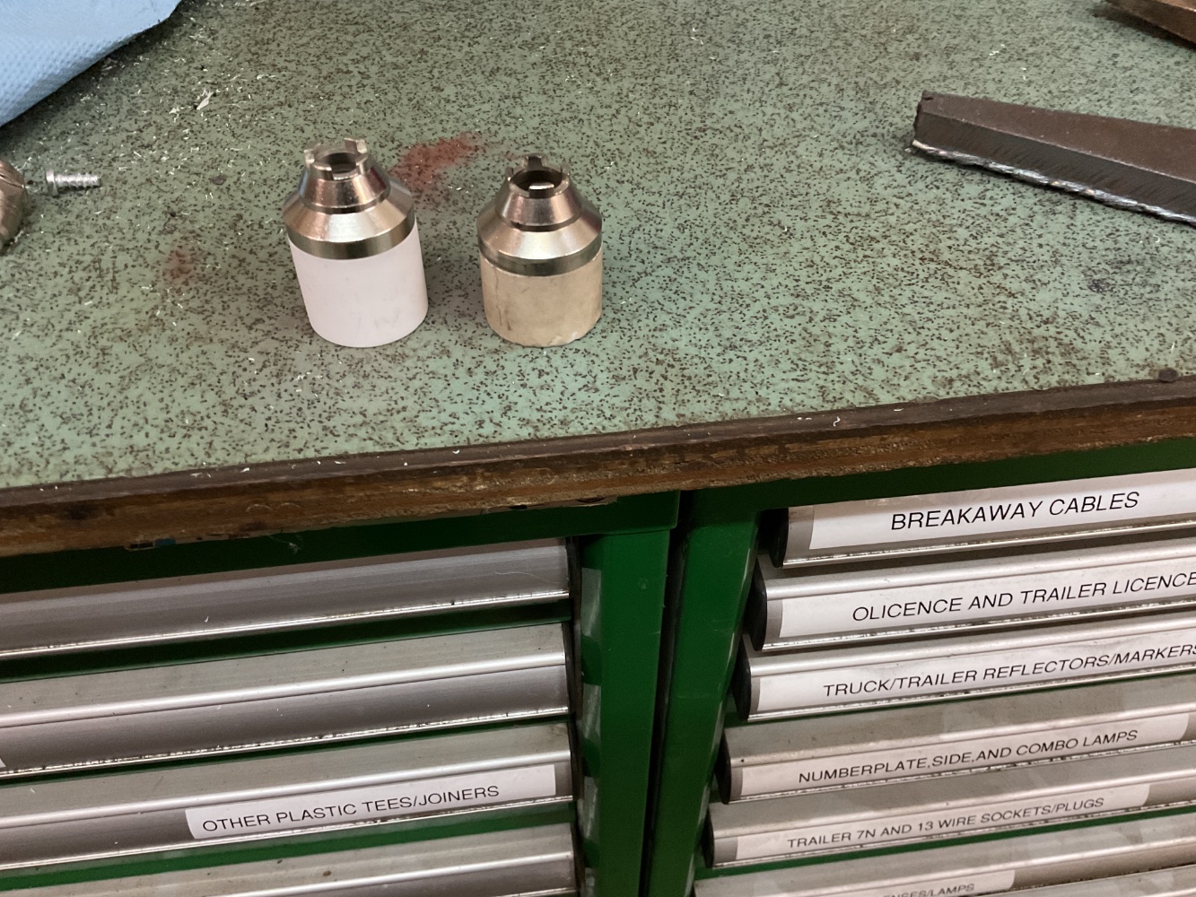

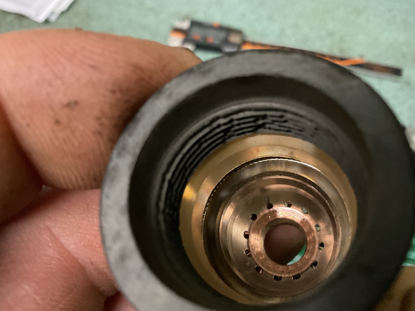

The drag shields were a bit too long and they snuffed out the arc so I trimmed off some of the insulator to lower the tip.
Tip now sits about 4mm off the work.
Vs

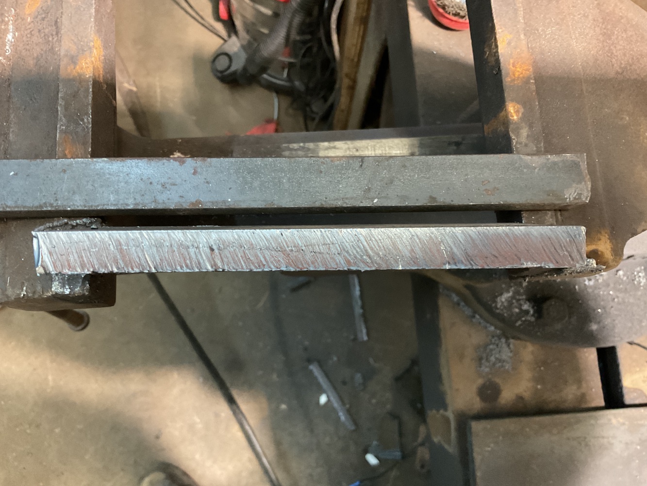

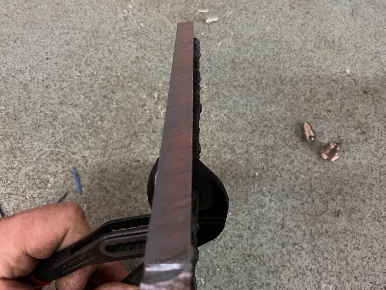

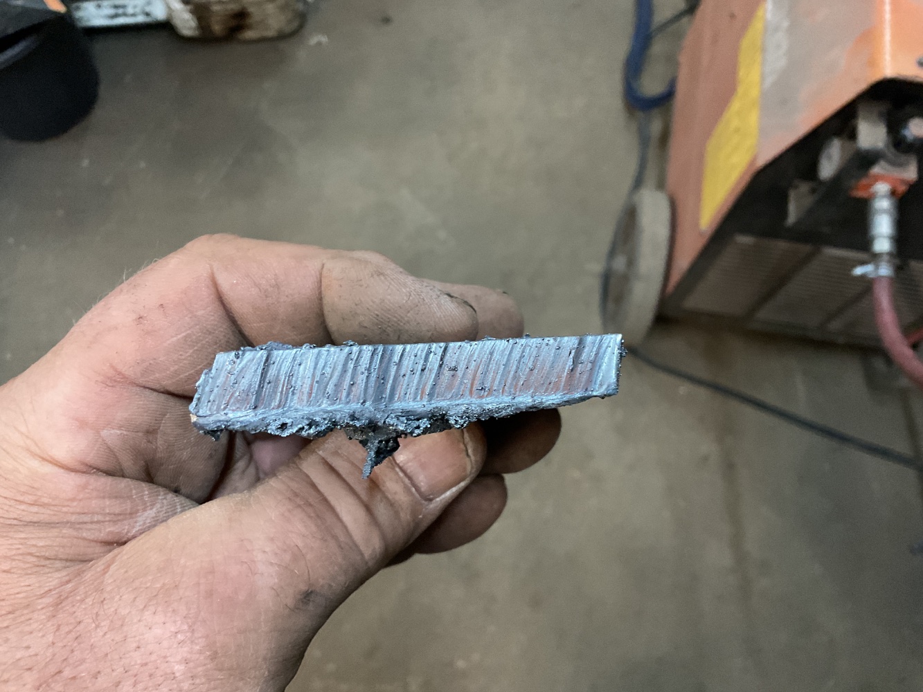

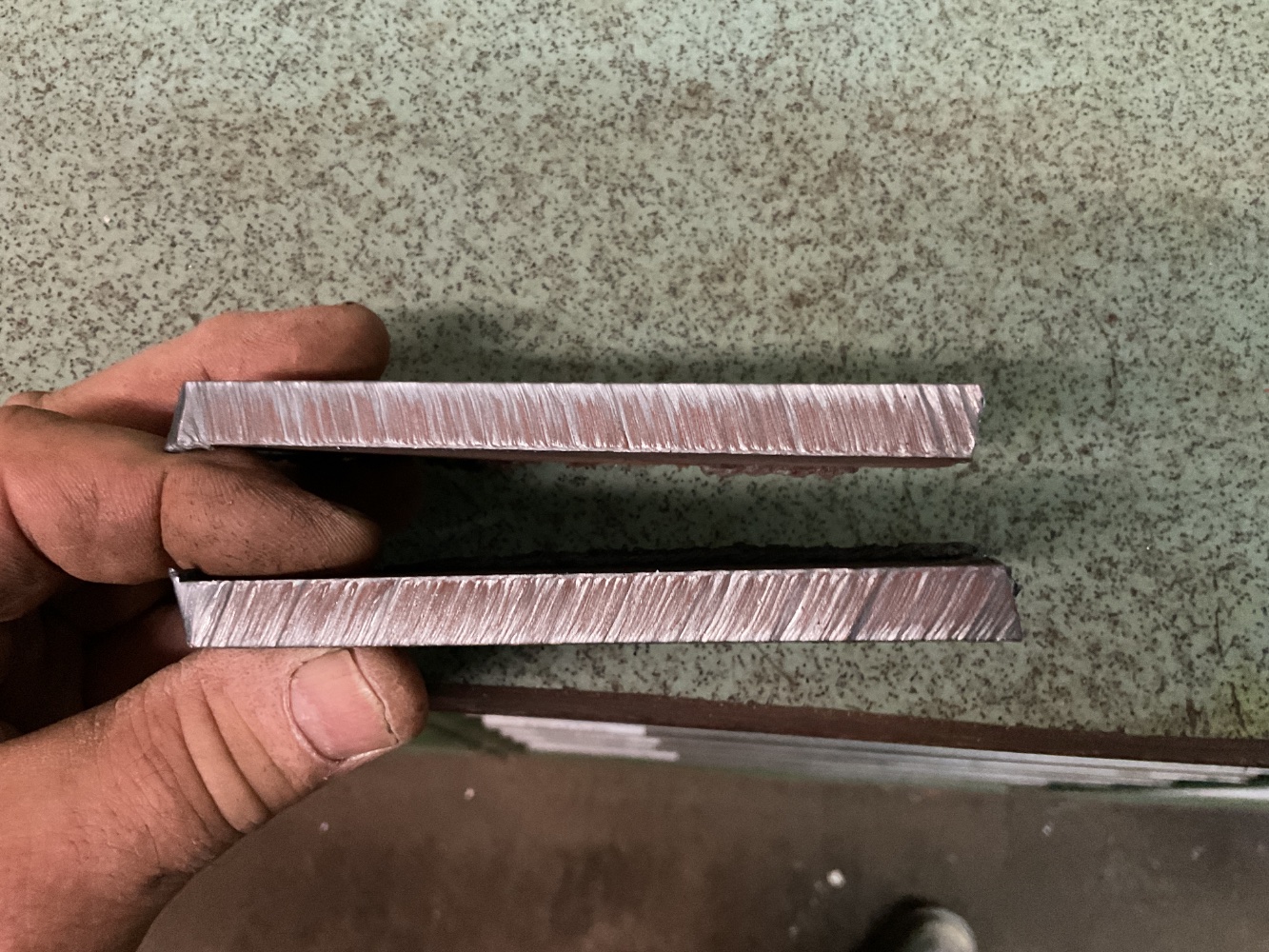

Best I could do with the drag tip out of the box was below and the kerf would need attacking with a grinder.

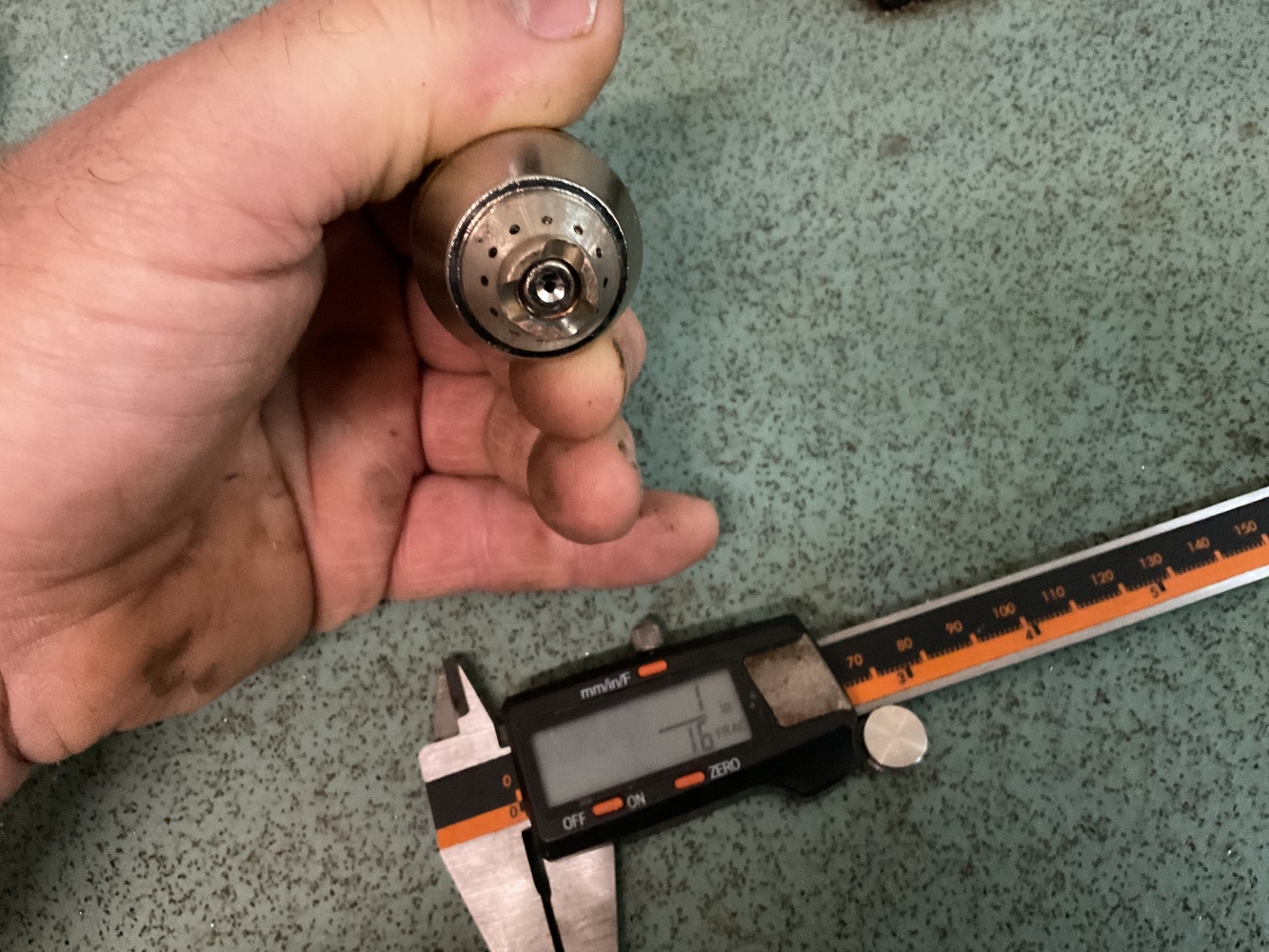

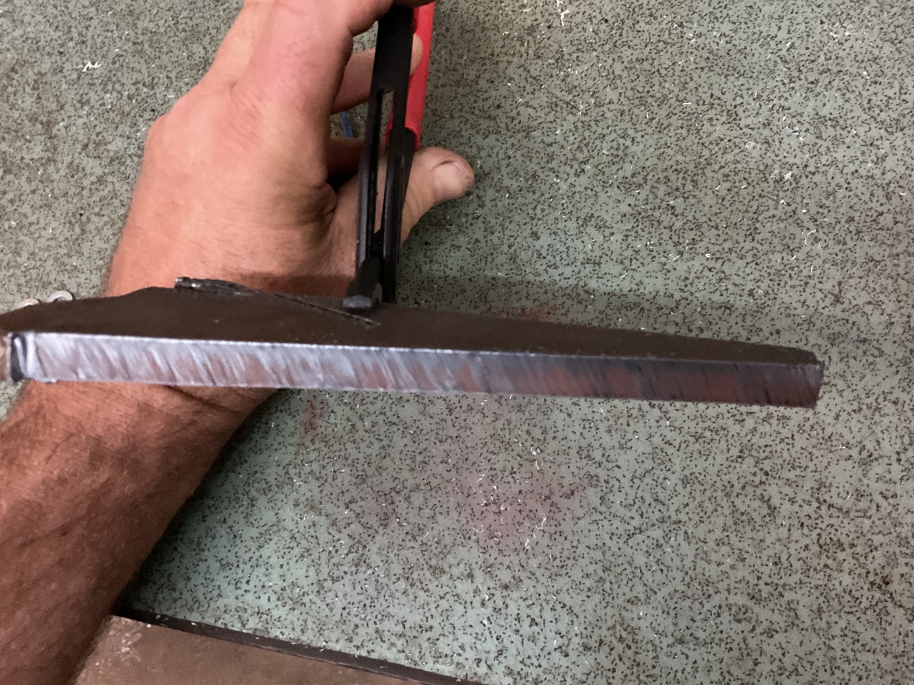

Dropped down a nozzle size to 1.1mm, messed about with the air pressure and using the modified shroud it does this, kerf taps off. Still a way to go yet but it’s getting there.

...... all I can say is that when I use this cutter now the pressure appears to be 50/60 psi depending on the nozzle size I fit.
