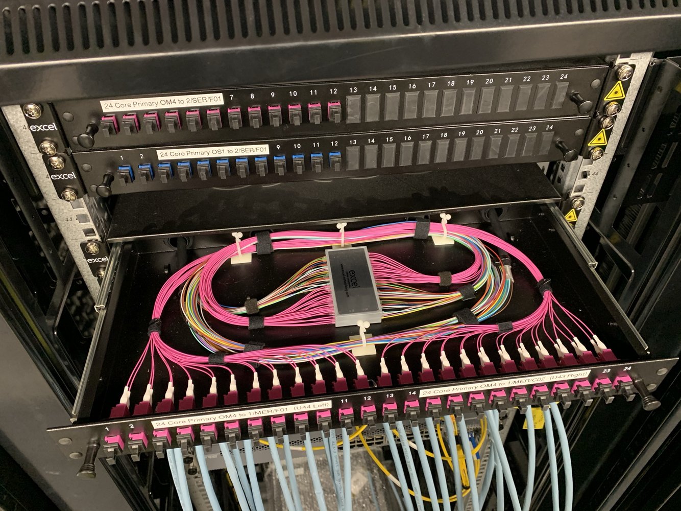

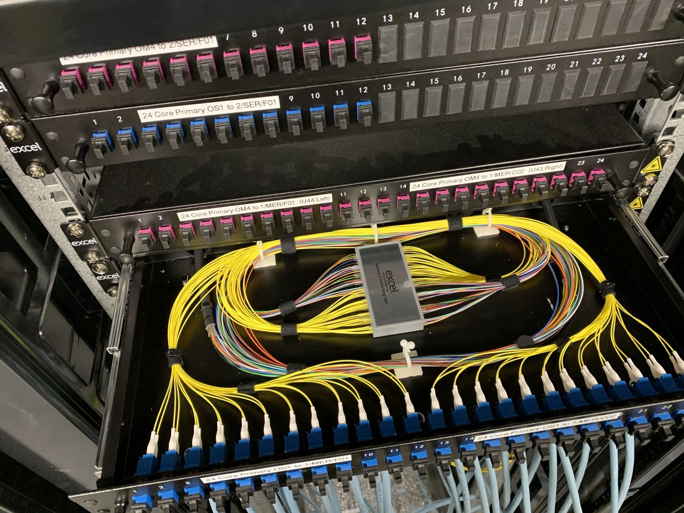

Om3, some muppet has damaged one end of a multiform. I don't know exactly what at the mo as I'm not on site.
Will probably have to repair several cores. Are the mechanically fixed ends any good? Or do I really need to get them welded and polished?
we used to use snap crimps you put the cut ends in the gel crimp line them up snap them it makes a join (not very good this would depend on the lenth of joint and you would need to cut using a tool so it cuts strieght)then the gel filled the gap to join to make the conection the loss with these os quite a lot (might be better these days)No idea right now... iirc its 6 or 8 pair swa, preterminated. I knew they would break it during installation..I do indeed.
I've used Amp Lightcrimp mechanical ones before and they are not too bad, nowhere near as good as a proper end though and success rate while terminating can be hit and miss but they can get you out of trouble.
Not many people site polish anymore, you just cant match the low losses of a pigtail and splice. Do you have any other info of the damage?
Lovely neat job thereSure do, just finished up 480 SM and MM splices at Wenlock Works, London. I have my own splicer, OTDR and Fluke DTX with fibre heads.

Nice to meet Bruce today, thanks for doing a tidy job!
I'm sure you would have got it done in half the time without the questions
and yesterday we managed both!!You are more than welcome Mike, it was an absolute pleasure to meet you and happy to have been able to help out. I will take a happy customer over an early finish any day of the week![]()
