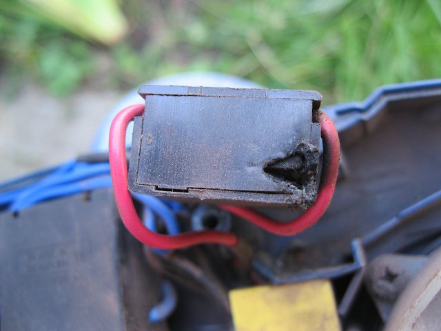

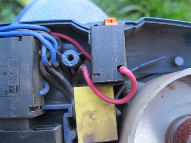

Of late I noticed my sander seemed to change speed randomly. Opened it up and saw the speed controller has some damage.
Found a replacement part here but thought someone maybe able to recommend any alternatives that are feely available?
Or; Can I just chuck the speed controller and wire the two tails together - I only use full speed anyhows?
Go sit on the naughty step until you're told you can come back.....
took the controller out joined the wires together and 5 years on had no problems since. although a slightly slower speed would be usefull i'm willing to put up with it for now!
