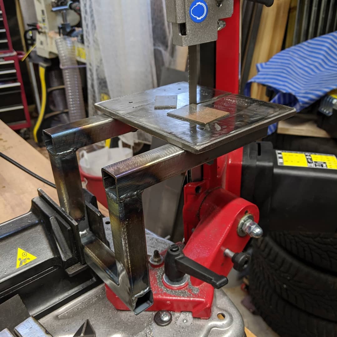

I may well have posted this here before but last year I made this platform for it so I could use it as a vertical bandsaw:

That's simply genius
