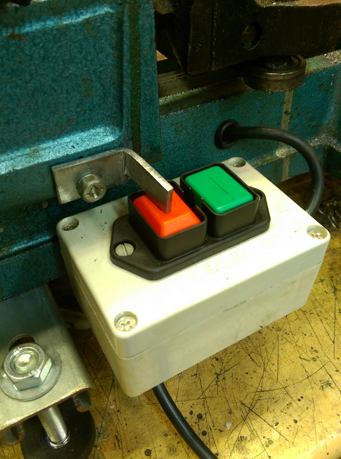

Do the auto ones not also have variable down feed where the manual ones need hauled/held up as you cut?
Does it physically pull itself down? I thought it was more than just a switch to turn itself off. I was certain it pulls down but everyone on here has me questioning myselfIt's not essential but I have to admit I like watching mine saw through something then turn itself off. It's one of the most engaging and relaxing tools I have!
Probably just needing a new limit switch.

Watching that vid you posted Kim the saw just cuts under the weight of the bow. There is no damper or feed control it just rests on the material and cuts through. So be careful with selecting your blade pitch particularly with thin gage box etc as it will literally rip its way down I'd imagine. A cut off switch in this case would be an advantage because you can just fill the vice and let it do its thing. Come back to it in 5 minutes to find your off cuts in a pile and the saw shut down.
