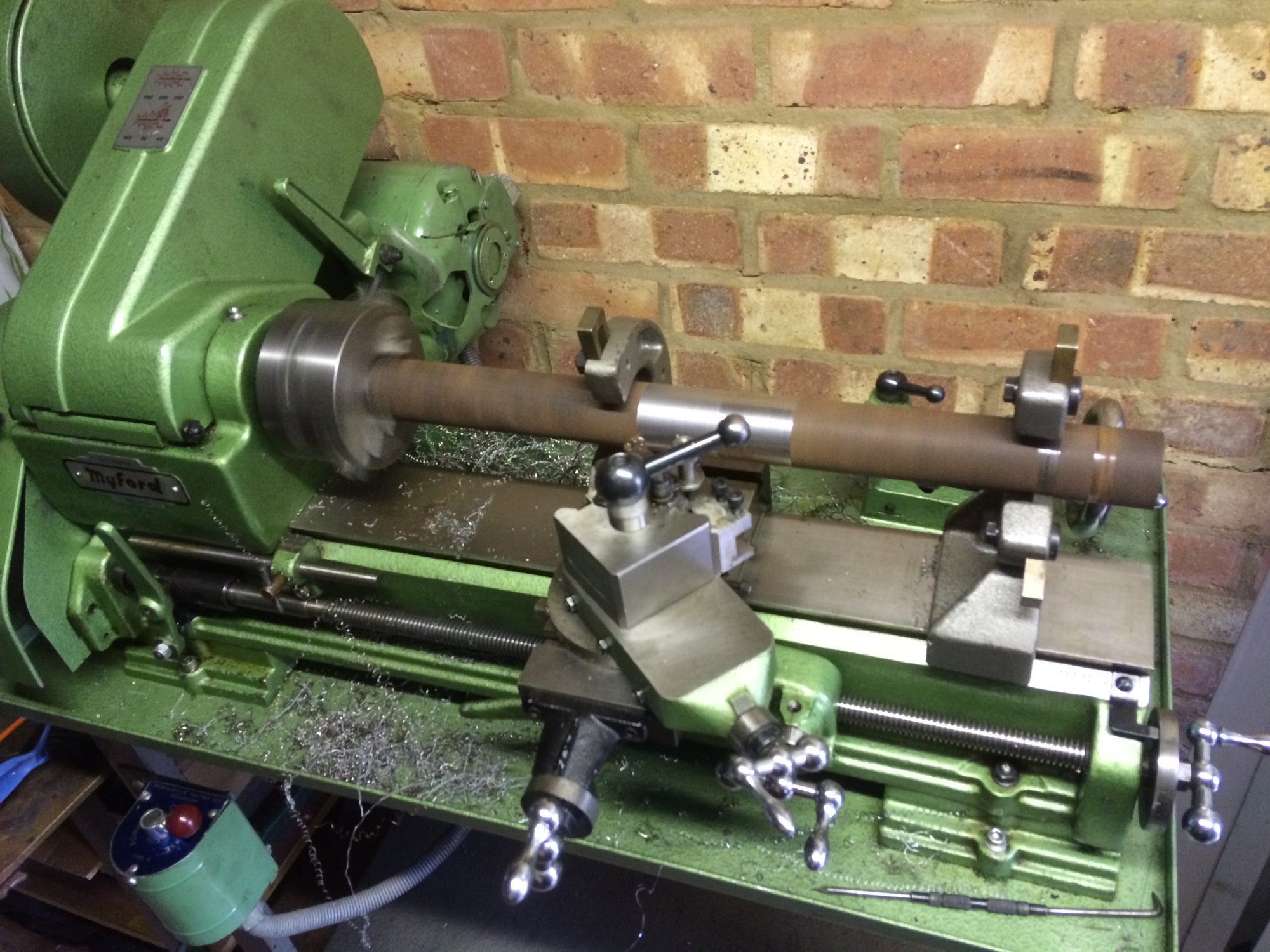

Cheers mate. Yes I can imagine even the tiny ones can snap back if you get sloppy with em. Been experimenting with length and cutting speed. That bar was 437 long and I could machine it's full length with a turn around. That's it's limit though as there was a bit of vibration through the steadys. Some tooling is needed and Id like a live pipe steady too mine is too small for pipeVery nice ,

By dial gauge do you mean DTI gauge. No I don't have one. I'm sorted with good verniersIf you have to work with a fixed steady and your material allows, you can set up as in your picture then machine the diameter a little then re set the stedy on the new clean surface. A little occasional dab of light oil.
Have you got a dial gauge or is that on your list of bits to collect.

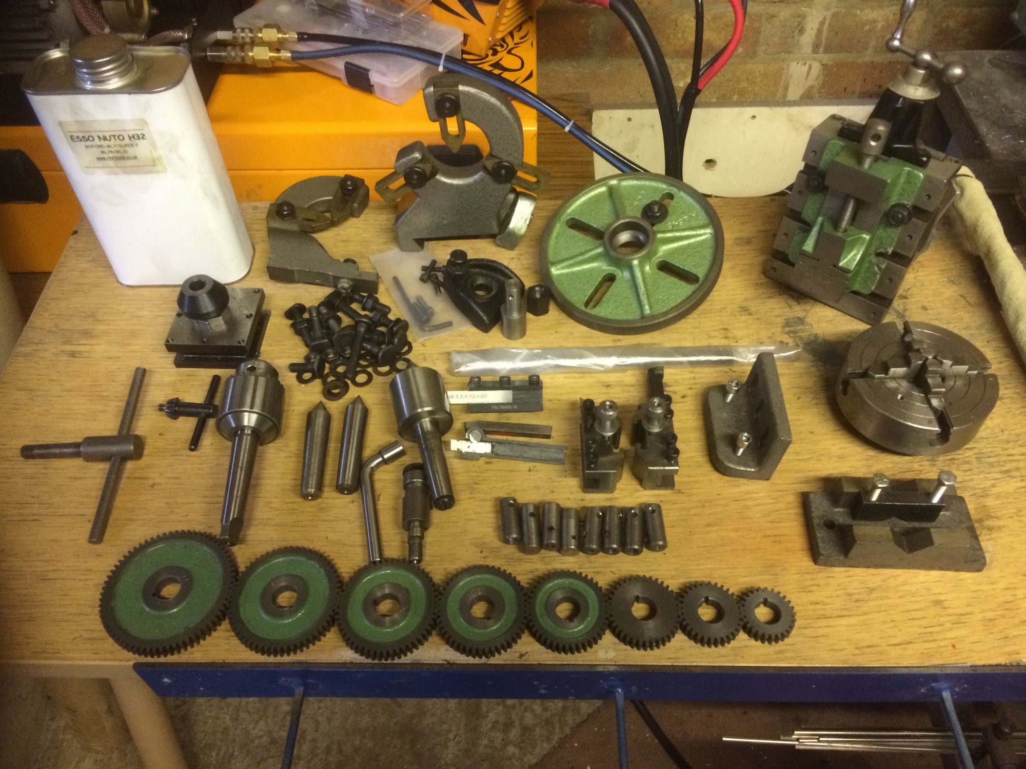

That's really good info pete cheers. I must admit I'm loving it at the mo. Looking forward to the first actual job it's needed for. I do lots of fabrication work and Id say I get parts machined only a few times a year so it's not paying for itself any time soon but it's nice to know I don't need to depend on others. Every thing I've sent out would of easily been done on this lathe. One part needed threading inside and out mind so although the lathe could do it I'm not sure I could yet. Id like to try out that milling slide at some point to see what that's about. Need milling tools first mind. Oh the list is endless.You got some nice stuff there - I bet it's going to be a while before you trade that machine up.
One bonus of a fixed steady is that so long as you use is on a true surface you can pop the part in and out of the steady and it will always run with zero runout - something you can't achieve in a 3-jaw. So if you're doing something like modifying a motor shaft or effecting a repair you can pop it in and out of the lathe without any setting up - so long as you're machining near the steady.
Cheers, yes I am pleased with it.Well done Richard , I think youve done well there ! lovely looking machine , Im very jealous now !
