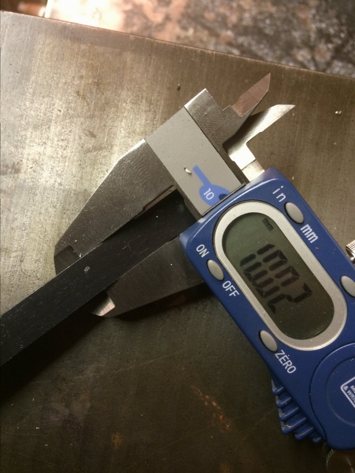

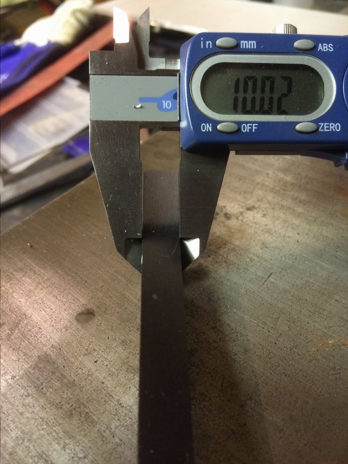

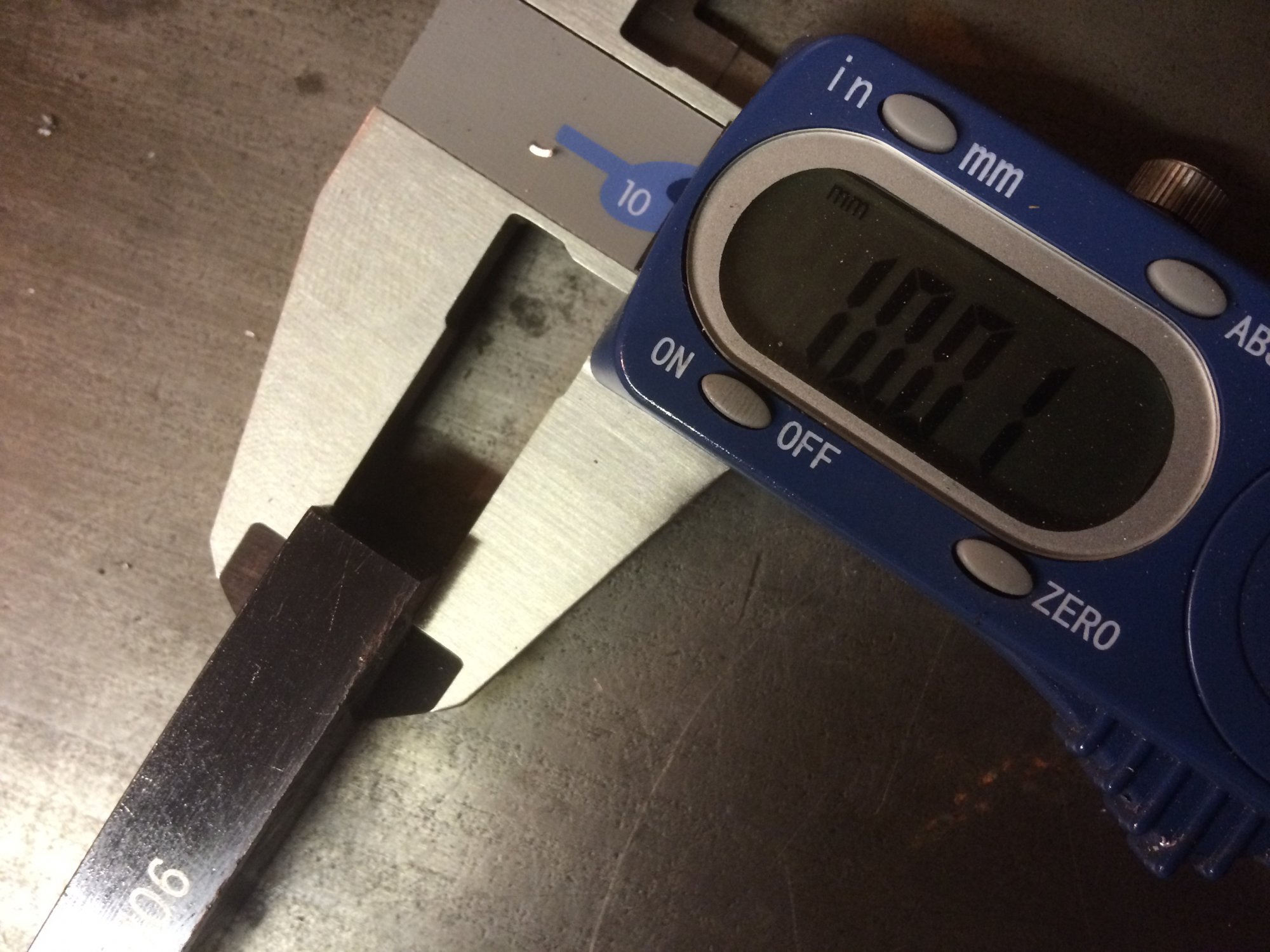

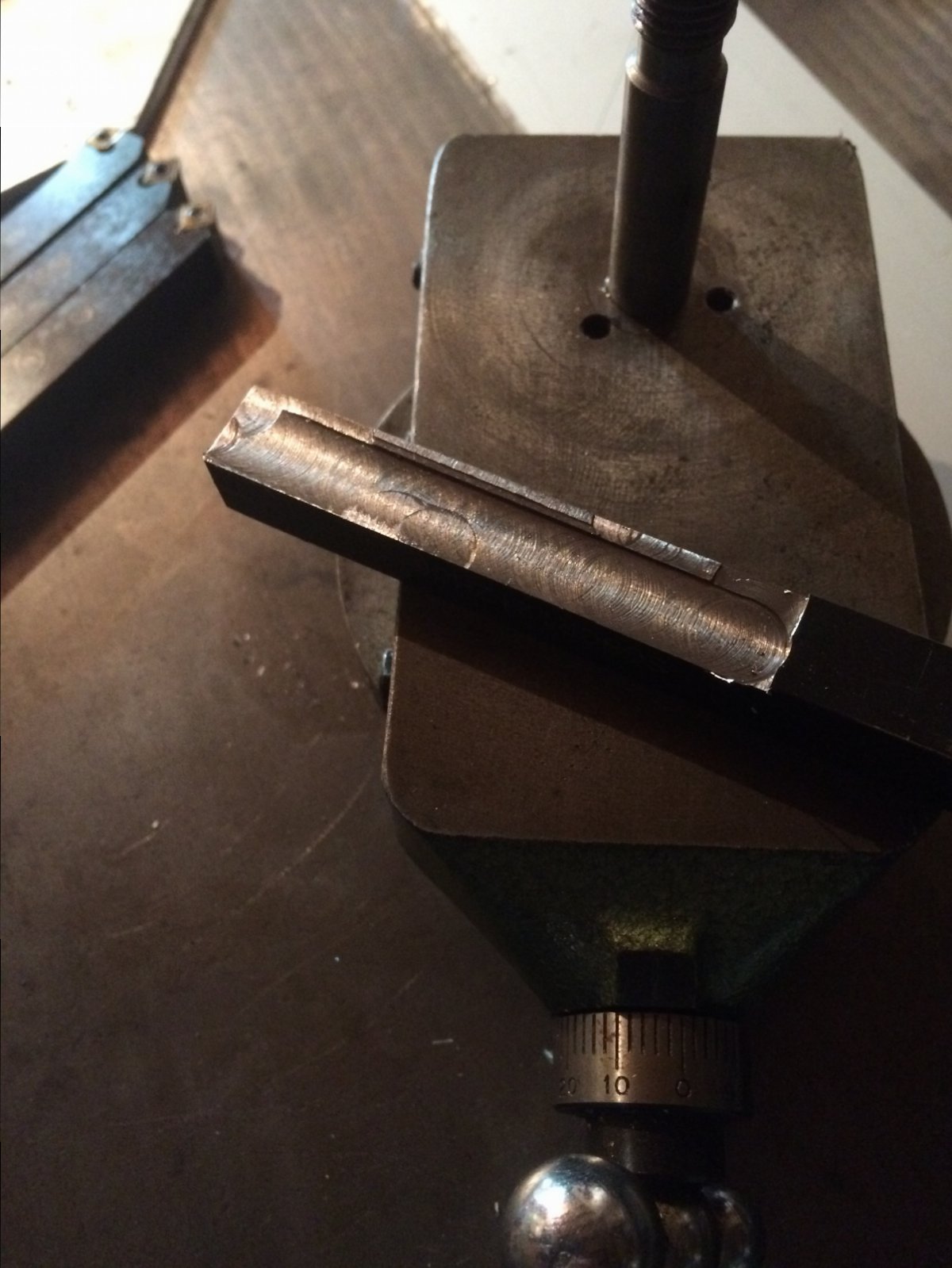

I'm trying to.You're machining HSS? Bloody fair play if you can manage that on a vertical slide. Must be hell on the cutters.
I don't think they are hss I'm not sure. They are the tool bars that hold the inserts. Matt very kindly gave me them.By tool bars do you mean bits of hss tool steel you make tools out of. If so they will be surface ground. Just visit ebay and buy some 8 mm or 10. Its cheap enough.
Cutting oil . I have coolant too for the band saw.Try one in a 4 jaw chuck, to prove if its the metal or your set up. They will be hard, but have been machined already to take the tip. but will i suspect have been heat treated in some way.
Are you using coolant, there looks to be signs of over heating.
Id rather mess up a bar than the holder. The holder is a hard steel too could be hss. They look to be a high quality one, not chancing it with those. (Thought of doing that before I started)Crazy idea time but why don't you just mill 2mm off the holders.
I don't want to grind them completely but what I think might be achievable is grind 80% of it off then a skim over so they sit flat.You need to cut those with carbide insert tooling, you'll never get through them with HSS.
In your position I'd still grind them.
I don't have a fly cutter. Will look at 4 jaw though thanks.Are you climb milling? that will give the vibration you describe. I''d also look at how the slide is mounted. It should really be pinned to the cross slide - doesnt matter how tight its bolted they will still let it move about.
Feed the work up into the cutter for the width of cut then feed the work towards you, that will be conventional milling. You want carbide cutter for doing this, and for milling a face its much better to use a fly cutter or turn it in 4 jaw.
Well after it's done 4 of these bad boys it might be due a strip down. In fairness my cutting technique was all wrong which wasn't helping. I had to take tiny cuts, fast rotation and slow feed to get the vibration out. It's strange I've worked with metals for nearly 20 years in the form of bending cutting and welding yet I'm back to square 1 with it all again. I love it.Most model maker machines dont get much use, and even less abuse, thats partly why they hold their price so well.
