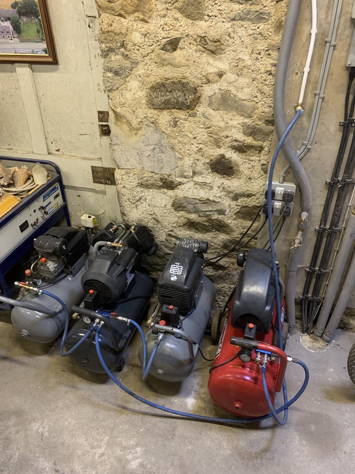

if its a 200 lt tank which is about 7 ft3 and shuts of at about 120 psi then your getting air delivery of about 6 cfm . you can forget the hypothetical 14 cfm under load you will never see that . would say its about right especially as compressor specs are usually very optimistic . my compressor takes about 6 minutes but is two compressors chained together so your timings dont sound along way off to me
The specs are 14cfm displacement, 9cfm FAD which from your figure of 6cfm suggests to me that mine isn't delivering the quoted figure? Or is FAD the wrong number to be looking at?
I run about that to 120 psi just because I cant be bothered to alter it
