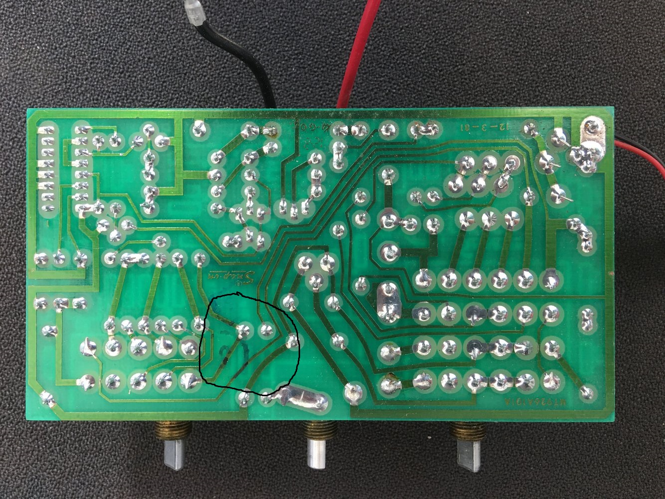

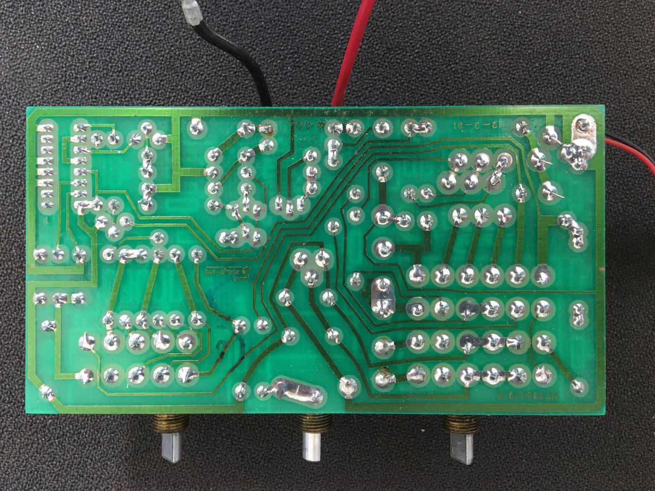

It is just ink from a Quality Control stamp. Board and all components look perfect to me

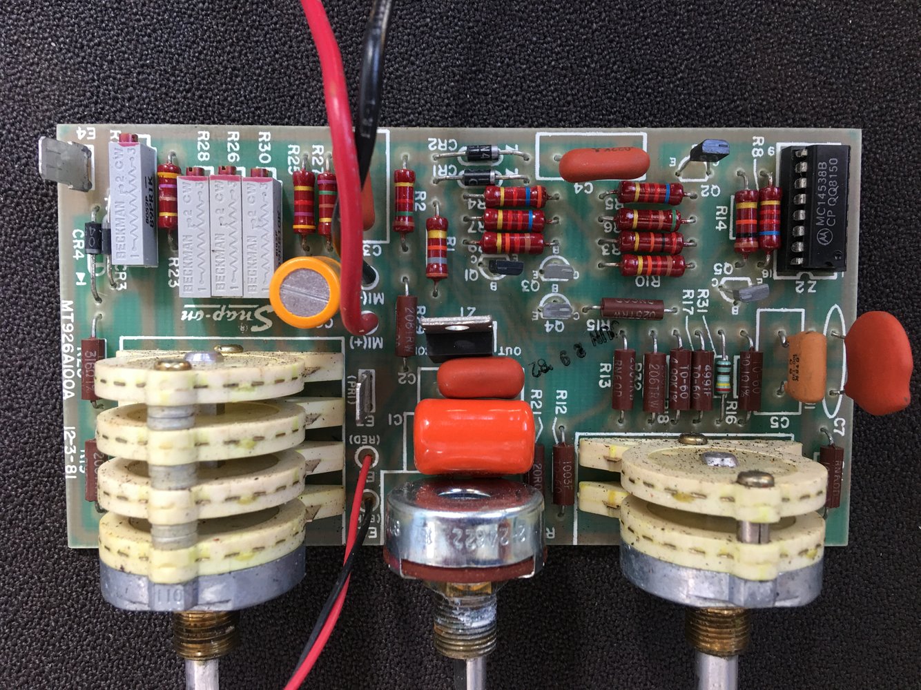

Then you are down to checking the current path, per circuit and trace it that way.It is just ink from a Quality Control stamp. Board and all components look perfect to me
The black dots just seem to be specks of dirt, nothing seems to have exploded.
thanks!
Just checked the meter, open circuit- guess it’s dead!Have you checked the meter movement as per post #6, and identified the possible voltage regulator as per post #13?
Some had a weak link, a fusible link at the end of the MCM coil. You may be able to repair that.Just checked the meter, open circuit- guess it’s dead!
