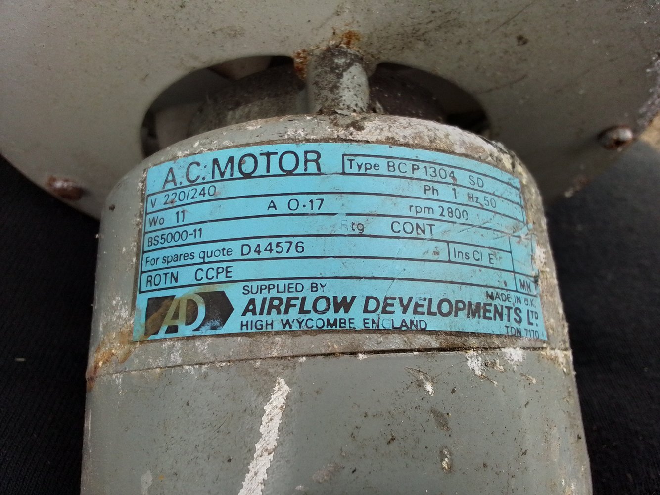

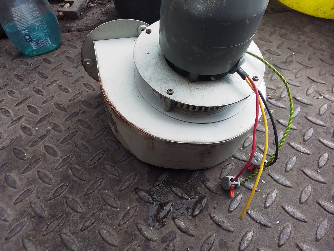

That'll want a cheap capacitor - 2 or 3 uF, 400 working volts (always more thanthe supply!) and be sure to specify *run* capacitor if ordering - the other "start" variety will do a great impression of a chaff launcher if run continuously. Likely to be connected between the red and yellow - you may find if pput between black and yellow it'll run in the other direction!
