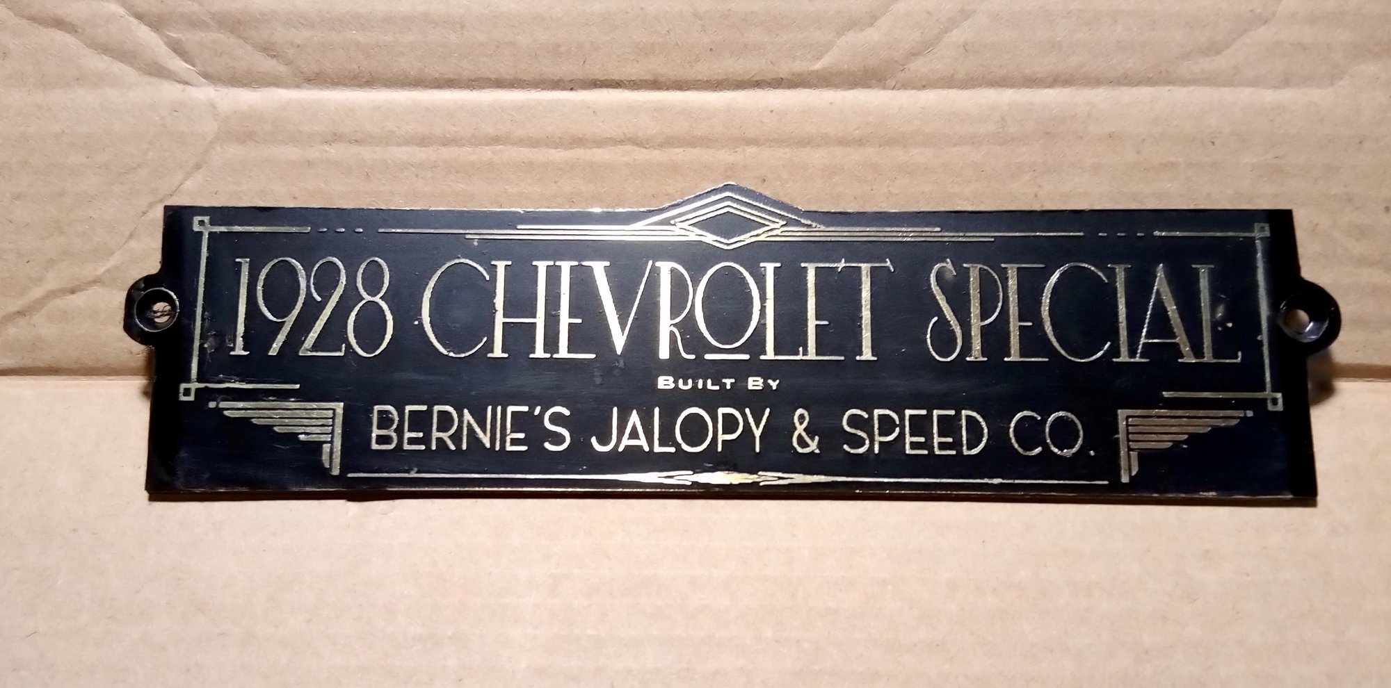

The other thread about etching got me interested and I had a go.

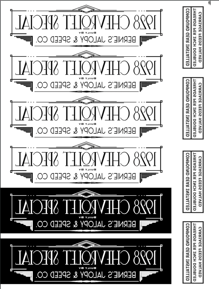

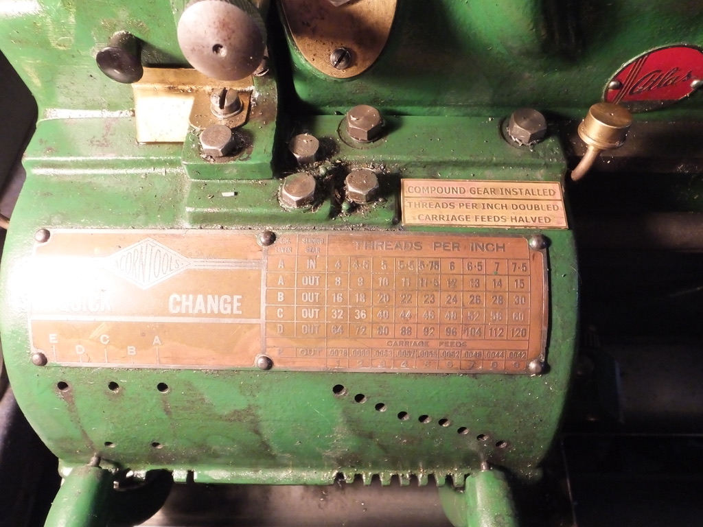

Downloaded Inkscape and spent ages learning how to drive it. As I'd altered the gearing on my lathe to halve the QCGB feed rate, thought I'd start simple and make a small reminder tag in an attempt to avoid the inevitable future confusion.

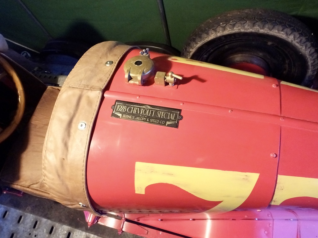

As I needed to fill the page and avoid waste I designed a period looking plaque for my '28 Chevy racer, doing this was an epic and took me all over the interweb and back, but I got it done in the end. I retrospect I was a bit ambitious with the fine lines for a first go.
A page of Press-n-Peel paper nicely filled.

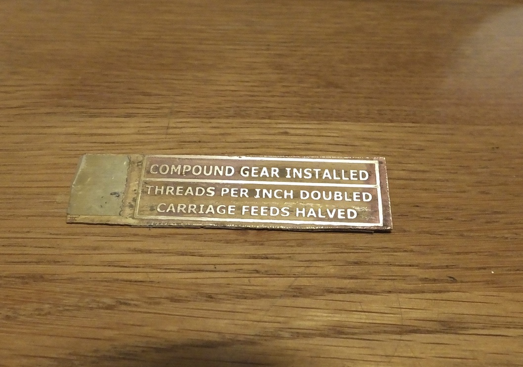

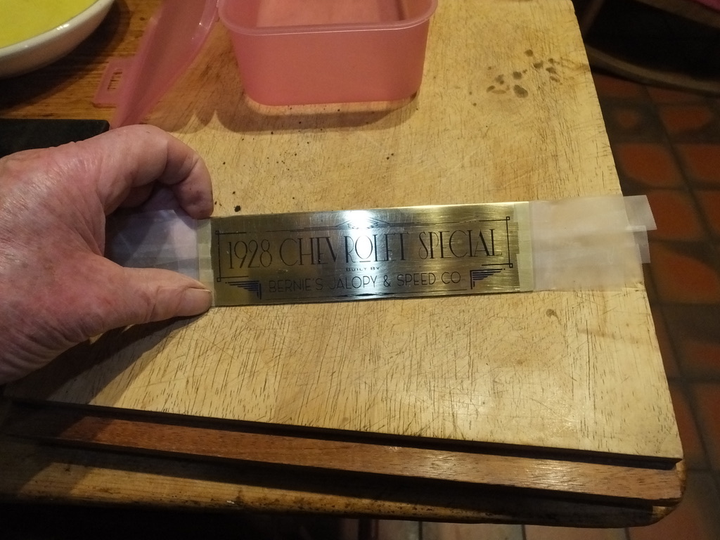

Test piece with nail varnish resist

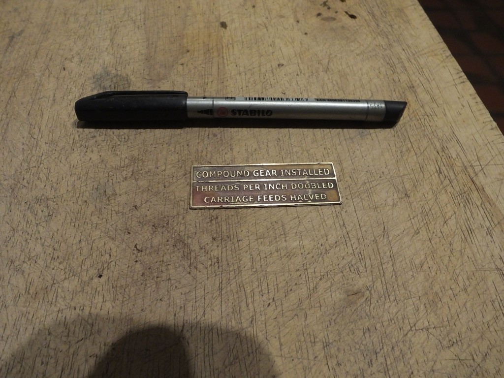

Did the lathe tag first.
Not perfect,
But looks OK in place.

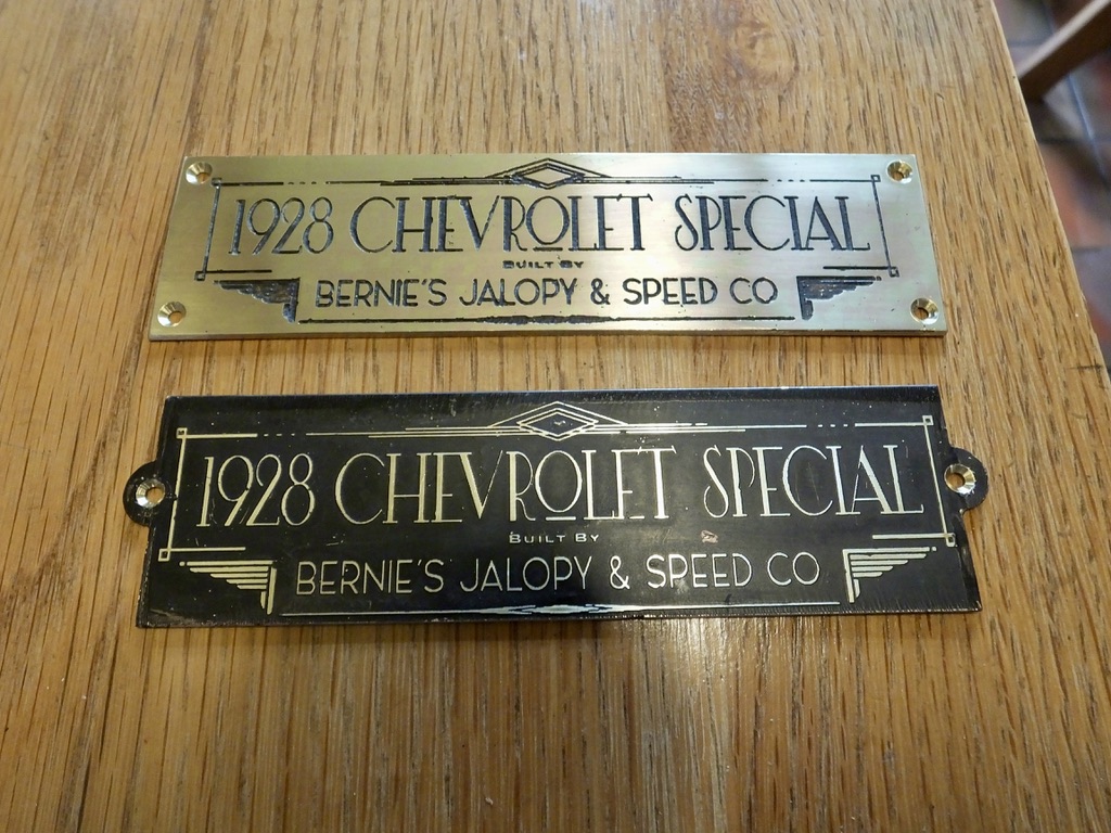

First try putting the resist on the big one.
Disappointed, that one came out a bit rough, and then I stupidly left the inverse one in the acid too long and it lost definition and went a bit ragged.

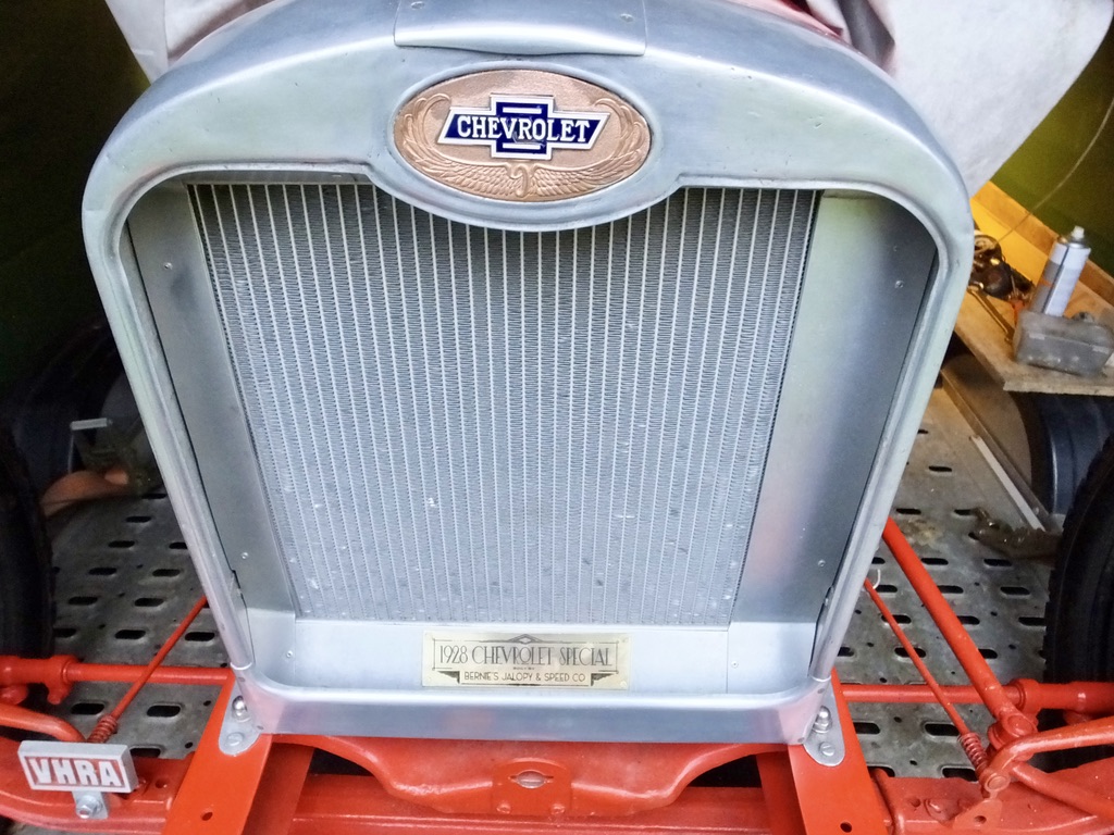

But I decided I was being a bit of a perfectionist, so gave up and fitted them, they look fine in place, look old a bit battered, just right!
