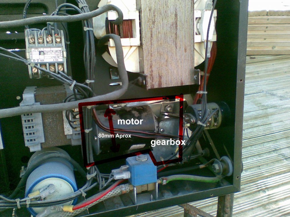

Came with euro factory fitted. It's now my backup machine but I did not get any issues with feed as you seam to be getting. Have you checked for any play in the pivot pin on the top roller ? For a home use machine I would think it unlikely that the roller has worn. Does the top roller (roller bearing) spin freely? Is the bottom roller (inc groove) clean rust free and free of oil ?

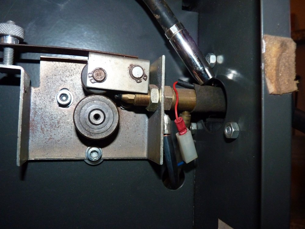

I spotted a roller for a Clarke machine on @weldequip's site and the dimensions matched so I ordered one. Just tried to fit it on tonight and the bore on the hole in the new one is too small so I need to widen it. I've put the vernier on it and currently it's 9mm but needs to be 10mm. My question is how should I approach it?
I've no access to a lathe or any machinery more complicated than a cordless drill. I do have an extremely cheap and crap SIP pillar drill (a whole 280W of muscle, wow!) My normal way to do this would be to just send a 10mm HSS bit through it but I'd thought of using a hand reamer but that's not a tool I'm familiar with. Is a reamer suitable for this or am I trying to take too much off in one go?
Hmm hadn't considered that the gearbox and motor could need a service. It turns with plenty torque but sort of "grinds" the wire in the groove rather than moving it along, if you see what I mean?Another possibility might be as per post 7 on this link http://www.mig-welding.co.uk/forum/threads/sip-p170p-wirefeed-birdnest-issue.49398/
Yet more maybe take out the brushes on the motor and using a blast of air blow into the brush housing. You will be surprised how much carbon dust will come out. Then give the brushes a wipe with a clean tissue and make sure they slide easy when they go back in.The machines I work on have slightly smaller gearboxed motors (24v) 17 per machine. We do sometimes clean out the dust but if at all sus we replace. Note that even though the roller may run at say 20 to 50 rpms the motor may well run at 2000 to 3000 rpm hence the brush ware.
Really? That does surprise me if correct. If you look across the top of the roller (along the groove) while upto a light source (window even) then it should be noticeable the difference between 0.6 and 0.8. If you set the pressure roller down with light pressure onto the orignal roller then try a feeler gauge between the two rollers (say 5 thou) at the front and back to see if the two rollers are parallel with each other. If ok then remove the pressure roller inc it's bracket, run the feed roller on a high speed with some wet and dry to clean it up shiny. Then running it at a slow speed look for run out, where the roller appears to be going up and down. If the motor/gearbox bush/bearing is worn this will show it, even a small amount will show by eye.New roller is marked which is super helpful having something to compare to.
I've done a wee impression using bluetack and the old roller has two 0.8mm grooves.
What size wire are you using ?Hmm hadn't considered that the gearbox and motor could need a service. It turns with plenty torque but sort of "grinds" the wire in the groove rather than moving it along, if you see what I mean?
No not done it as it's not that kind of unit. It's much sturdier in construction; like a pre-cost saving unit. Here's a picture of it before I converted to a euro torch:
This is a pic of the motor in my Clerke 120 much the same! but don't have a pic of the roller asy will take one next chance I get.Hmm hadn't considered that the gearbox and motor could need a service. It turns with plenty torque but sort of "grinds" the wire in the groove rather than moving it along, if you see what I mean?
0.8mm, just a small hobby reel.What size wire are you using ?
TBH I don't have the best light source beside me right now so I could be wrong on that (hear hooves think horses not zebras). I'll check again tomorrow when I've got better light to work by.Really? That does surprise me if correct. If you look across the top of the roller (along the groove) while upto a light source (window even) then it should be noticeable the difference between 0.6 and 0.8. If you set the pressure roller down with light pressure onto the orignal roller then try a feeler gauge between the two rollers (say 5 thou) at the front and back to see if the two rollers are parallel with each other. If ok then remove the pressure roller inc it's bracket, run the feed roller on a high speed with some wet and dry to clean it up shiny. Then running it at a slow speed look for run out, where the roller appears to be going up and down. If the motor/gearbox bush/bearing is worn this will show it, even a small amount will show by eye.
Yeah I think it's about 1990. I shall have a gander inside it tomorrow when I try Mike's fixes and I'll report back.Oh wow - that is a lot more sturdy looking. Any idea what vintage your unit is?
