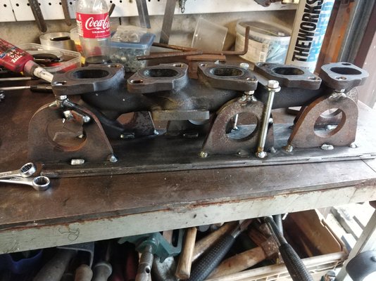

Had mine blow twice, then got it refaced then I dewebbed it and it was fine for years until I sold the car, always thought a 5 pot one piece manifold was idiotic.Engineering shop advised against that, said they often warp again and worse
I had mine skimmed, new turbo and did 30k without issue, not dewebbed
Problem is if you make any exhaust manifold more than one piece, any joints will end up leaking.
