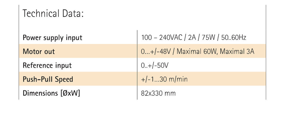

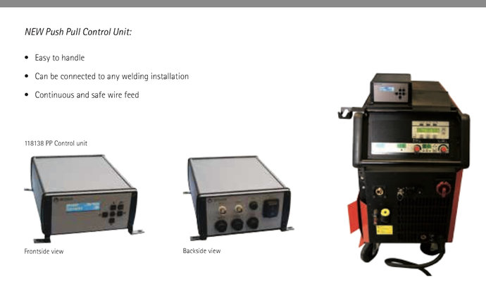

Can anyone think of a reason this is not working when the Binzel push/pull works faultlessly?
The only two reasons I can think of are
1. The binzels wire pull is weak, it won't even pull the wire out the torch at the end of the reel. So because of this it doesn't really need good synchronisation as it is only really acting to keep the tension on the wire from the main feed rollers.
2. The problem is the pushing of the wire after the nano feeder, it is being pushed 3 or 4m. The feeders vary the feedrate but you get a slight bending/pulling back on the wire and thus the EWM is over compensating in a similar fashion as you would see in a badly tuned servo system on a CNC machine.
Unlikely to get a chance in the next couple of days to try anything else out as the weather is supposed to be better and I need to try and catch up with some welding. When I do get a chance I will try and slacken off the feed pressure in the nano drive to try and mimic the pull pressure of the Binzel Push/Pull and see if that makes any difference.
